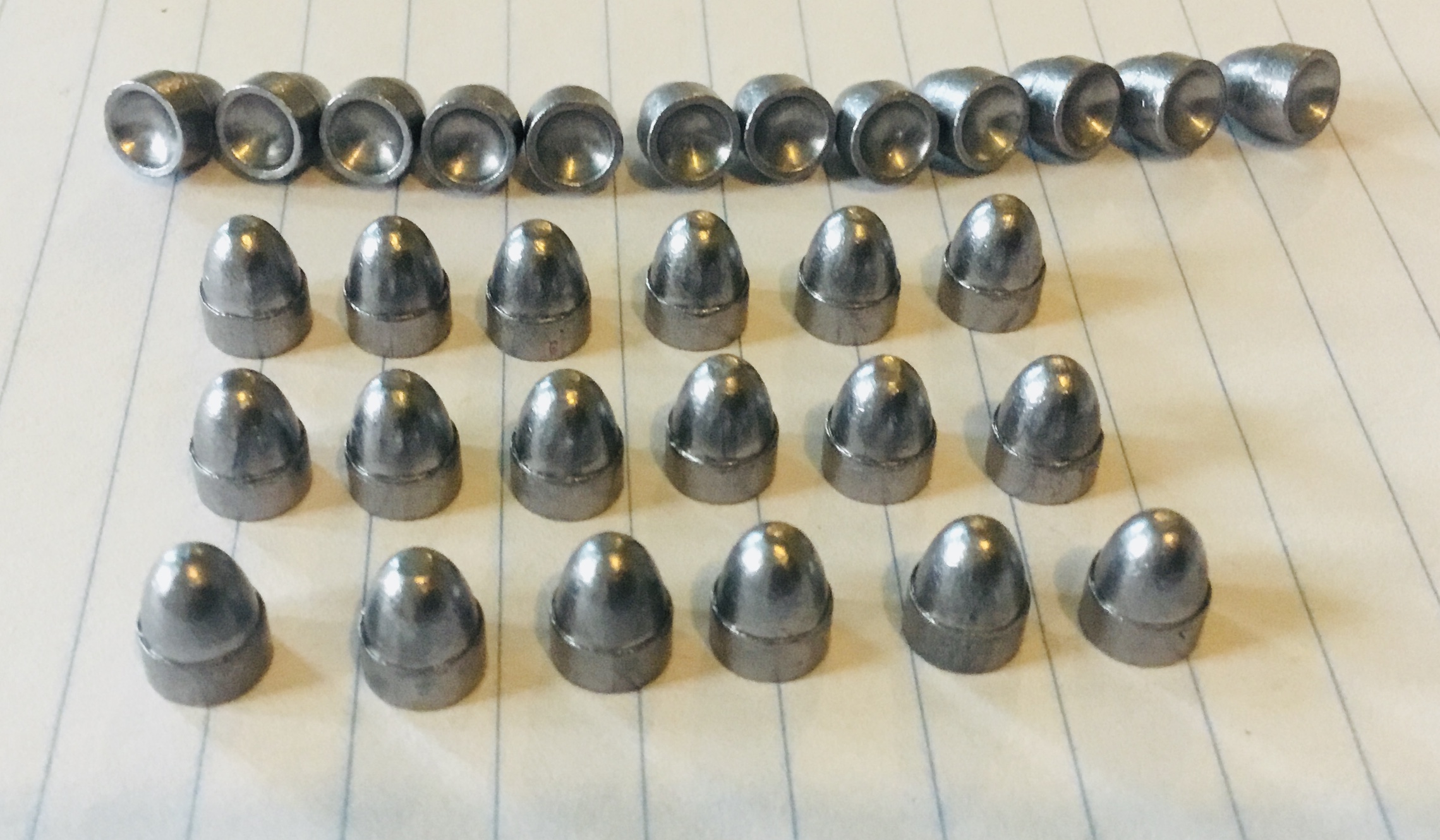

Really interested in those HBT slugs… I can already tell you at stock settings those will have the best speed by far. I’ve resisted trying any because I feel like 26gr is just a little light but I did order some 28gr Franco’s to get close. I’m not even gonna touch the reg. Just gonna toss them in and see how they shoot a 980/985fps.Yeah let’s all just share whatever data we get so we can get these things figured out in short order.I’ll do a couple groups of five different variations of .249 &.250 slugs i pulled for this round of testing.Then i’ll turn up the reg to 2500 (slug pressure) and repeat for comparison.I’ll start with the brands below.View attachment 565754

Sounds good. I was thinking of those AEA how they would do gotta get some. Let me know. Thank you.Yeah let’s all just share whatever data we get so we can get these things figured out in short order.I’ll do a couple groups of five different variations of .249 &.250 slugs i pulled for this round of testing.Then i’ll turn up the reg to 2500 (slug pressure) and repeat for comparison.I’ll start with the brands
