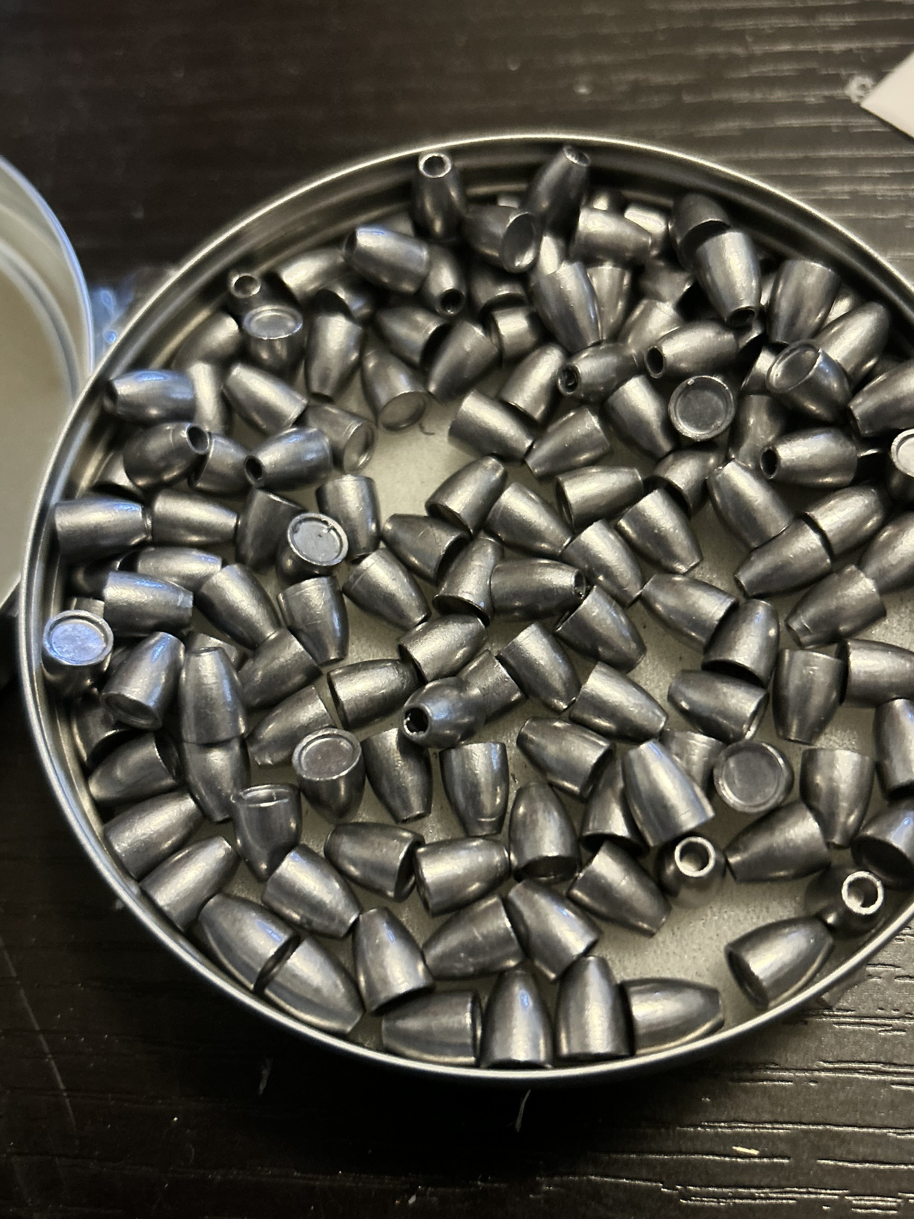

These are cup base. The bottom is flat with that lip like cup. The dish shape is like a lens across the back and no lip.

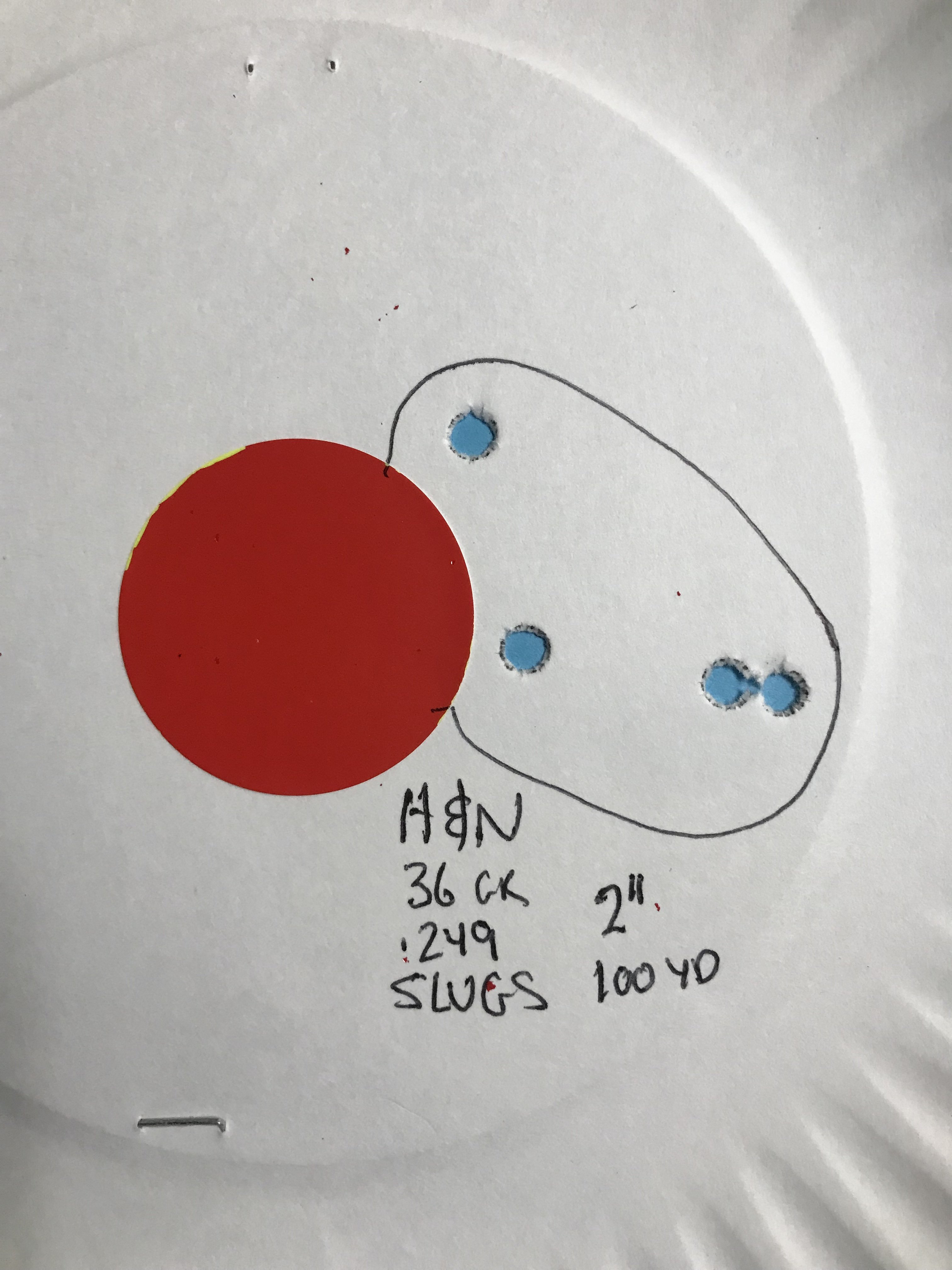

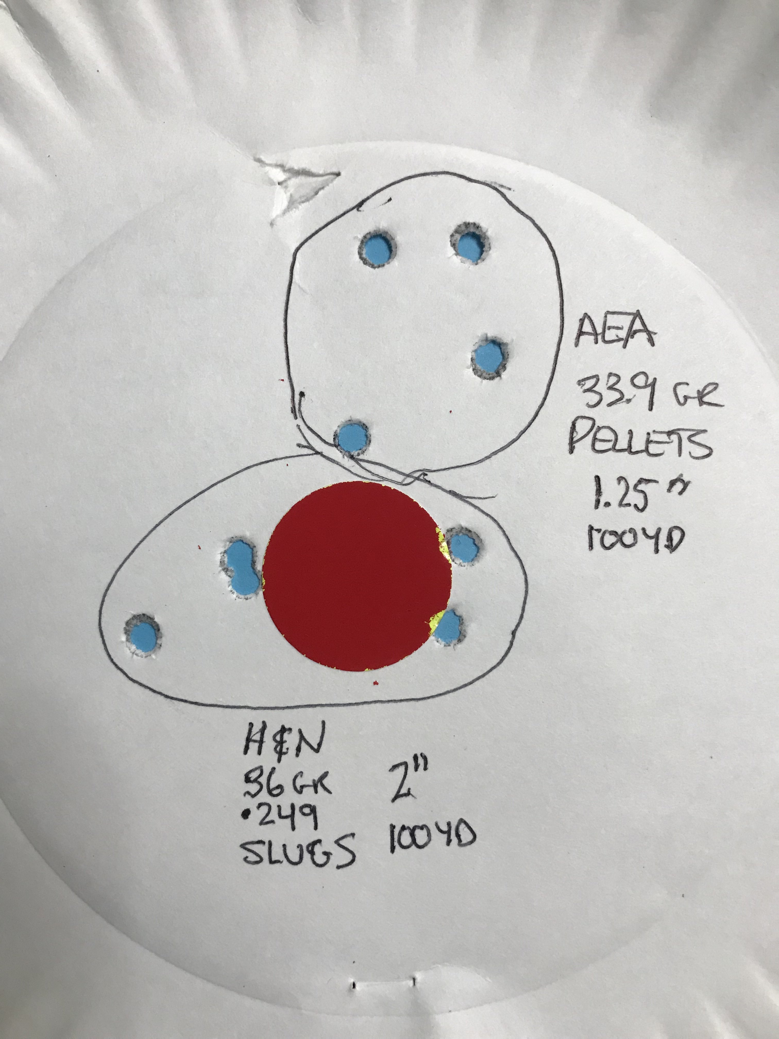

Just took out my .25 250z for the first time.Fairly impressed with it out of the box.2 shot zero at 30yd.Shot pretty flat out to 50yds not too much of a drop,put a couple right next to each other there.Had about a 14” drop from 50 to 100yds so made the adjustments (up til this point using AEA 33.9gr pellets).So at 100yds i shot 1 group of AEA 34gr pellets and 2 groups with H&N .249 36gr slugs before it started to rain a little.Surprisingly despite the wind kicking up a little the pellets still outperformed the slugs with a 1.5 inch group vs a couple 2” groups with the .249 slugs.Then i put 8 shots in a row on our 3” steel hangers and called it a day.Pretty impressed straight out of the box,no reg/hammer spring tuning or moderator which is supposed to tighten 100yd groups right up.

For the slugs you’re gonna wanna put the reg around 2500/2600psi. Hammer spring will tighten the groups right up. The 36gr will hold great groups at range but hunting I get a lot of pass throughs at range. I have much better results with slugs around 30-31gr… get them going around 950 and you’ll see what I mean… I hit a squirrel at 125y today and my drop was only like 3mildot so like 10.5” right?

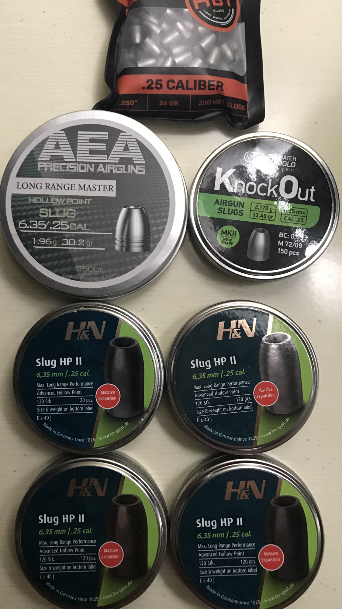

Yeah let’s all just share whatever data we get so we can get these things figured out in short order.I’ll do a couple groups of five different variations of .249 &.250 slugs i pulled for this round of testing.Then i’ll turn up the reg to 2500 (slug pressure) and repeat for comparison.I’ll start with the brands below.
