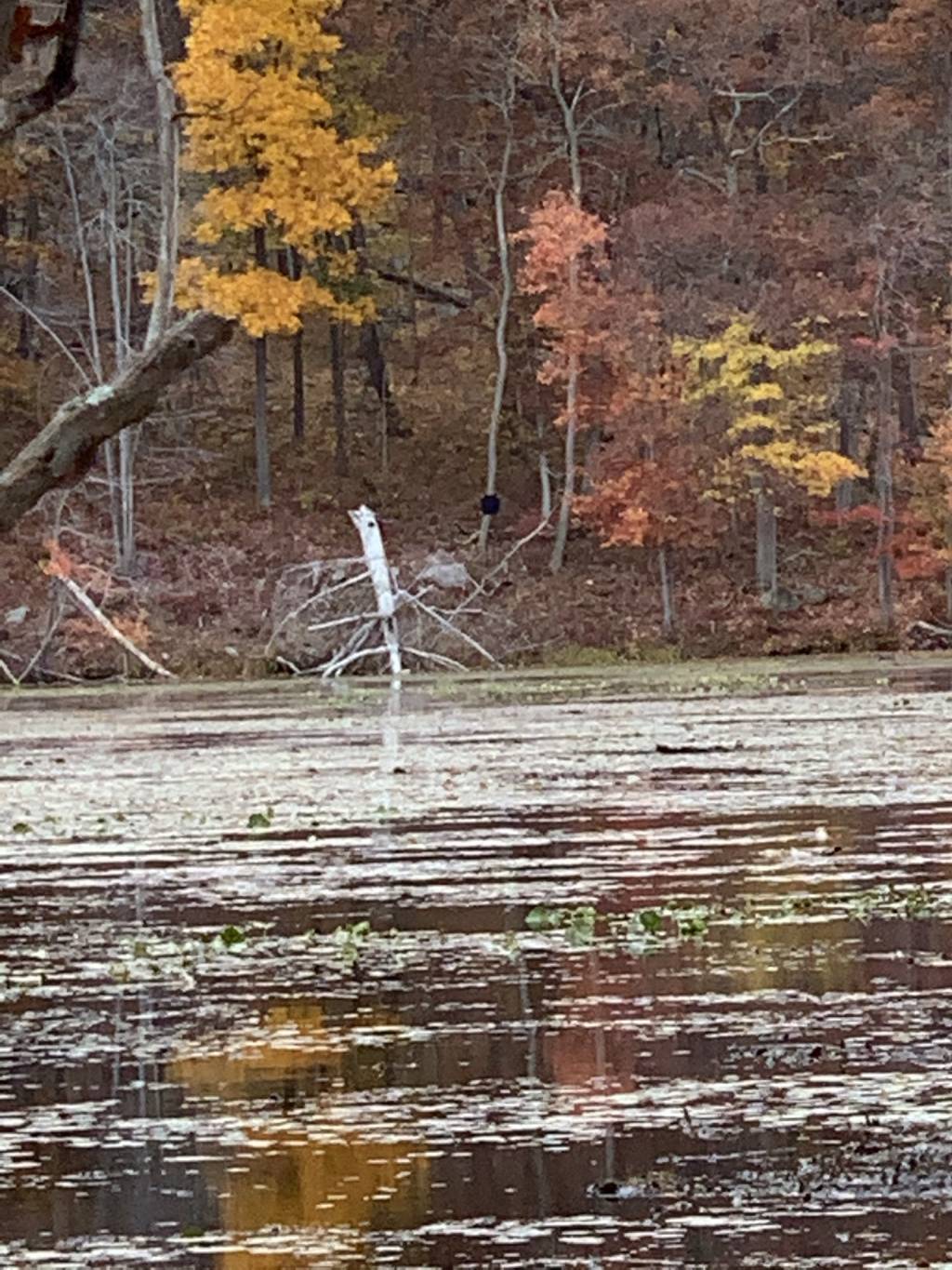

I enjoy shooting long distance, it’s always been what draws me to shooting. I spend most of my time shooting at 100 yards. I’m lucky enough to have targets in my yard at 25, 50, 75 and a lot of targets at 100 yards. I can shift my shooting table about 20 feet and I can stretch from 205 - 240 yards. Always liked that I could consistently hit targets over 200 yards. I’ve gotten groups of 6” at 240 yards with pellets. Found a way to set a steel plate out at 310 yards, tried some slugs and wow. They buck the wind so much better than pellets and now I can’t stop shooting them. Making another steel plate to put at 350 yards. This could be the beginning of a slug (distance) addiction. Is there a group here on the forum to help give up slugs and shoot pellets again.
I can go to the right of this shot and stretch to 350 yards. Past 350 yards I’m going to need to buy a cold shot mount. At 350, I’m out of scope and tricks to make it work.
