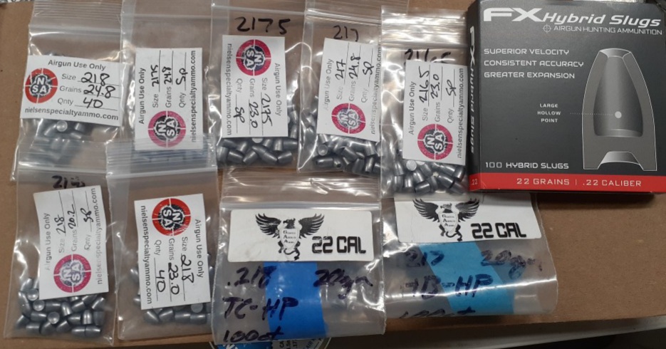

I definitely suggest ordering a bunch of different sizes and weights to see what your barrel likes best.
My hatsan BT65SB QE prefers the .218" 24.8gr NSA's.
