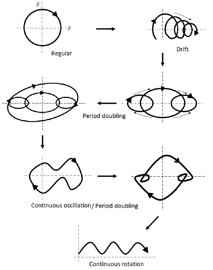

EDIT: if it was mentioned earlier I musta missed it... The way I understand it is from the powder burner world, VERY long range shooting... The trajectory of the "cone" is a constant and can be plotted and corrected for, if I remember correctly, rifling (twist rate, # of lands and grooves), distance and speed and projectiles (shape and weight) are the variables... The demonstration is this, center line of the bore, paper targets off axis at different distances and the round goes through all the paper targets demonstrating the cone... Just like in football spiral the cone gets smaller... I hope that made sense...

when the slug is in "wobbling stage" it might look inaccurate on close range target, but is following the same path ... is not more accurate at long distances, is "unwobbled" (so the mark will be more precise?)
Now I wonder more concentric slugs will remove the wobble? and that will make them even more precise? do all slugs wobble?

Its been scientifically proven that while epicyclic swerve (which is being described above in the page 2 posts as a different name) exists, it does not affect the flight path of the projectile a significant amount.

in 30 yards the slug is wobbling so the mark on the paper will not be slug on slug, if you shoot 10 shots, the mark might look like 1 inch since the slug is not entering straight, and in 100 y might look sub moa, since is entering straighter into the paper, so the conclusion for some is that is more accurate at longer distance when is not, is a visual effect due the epicyclic swerve.
