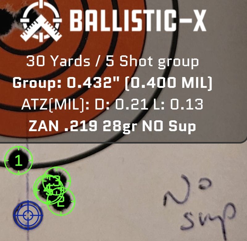

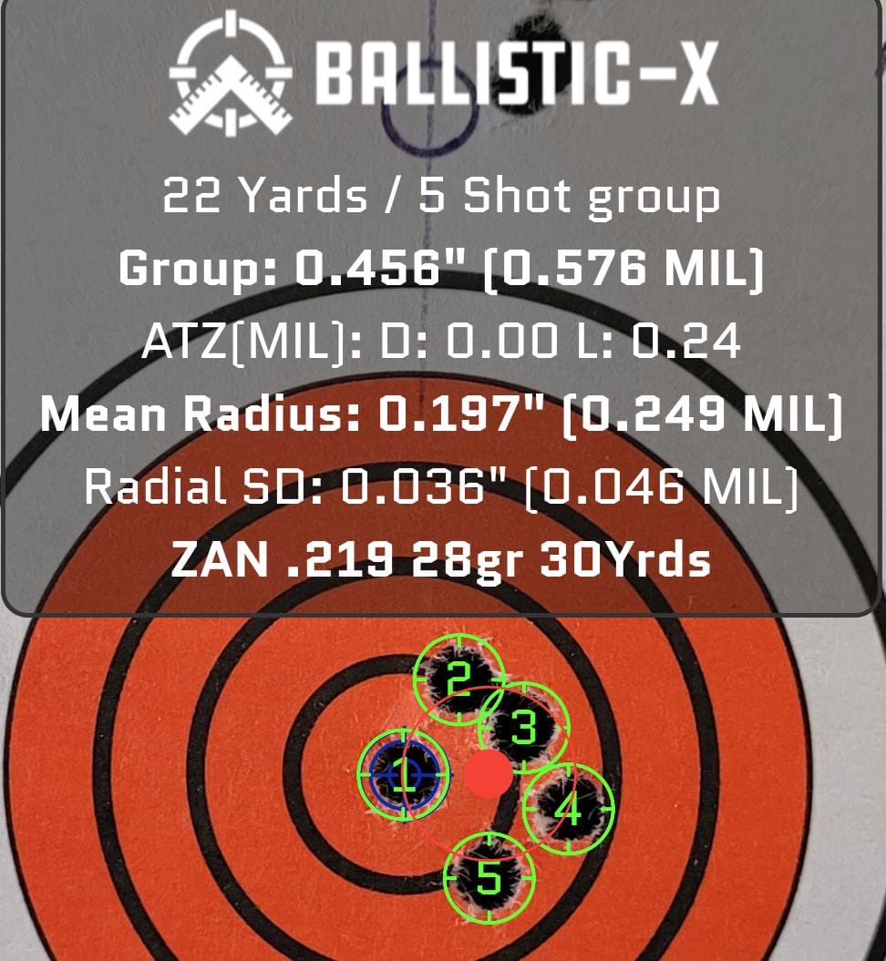

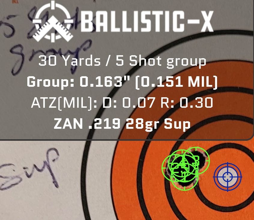

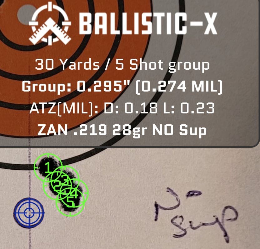

Any one have any idea why the slugs act like that? i couldn't pin point the problem and start loosing faith in my gun! its not fun any more!
every time i shoot, i would have decent groups then an amazing group then hell break loose! i really need help or an explanation! thanks

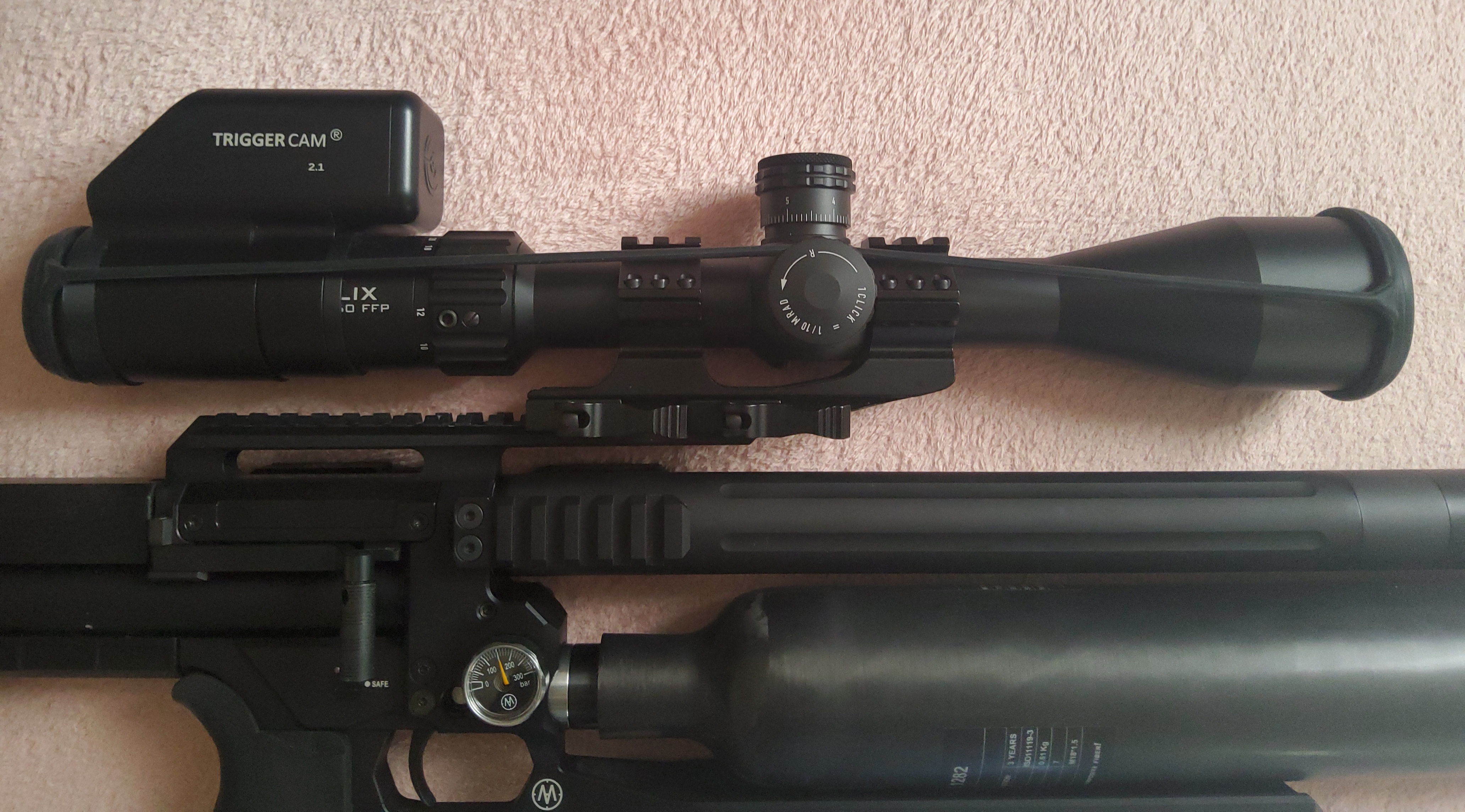

That looks like something is loose in the rings or mount or a broken scope.
I was thinking about that! since the scope is mounted on a bridge with two fastenning screws. it might get a shock effect when shoothing and that may threw the aim a little bit or barrel/shroud harmonic issues! 🤷‍♂️
BTW, i'm using Element helix 6-40x50 with quick release rings.
