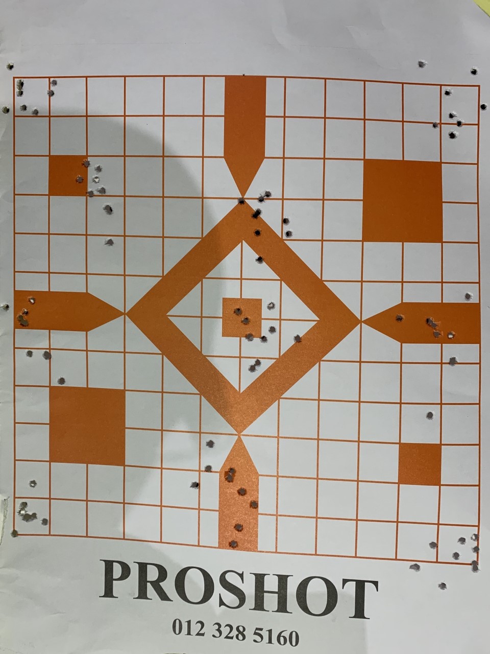

Here are a few 9 shot 100-yard sighting in groups of the.22 21g .218 H&N Slug HP, bottom right and left 1-inch squares are where I stopped tuning, 933FPS, 120 bar, hammer 5, valve stop 3, 700mm slugliner, getting 104 shots from 250 to about 117bar. I wasn't convinced at first, but I gotta say that I can live with those flyers! At my 30m zero Its one ragged hole.
