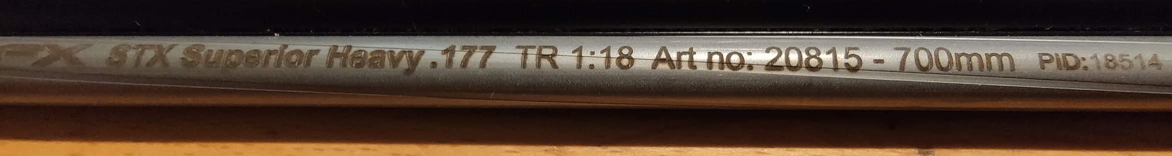

it is 1:18.
I can not recall what my regular superior liner are, but it is not very far from this,,,,,,, which i find counter intuitive,,,,,,, if i can not shoot heavy stuff better i will be soo let down, and might even turn into a FX hater,,,,,, CUZ upon first getting my 600 mm Maverick i had a lot of problems with it, not really wanting to shoot anything well at speed, aside for the beast pellets which it did fine with, but monster redesign i really wanted to shoot, those i had to shoot slower then 600 FPS to get them to group well.

putting my standard 600 mm superior barren next to this heavy barrel, and the lines on the outside are pretty much the same.
FX 177 barrels have been 1:18 for a very long time. Maybe call FX and ask them? I would return it if I were you.
1:18 is barely enough for the 12.5 grain NSA and 13 grain knockout, even 15 grain needs about 1:14 twist and the 20 grain needs 1:12 maybe even 1:11.

it was my understanding that heavy barrels would not be choked, but i am now inclined to think that these barrels have been mixed up.

CUZ a 1:18 pitch do not sound very heavy to me, that sound more like regular pitch

Looking here it look like it is a regular superior barrel i have, with heavy lasered onto it ( 1:18 twist rate )
fx-twist-rates-1637380297-jpg.181443
.22 cal heavy look to be 1:16 so i would assume a .177 should be eve more 1:14 maybe ???
I would also assume comparing a 1:18 barrel to a 1:16 or 1:14 side by side on a table it would be easy to see a difference in twist rate.
I really think there have been a mix up at FX at the laser engraving machine ( comparing the heavy barrel to my 1 year old superior barrel ) it look the same twist rate.
Almost willing to bet FX have a bunch of superior branded barrels with heavy twist rates at the factory or going out to customers / retailers.
ATM i feel very unsure and would advise extreme caution to any potential buyers of .177 barrels ( well heavy barrels at least )
