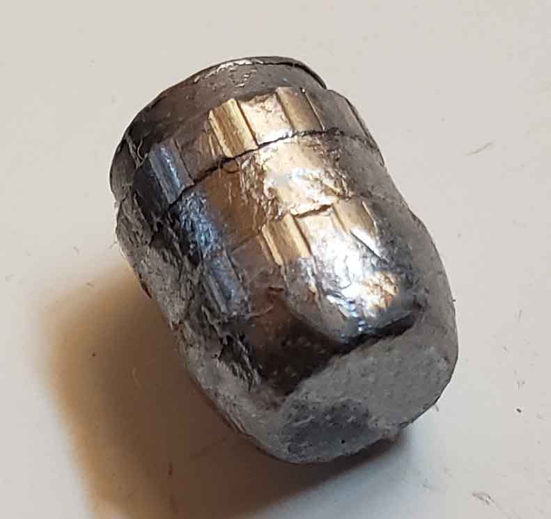

I just snagged a new Gauntlet 30 for a price too low to pass up, wanting to give 30 cal slug shooting a try at the lowest entry price for a decent gun. I know nothing about shooting cast slugs in airguns, so I come to the forum for some advice.
It seems to be a good (and LOUD!!!
) shooter with commercial cast slugs right out of the box. My intent is to shoot my own cast slugs from the fairly new 55gr hollow point NOE mold that I ordered. I slugged the barrel today and the grooves which are directly opposite each other which makes measuring easier. They are consistently at .299 to .300 on more than one slug run through it. I will try shooting the NOE 55 gr straight out of the mold, but may want to try different sizing dies as well. What would be the most likely to try first on this gun as well as for future 30 cals? I would be buying 2 dies for sure, probably three.
