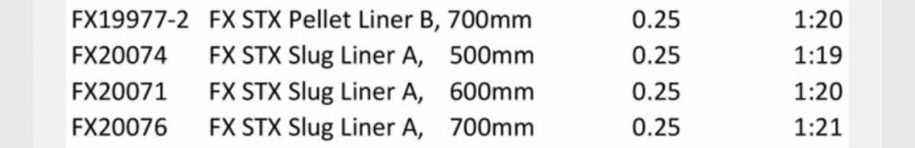

What I've found is the liners are .245 thats way to tight for the size of available slugs.
