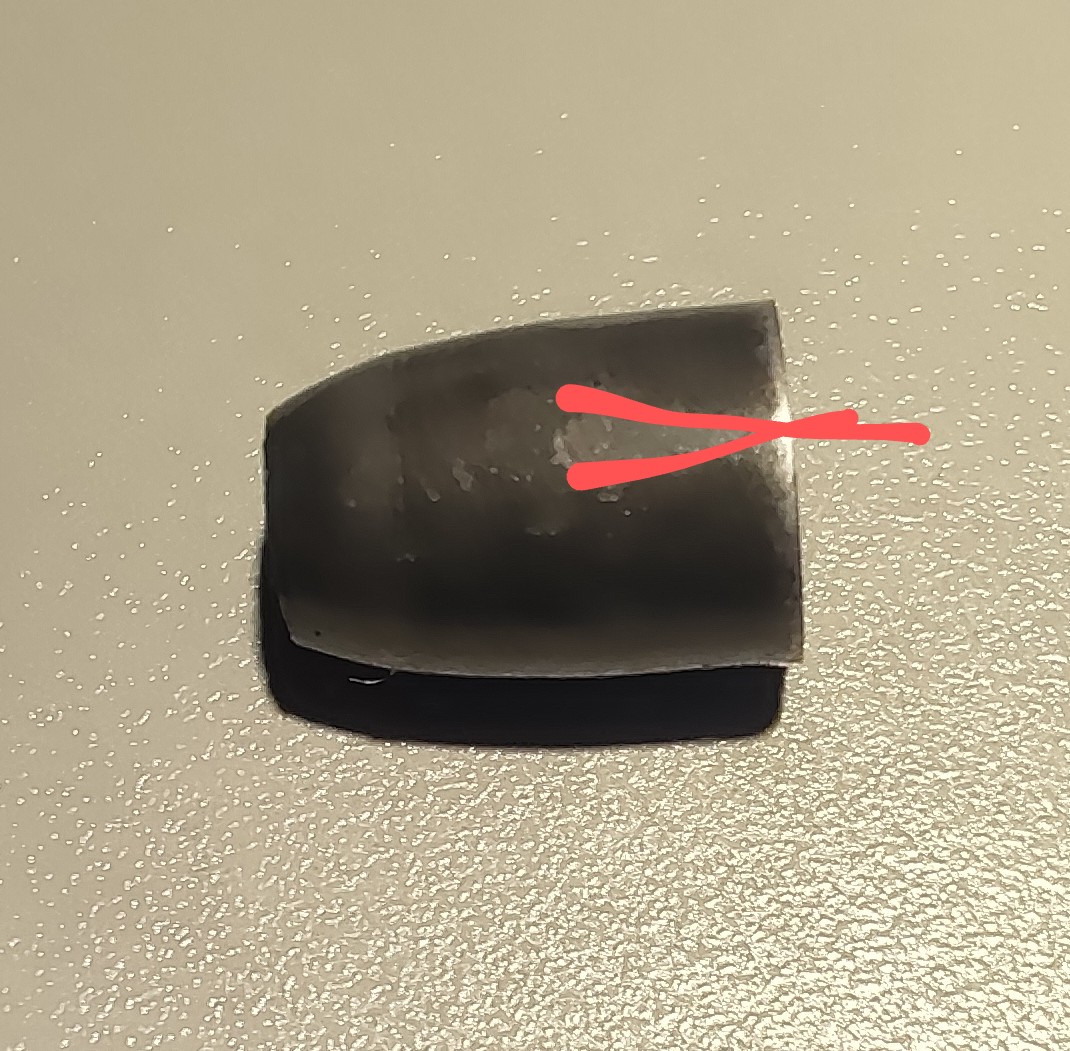

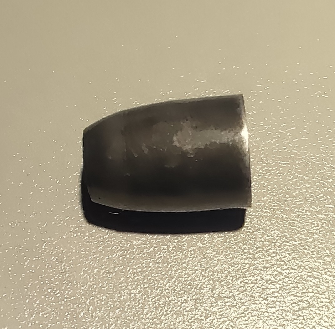

Guys, why not doing a very gradual leade so that just a tiny bit of a slug after chambering is in the full rifling but still the rest of it is also kept by the tapered rifling? Like below.
I don't think there is anything better than that.
