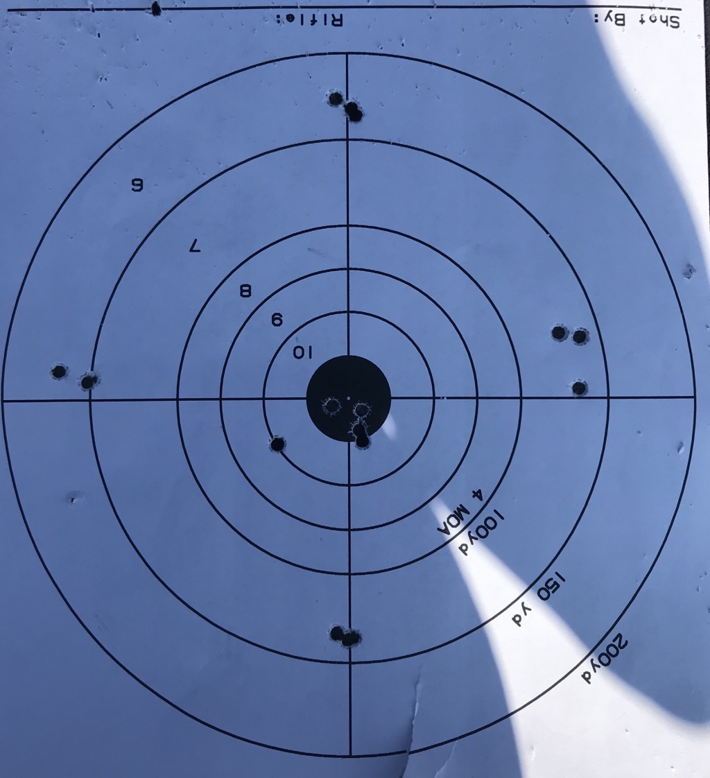

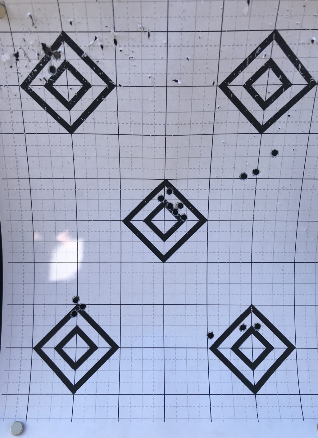

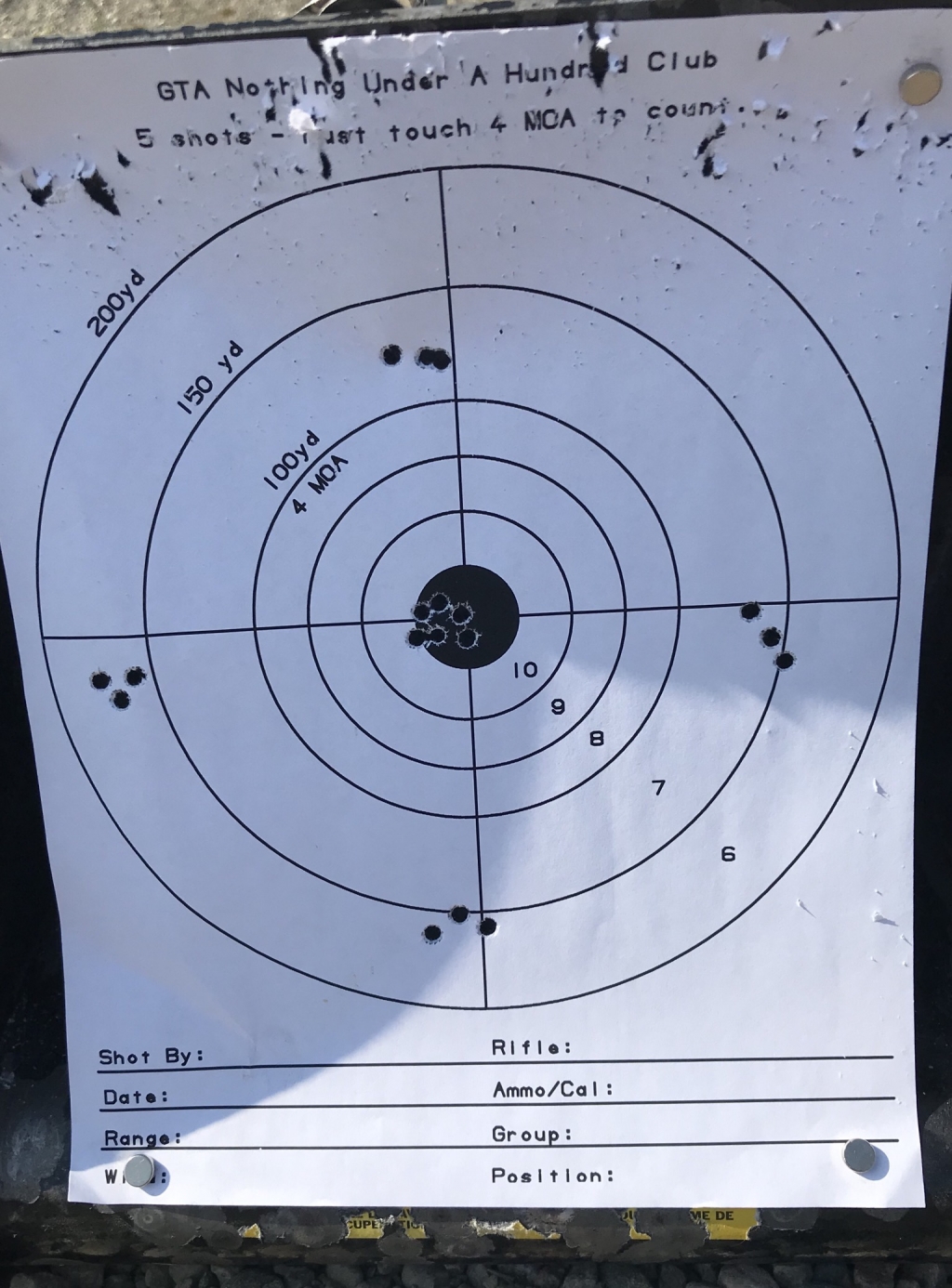

Here are some targets at 80 yards in .22 cal with some cast bullets from an NOE 225-39 FNGC mold . They were shot today from an Evanix K550 at about 880 FPS . At 30 yards and under they shoot just as well as any pellet I’ve tried from the same rifle . One hole ten shots . The trick is getting the balance between the bullet and rifle , that is something the FX Impact excels at . Just keep turning dials until the groups shrink . Most other rifles don’t have that luxury so it becomes tedious to find an accurate bullet .
I’m using a 40:1 mix from rotometals and started lubing with FP10. Great lube and can go hundreds of shots using it between cleaning the barrel. For cleaning I just run a few dry patches on a trimmer line until they come out clean which is usually less than 5 patches . I’ll be testing a shortened version of the same bullet soon in the Impact with the slug and pellet liner as well as Redmans barrel liner in .223”.
