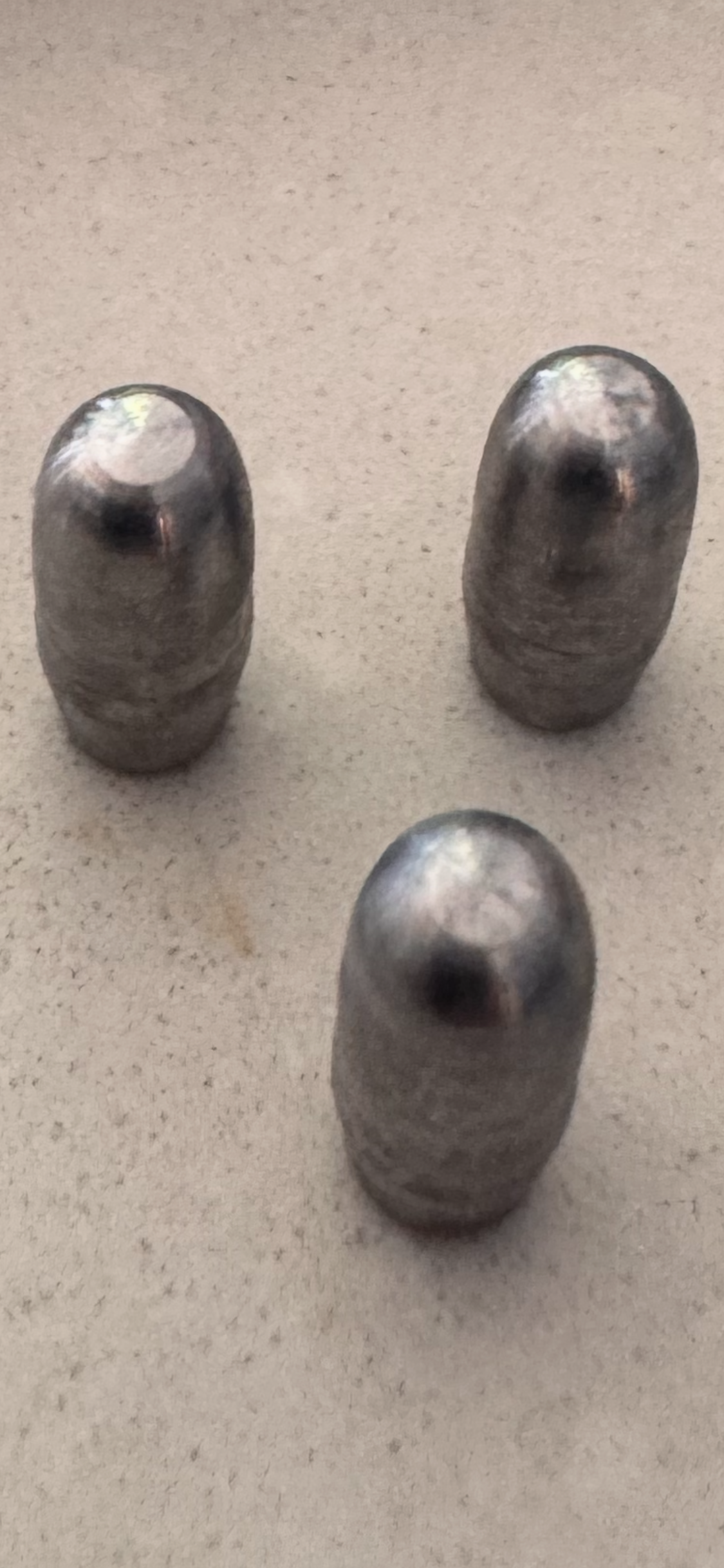

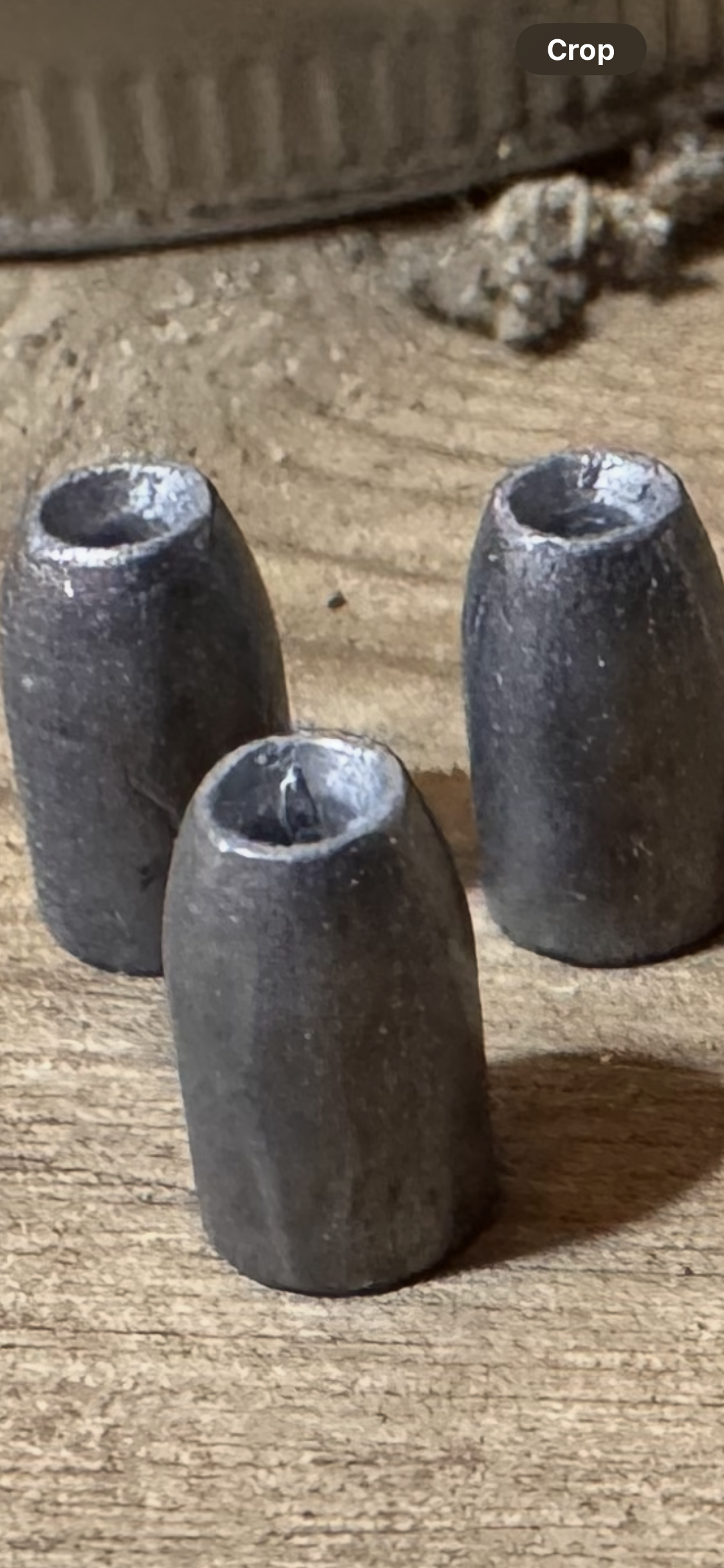

So I was thinking. I just got some Altaros slugs and the uniformity is beyond anything I’ve seen with standard pellets and slugs. So this got me thinking. I’m wondering if part of the reason they are accurate is that they are uniform and don’t have any surface defects to swing them off course. (Super high BC aside)
Notice all the weird artifacts inside the hollow point and rough / uneven nose on the standard slugs.

Yea I was very impressed too, same thing. Ive been shooting .25 altoros queens for almost 2 months now and they are nothing shy of phenomenal. Cnc machined to perfection and seperated into foam. They are truly flawless on arrival. They shoot very consistent. They are pricey but you get what you pay for.

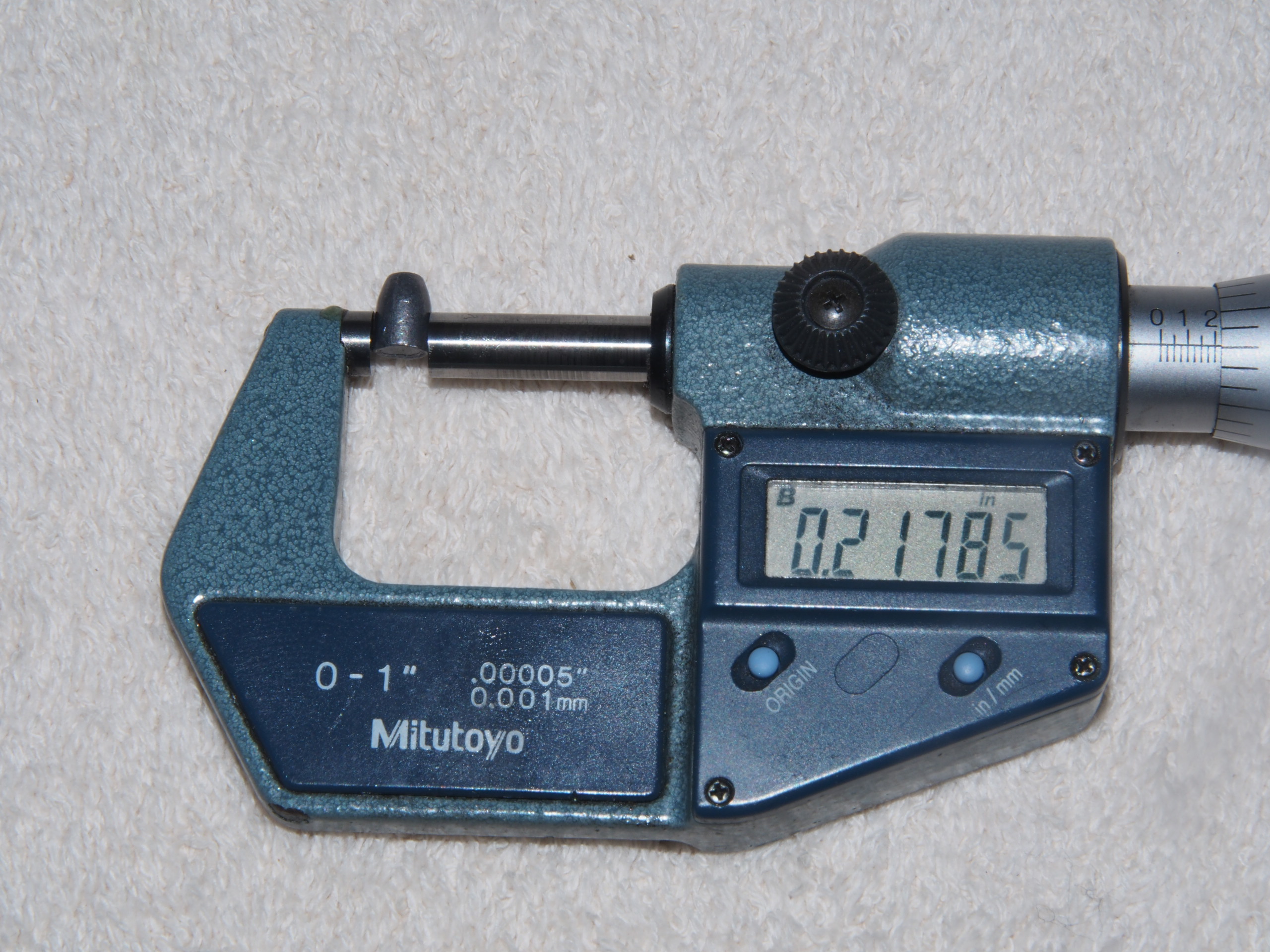

@CanMike and @Dstrac: I'm pretty new to airguns, so I con't have much experience with different brands. I have some .22 HAWKi Thunder 25.3 gn pellets, very uniform and accurate. They are at 0.214 at the nose and 0.225 at the skirt. I just received some Apolo 25 gn slugs, very uniform but run 0.217/0.218 in diameter. I haven't shot them yet as I am waiting for a scope and don't want to sight the rifle in twice. However, I don't understand how being so undersized, they will fly true(?).

i think uniformity plays a role. i used to shoot 17.5gr nsa slugs out of the notos with great accuracy. then i got a bad batch of them there were excess lead on the tips and inside the cavity. these were all over the place. apolo slugs we the only slugs that jammed up my huben k1. they shot okay for looking the way they did but i stopped shooting them after it jammed my gun.

Are you sure you haven't mis-stated the units. 1 micron= 0.00003937in., so 5 microns =0.00019685in. (maybe 50 microns?) I doubt anyone molds to those tolerances, or sizes the slugs or pellets afterwards. The .22 sizer I have is 0.2245; I have to push the HAWKi pellets through, but the Apolo pellets just fall through; That's why I'm "wondering" how the Apolos will shoot. Soon to find out!

Maybe, depends on the tension on the spindle. Ok I'm being a bit of an ass, did precision grinding for 35 years. Does it really matter to pellets and slugs, I tend to doubt it if a few .0001" matter much, most barrels aren't that close...yet.
From some of my research, pellets and slugs are made to +- .001, so I doubt anybody needs a micrometer like the one pictured; I was just being a pain. I've had and used that mic for many years before retiring.
We didn't have digitals way back when, I used Etalons, and Etalon dial mics that we'd set with gage blocks.
Before they came up with the slip-clutch adjustment on the barrel of the mics, 10 people taking readings with the same mics would come up with 10 different results. That was a major improvement along with the tenths vernier. Sill more accuracy than is needed for pellets and slugs, IMO. For real accuracy, I believe they have push-through sizing dies similar to the ones used for powder burner bullets.
