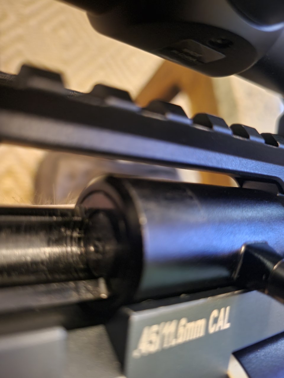

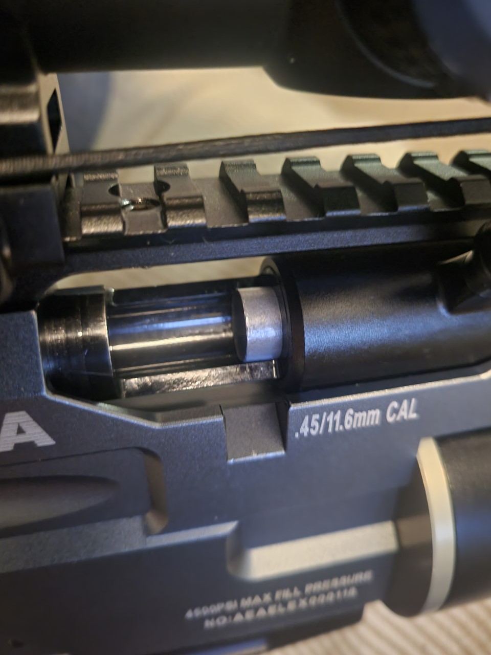

I got a new .45 AEA Element & also got a new package of NSA .457, 240 grain, slugs that won't fit all the way into the gun like they will with my .45 Air Force Texan Carbine. Previously I used .45 Cal, 250 grain slugs from Seneca that will easily go into both guns. Below are pics of both slugs in the AEA. I am able to close the handle down with the an NSA slug inside. Is it safe for me to fire it?

Anyway i feel chambering larger weight slugs are harder than shorter lighter ones, also if the material are different ( harder ) looking at you H&N, it seem to have a say too, though here i have just tried 16 grain H&N slugs, but feel a bit different from 16 grain Zan slugs.
Mind you if you really have problems ( have to use a lot of force ) seating / chambering the round, i would advice you be careful.
AEA had their first batches of Challenger .457 barrel rifling cut way too big, in the .460+ range. It appears that they probably fixed this by making them closer to the nominal .45 caliber sizes. And from that picture, you got a good barrel that needs to be ""slugged" to determine it's true bore diameter. A .457 round ball pushed through there and measured to get a true size would be ideal. Forcing that slug may result in several things going wrong for you and or the gun. There's a lot of air discharged in a .45 caliber that I would not mess around with if not chambering all the way.
