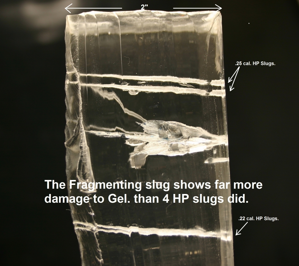

This short slow motion video showings the "Energy Transfer" difference between a standard hollow-point slug and a
fragmenting slug on a small 2" thick Ballistics Gel. block. Shooting a 2" block of 20% NATO Ballistic Gel.
is as close to a Pigeon or Squirrel cadaver as reasonably possible without showing you the real thing.
Shooting a large block of test medium that stops a round completely, isn't an accurate test here.

These tests confirm what the video shows. Fragmenting slugs in 22 or 25 cal. will deliver the available energy
at POI better than a standard hollow-point on these small pests.
Regardless of the test medium the results are always the same.

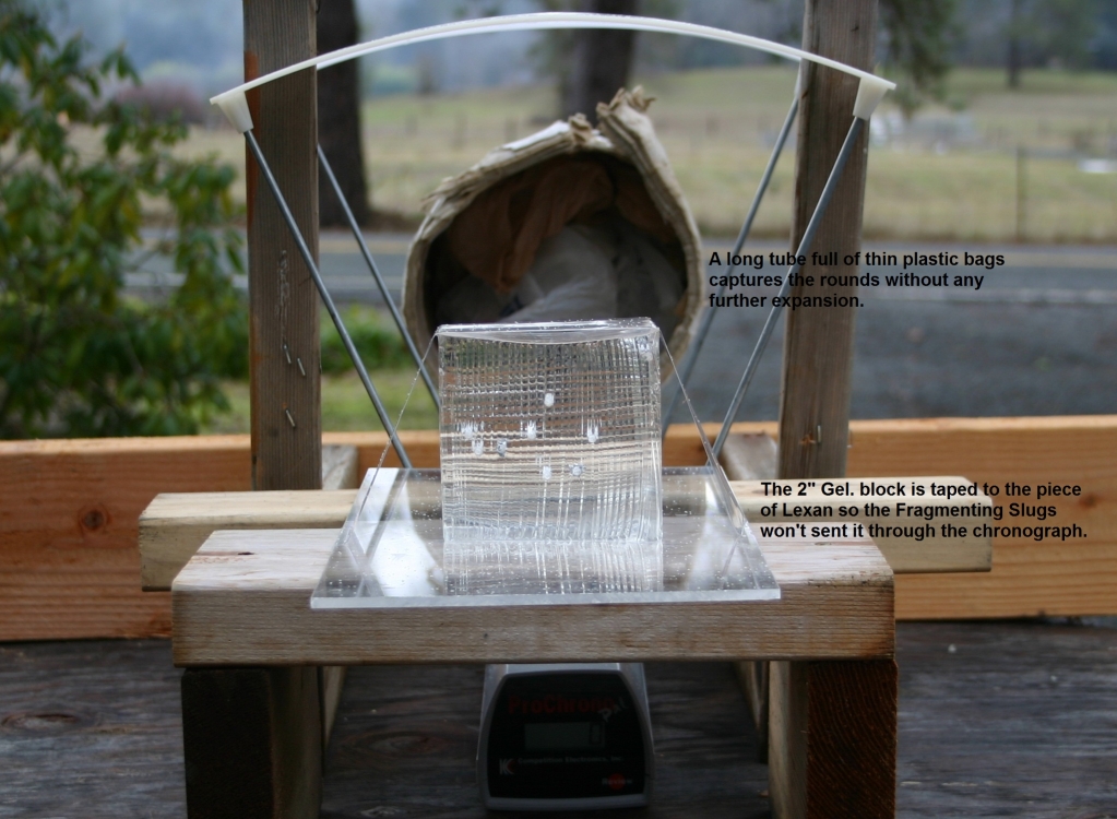

Included here are a few photos and velocities of pass-through slugs that might surprise you.
The Chronograph was placed behind the 2" thick Ballistics Gel. block to see how much
velocity/energy is lost with different types of slugs. Below are those results.
2 Shots ea. showing how much velocity (= energy) remains after pass-through.

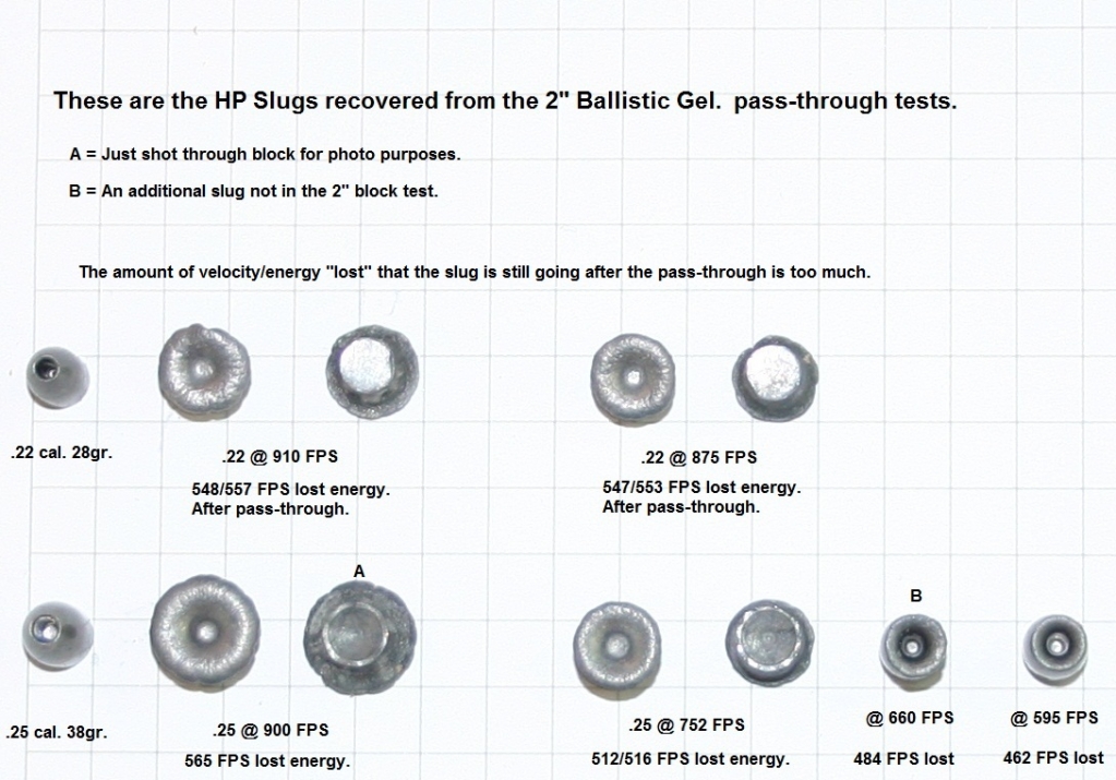

1- .22 cal. 28gr. HP 910 FPS @ POI - 548 FPS after passing-through 2" thick gel. block.
2- - Same - - 557 FPS
3- .22 cal. 28gr. HP 875 FPS @ POI - 547 FPS after passing-through 2" thick gel. block.
4- - Same - - 553 FPS

1- .25 cal. 38.1gr. HP 595 FPS @ POI - 462 FPS after passing-through 2" thick gel. block.
2- - Same - - 457 FPS

3- .25 cal. 38.1gr. HP 752 FPS @ POI - 512 FPS after passing-through 2" thick gel. block.
4- - Same - - 516 FPS

7- .25 cal. 38.1gr. HP 900 FPS @ POI - 565 FPS after passing-through 2" thick gel. block.
8- - Skipped. Not needed. Too much redundancy.

Of coarse I'd recommend a "Standard HP Slug" for a larger animal were more penetration
is required, like a Coyote for example. Common sense dictates matching power/cal. and game size.
But many of us are shooting small "pests", with more pass-through velocity/energy than I'll bet
we were aware of. That's one area were the fragmenting slugs really do excel.
5- .22 cal. 28gr. Frag. 910 FPS @ POI - 000 FPS No pass-through 2" thick gel. block.
6- - Same - - 000 FPS
7- .22 cal. 28gr. Frag. 875 FPS @ POI - 000 FPS No pass-through 2" thick gel. block.
8- - Same - - 000 FPS
3- .25 cal. 38.1gr. Frag. 595 FPS @ POI - 000 FPS No pass-through 2" thick gel. block.
4- - Same - - 000 FPS
5- .25 cal. 38.1gr. Frag. 752 FPS @ POI - 000 FPS No pass-through 2" thick gel. block.
6- - 38.1gr. Different design Frag. - 099 FPS One small piece passed-through.
9- .25 cal. 38.1gr. Frag. 900 FPS @ POI - 000 FPS No pass-through 2" thick gel. block.
10- - Same - - 000 FPS
