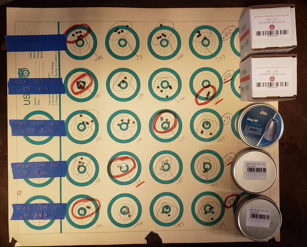

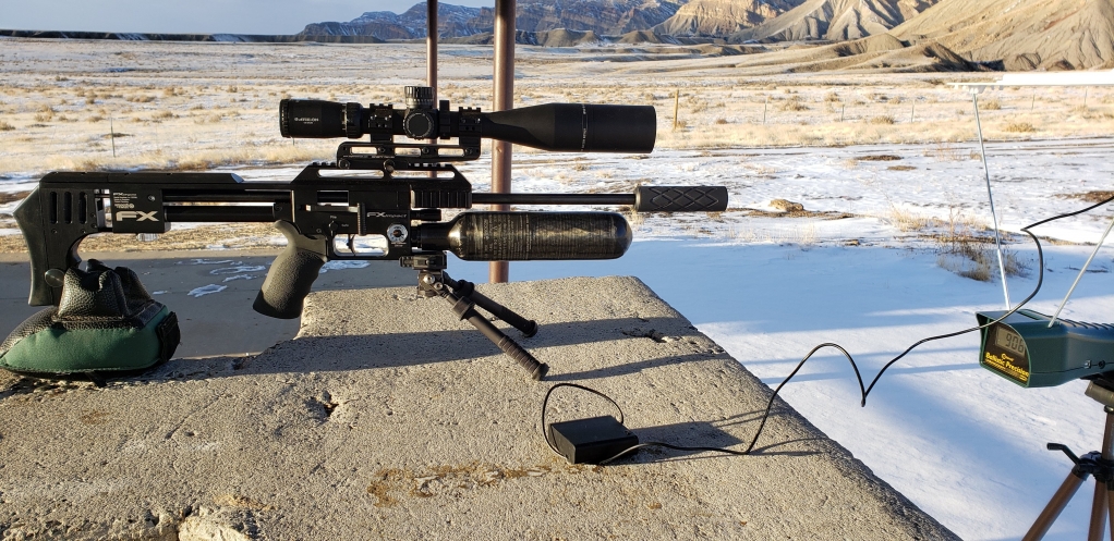

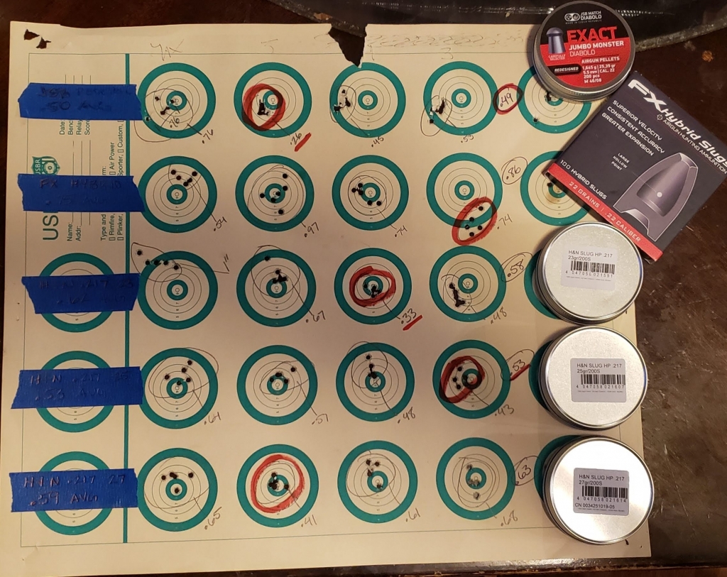

Decided to jump on the slug bandwagon and I’ve been surprised at the results I've been getting out of my Impact and 600mm pellet liner B. Spent a couple hours grouping several different projectiles today. Turns out that several of the new slug designs do very well with this set up.
I shot 4 5-shot groups at 50 yards with each pellet, starting with the power wheel set at max then 5, 4 etc. I don’t consider myself a great shot, it was about 20 degrees outside today but no wind and all of them performed ok... some shot really well.
Best groups :
1 - JSB monster redesigned (.26” CTC) - for reference
2 - FX hybrid slugs (.74” CTC)
3 - H&N slugs .217 23grn (.33” CTC)
4 - H&N slugs .217 25grn (.43” CTC)
5 - H&N slugs .217 27grn (.41” CTC)
6 - NSA .217 20.3grn (44” CTC)
7 - NSA .218 24.8grn (.35” CTC)
8 - H&N slugs .218 23grn (.62” CTC)
9 - H&N slugs .218 25grn (.38” CTC)
10 - H&N slugs .218 27grn (.44” CTC)
All slugs tended to hold tightest between 920 and 960 fps. I gotta say the slugs are performing about as well as any pellet I’ve seen. Anyone else trying slugs in the B liner?

Yes, these groups were all done at the same reg pressure, just over 150 bar (according to the FXguage) At max power I was getting about 940 fps out of the 27 grain slugs. I wanted to see which slug, if any, grouped well out of this barrel. I plan on taking them out to 100 yards next to figure out which one my gun "likes" best then I'll start tuning specificly to that pellet. What's interesting is that all the .218 grain H&N slugs found their sweet spot right arround 920 to 960 FPSt regardless of weigh. So that will be a good place to start.
I did shoot some groups with my A liner with less than stellar results. The A liner is pellet on pellet with the 18 grain JSBs everything else is just all over the place.
