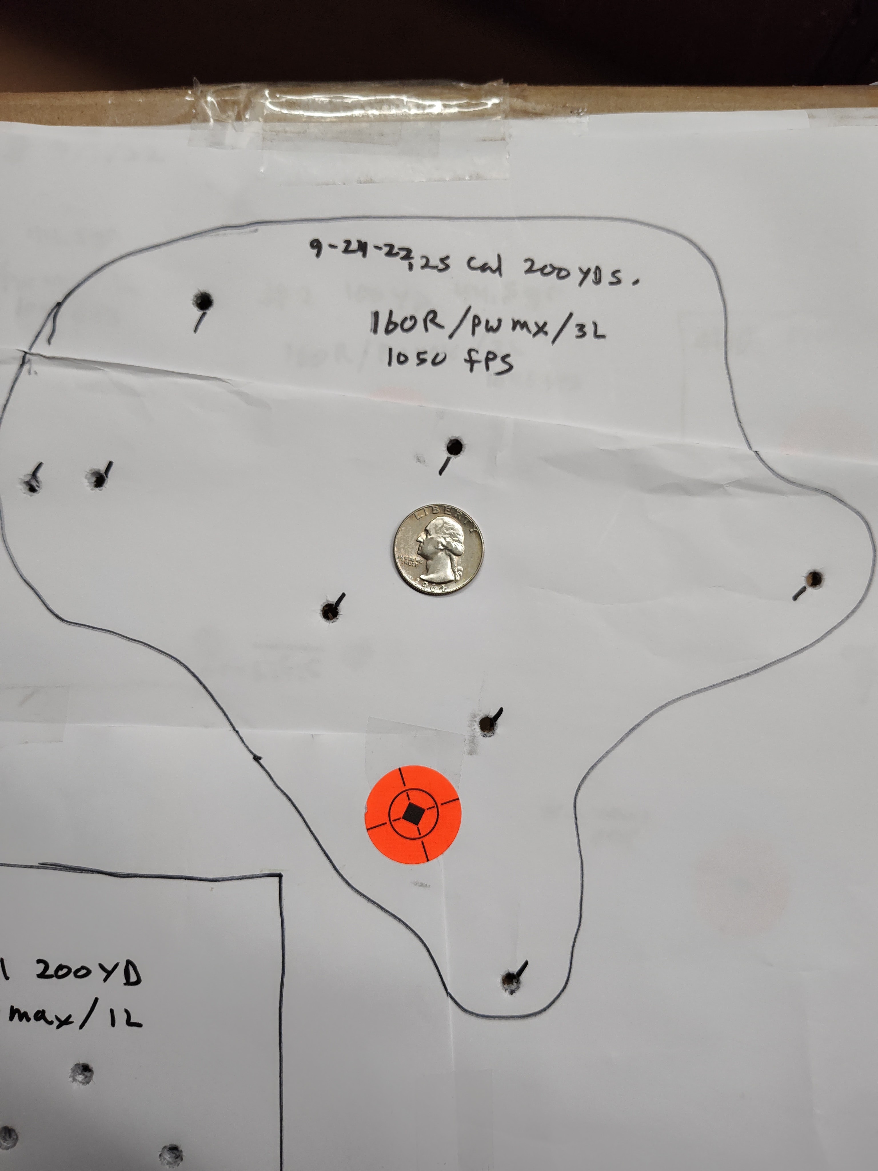

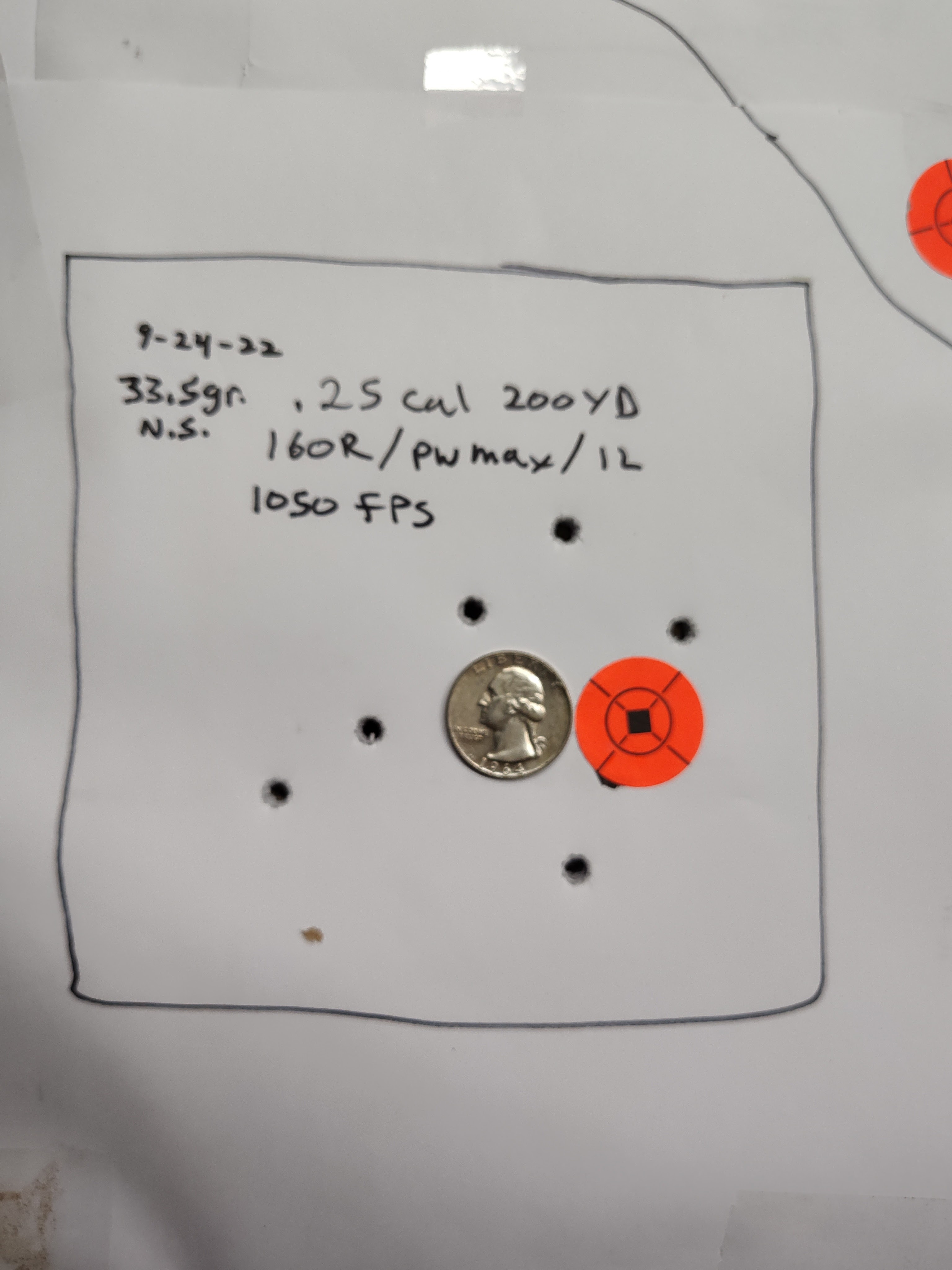

Yes, the extra air really affects the accuracy of the slugs. It is very evident at far distances. Below in the first picture is 3 lines on the Impact valve and the second picture is 1 line on the valve at 200 yds. All other settings on the gun were the same and one group was shot right after the other. The extra air on the first picture was with the valve opened just a little longer, which destabilized the slug.
That’s an amazing change and an awesome 200y group! I’m still an Impact newbie… is the valve you are referring to the one above where the bottle attaches?
I bought it because it can be a .177 through .35 caliber in one gun with the ability to adjust it to shoot pellets or slugs in any weight. Before I buy a powder burner, I usually have all the components to reload for it and many of my guns have never had a factory round shot in them. The Impact is as close to that as you can get!
The only experience I can relate to “dirty air” to is cast bullets in powder burners. A really fast powder like Bullseye can work well up to a certain charge and then accuracy goes to crap in a hurry. It’s hard to believe, even seeing it happen, that a group can go from 1“ to 4” with a grain of powder. A slower powder will increase speed through the length of the barrel with a lot more room for adjustment. So two different powders, same bullet, same fps but drastically different group sizes.
Is this a case of ”how you got this speed” that causes the dirty air?
