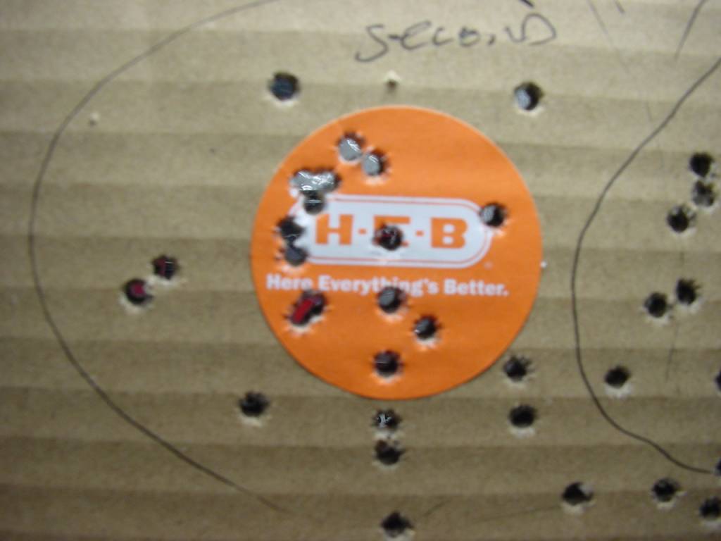

Knife
Fx bbl. before choke removal. o

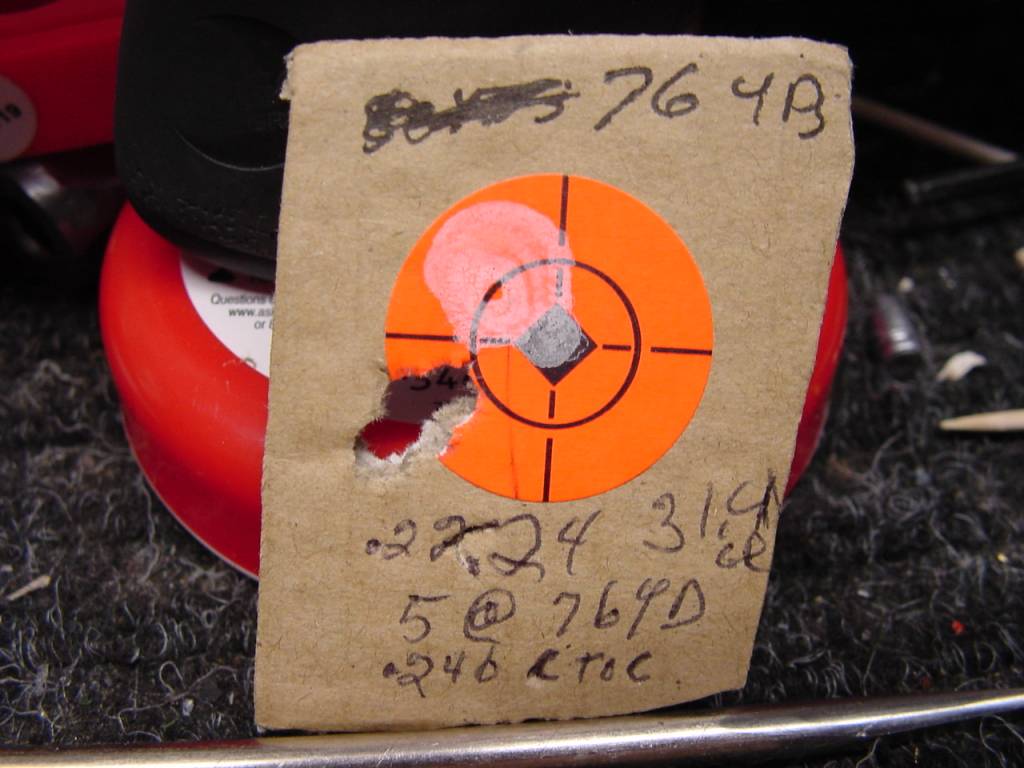

after choke removal, and before correct sizing .
Now after sizing to correct grove size. Adn shot with my off hand due to an injury.

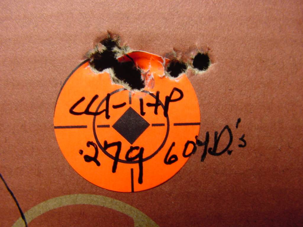

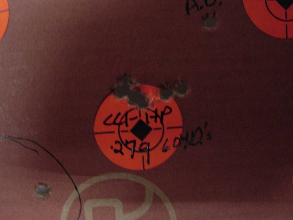

And finally after a full polish,

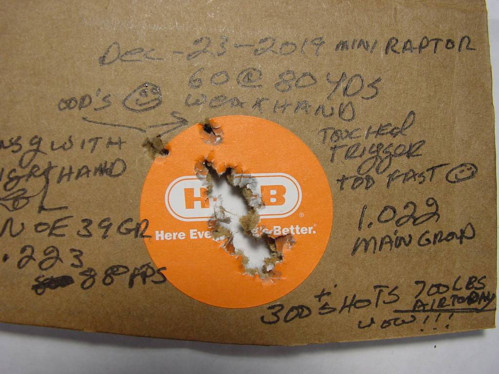

This is the same slug from an inexpensive PB barrel liner form a leading gunsmithing supply only now a .223 rather tan the .218 FX, so more power as well.
Oop's wrong pic.
PB liner, under 40 bucks. Hello!

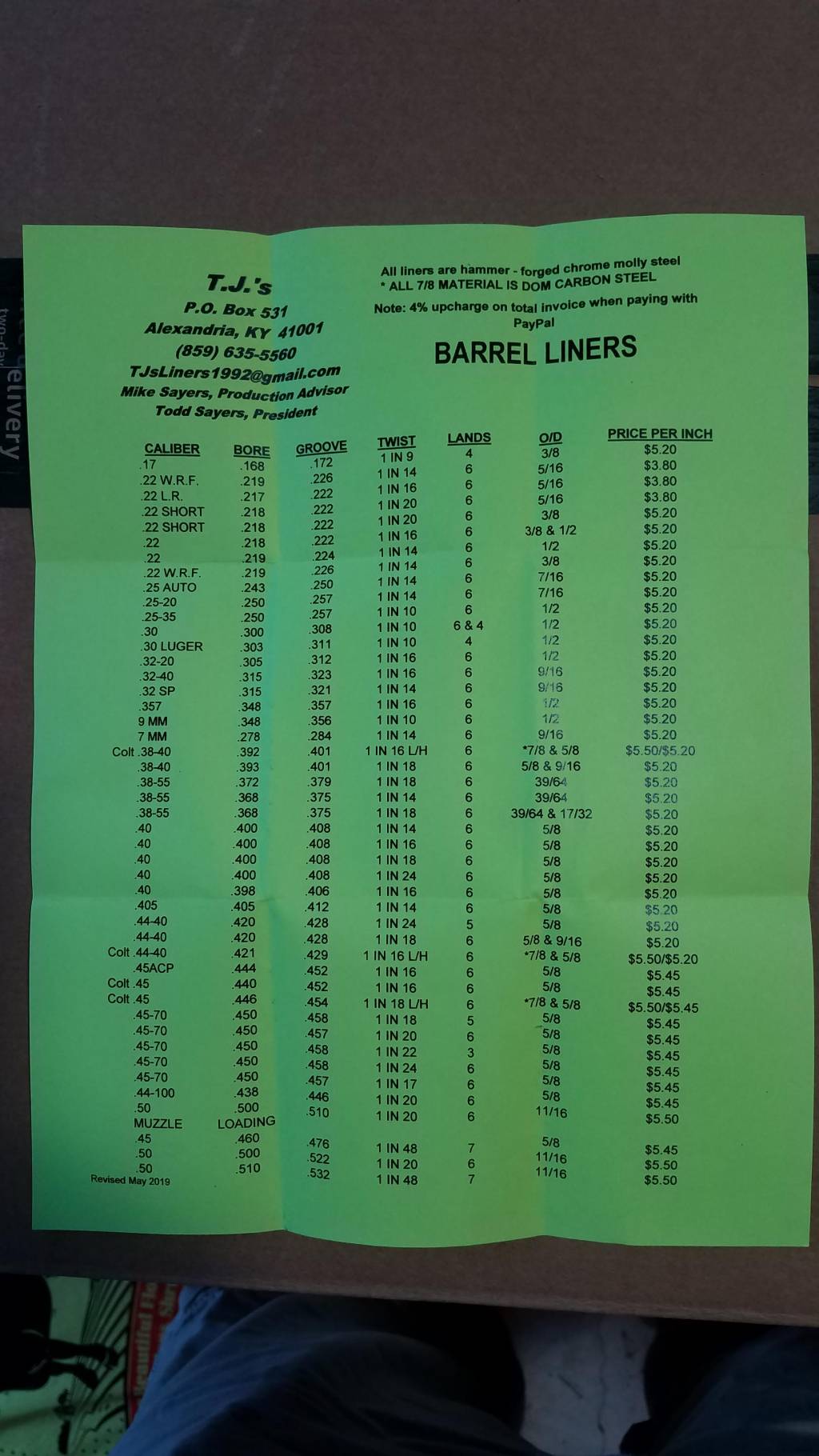

Yes, you can simply purchase a heavy fx liner, but a true firearm liner will shoot may more types of slugs with success. and ALL liners, including fx have to be fitted. They only fit fx guns without mods. I usually heavily wrap them with High modus carbon fiber tubing and then hope for the best. FX barrels are designed for their mostly hollow bodied slugs which fit the barrels which are more like a pellet than a true slut. YMMV.
FX barrels are incredibly thin. (so are the Brownell's barrels which are near identical in od.),. Either need an outer sleeve for stiffness. The TJ's are much thicker and can be used as it with the leade cut and crowned. Dyotat-100 has been using the TJ's for years in his famous and widely copied .257 and big bore Talon/Dors.

P. S.-The PB liners are available
where as the fx liners are often not, or the specs in twist have changed by the time you actually get them.
