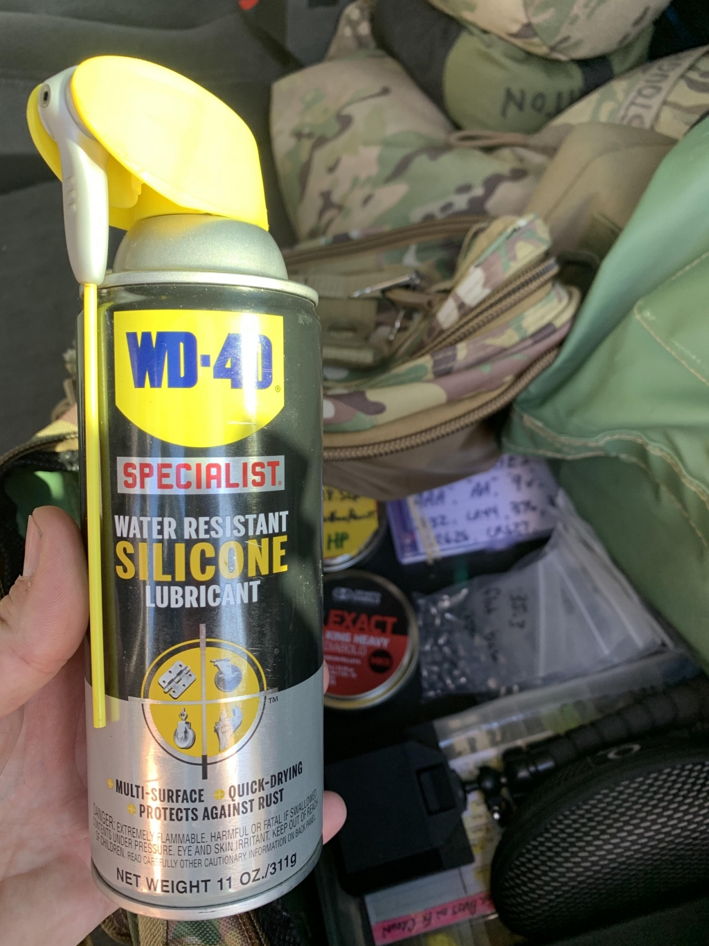

Yes and donno, I use silicon spray

Well there you have it, 100% agreement 😆
So many variables, you just have to experiment to see what works best.
