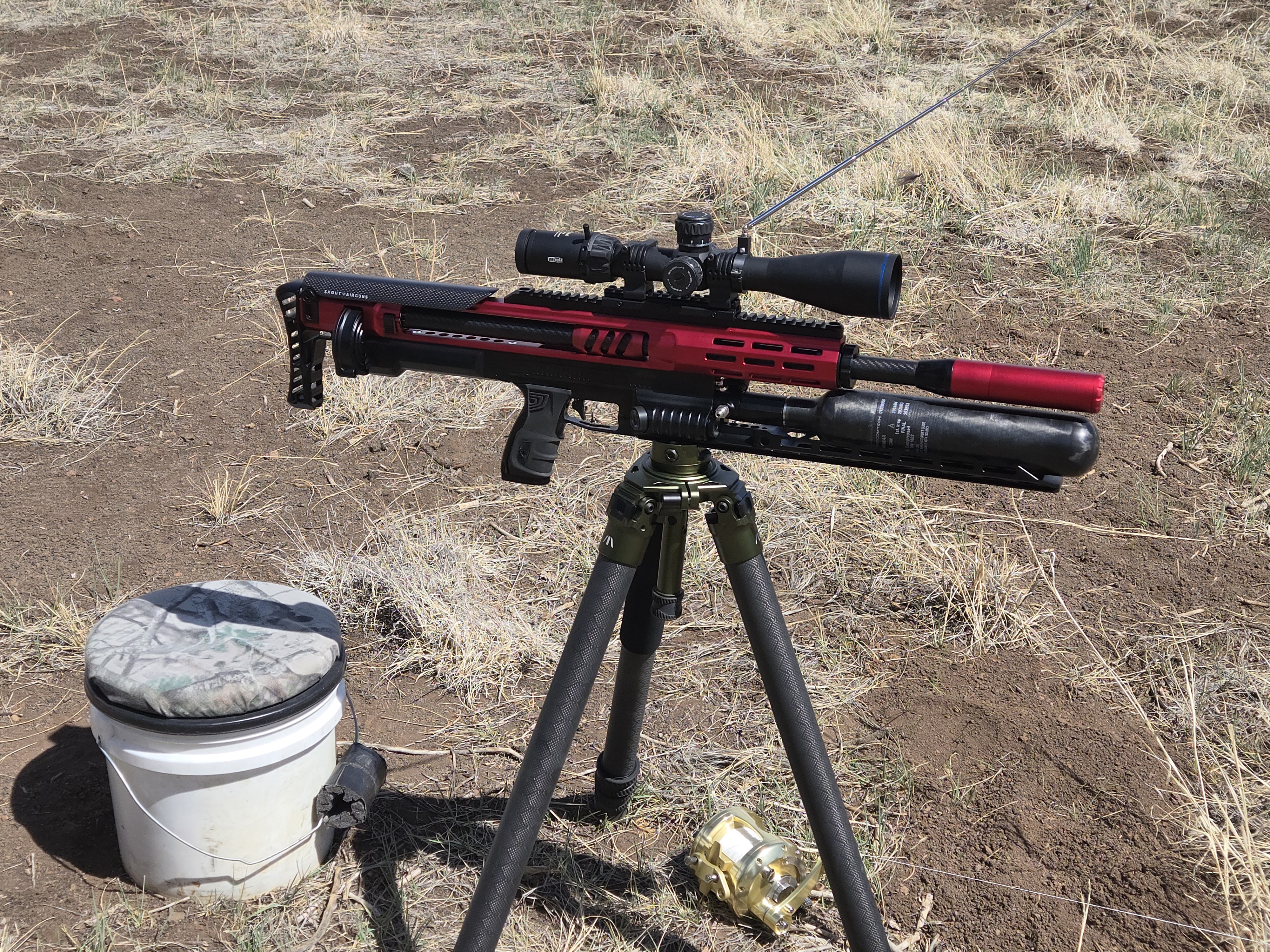

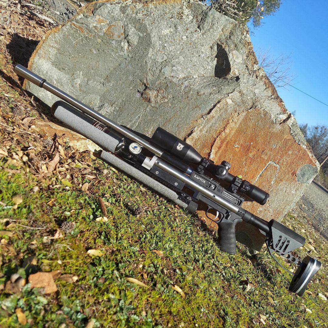

I have been shooting slugs since I got into this game. So not that many years ago. Back then they were a pain but I was determined to figure it out. These days they are not the mystery and voodoo they used to be. For some guns they can still be challenging but in guns designed to shoot slugs it is worth the effort for the decrease in wind drift, flatter trajectory and terminal performance If you have the conditions to mitigate the extended run out.

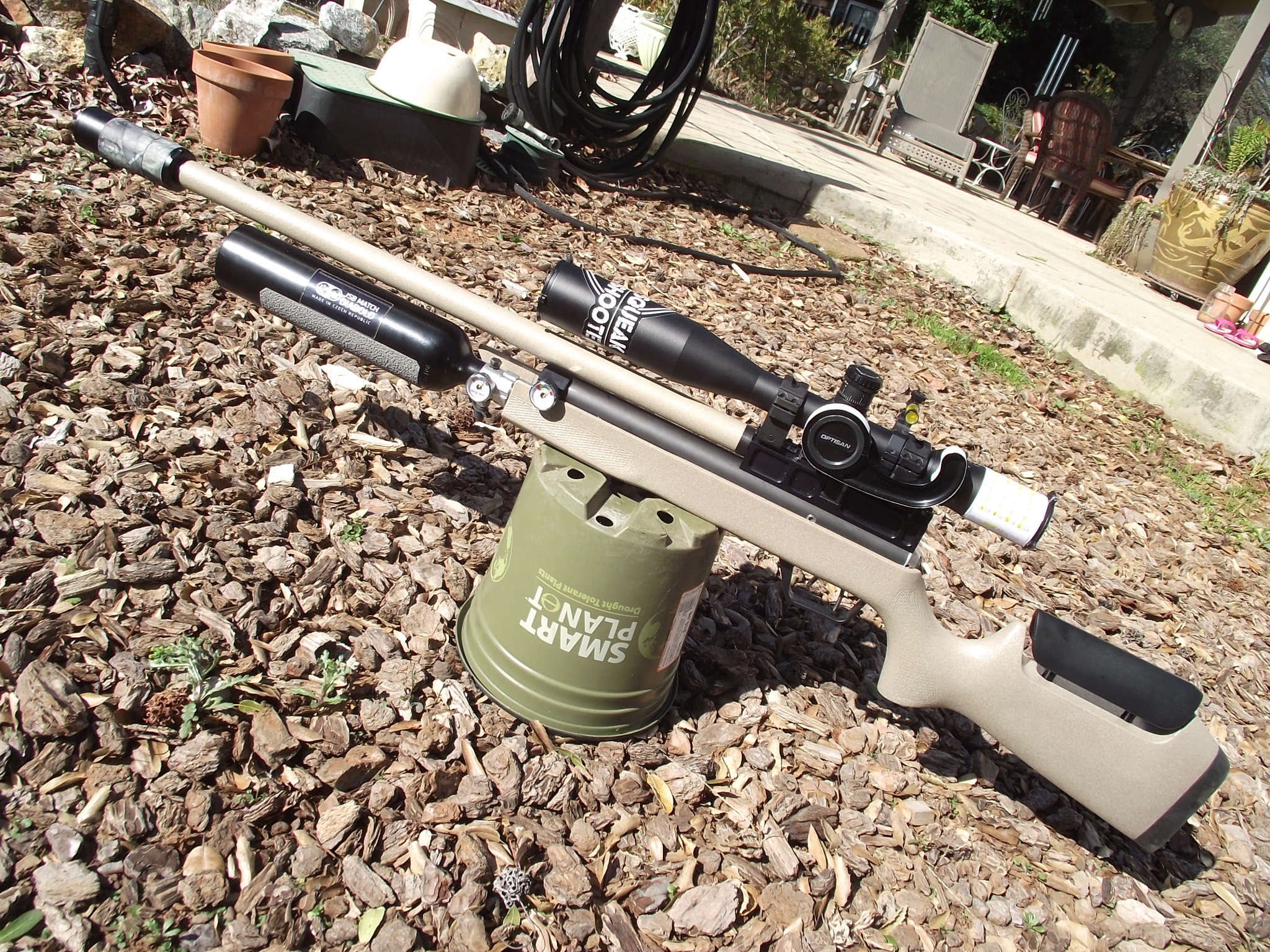

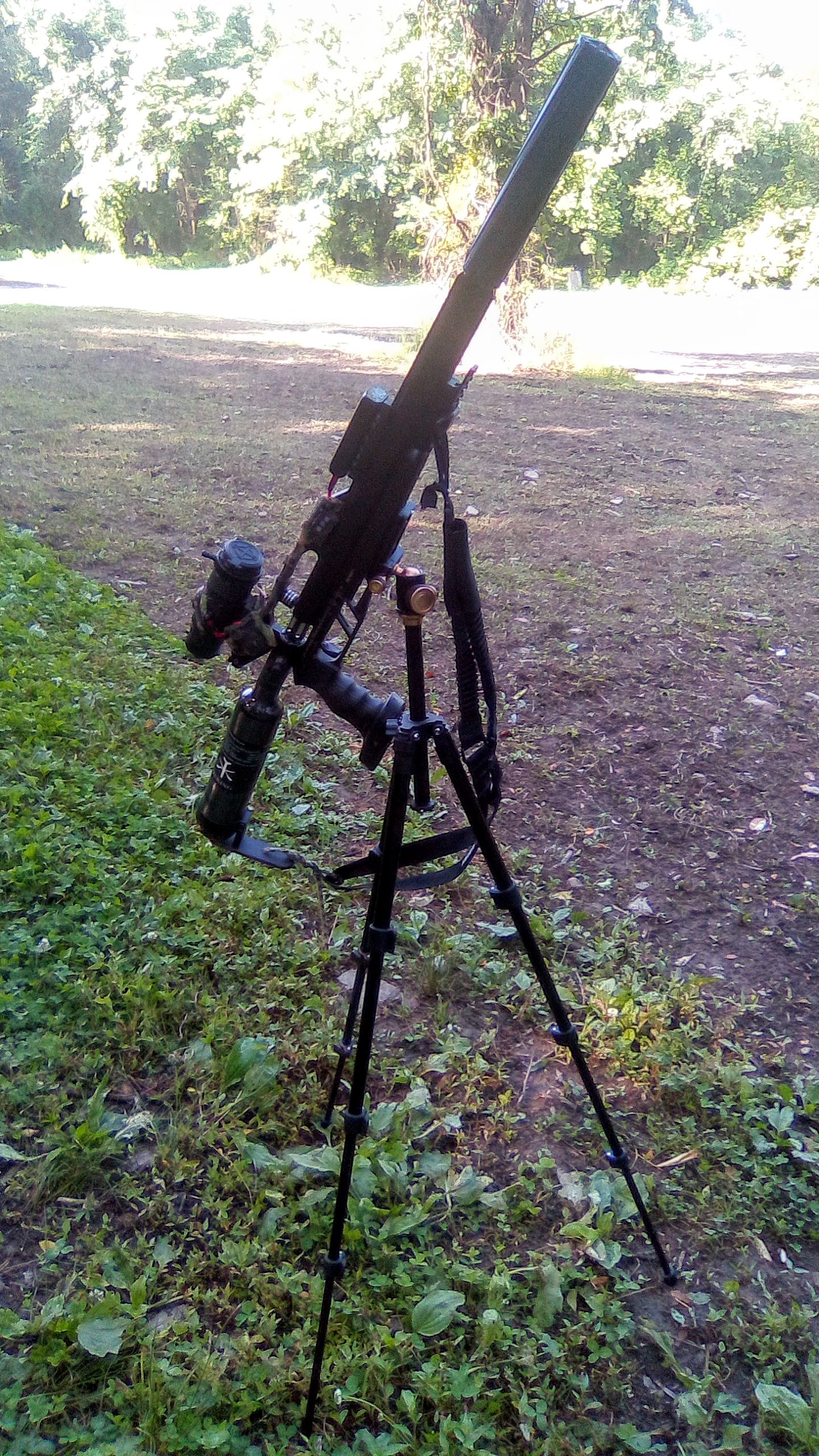

My most consistently-accurate airgun (of many hundreds I've owned) is the latest evolution of my original Mac-1 QB77 Deluxe that cost $159 brand-new thirty years ago; now known (by me) as The Most Improbable Slug Shooter On Earth. And although all that remains of the original QB77 Deluxe is the BARREL and bolt-action, the custom-stocked QB/Gauntlet hybrid consistently averages less than 1.20" five-shot groups at 100 yards with 16 and 20 grain H&N slugs at 28-30 foot pounds.
Although I've had a (very) few air rifles that once or twice averaged better groups, none did so with such unerring REGULARITY as QB/G. A brief history-
I had the stock (above) custom built to my design by an old gunsmith in Fort Worth in the late 1970s for a Crosman 160. The QBs being a(typical) Chinese rip-off of the Crosman 160, some thirty years later the stock found its roundabout way to the QB77; that (by then) had captured a Field Target National Champion title in a different, AR2078 stock.
Last Christmas a buddy gifted me an Umarex Gauntlet; the Gauntlet being another, this time Chinese/American conspiracy rip-off of the Crosman 160. The Gauntlet guts, and a Ninja Flex adjustable regulator, allowed a long-sought power boost way beyond the 20 foot pounds I'd been seeking for decades.

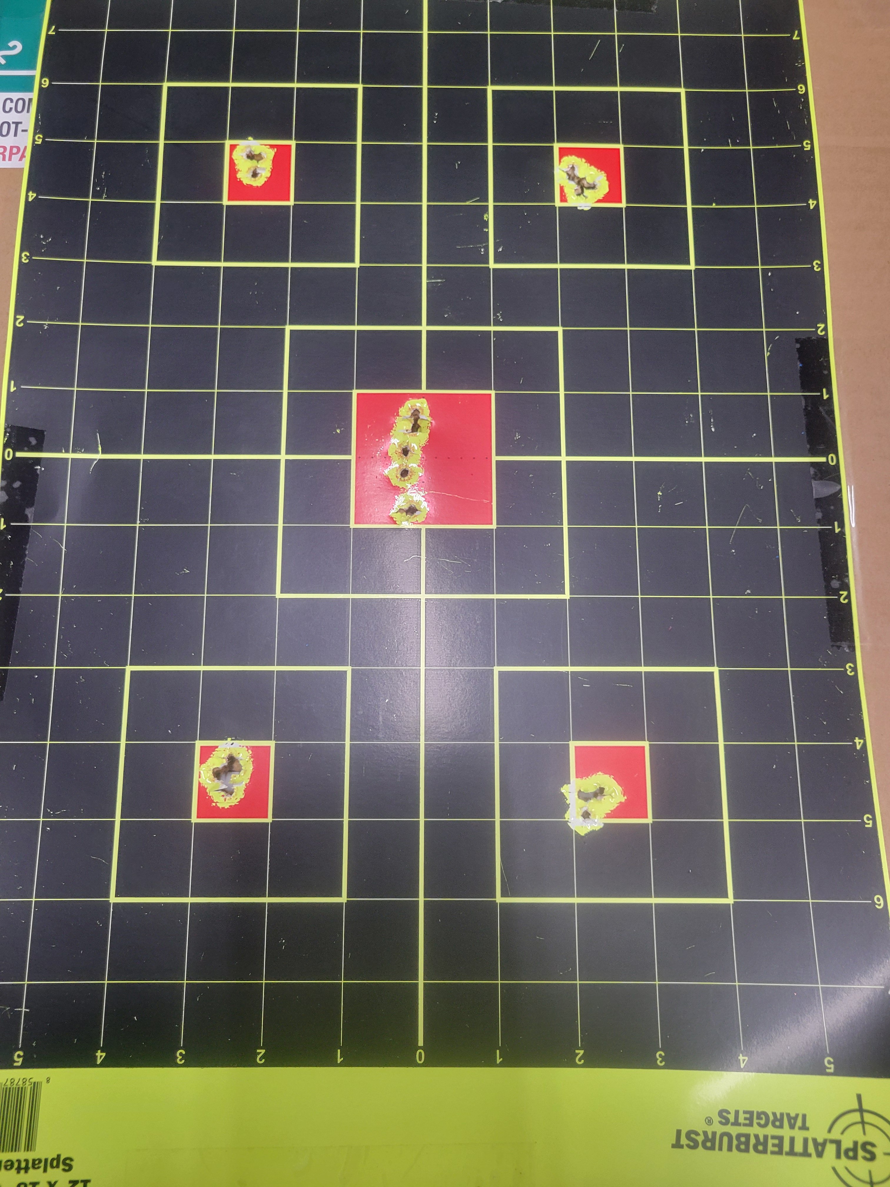

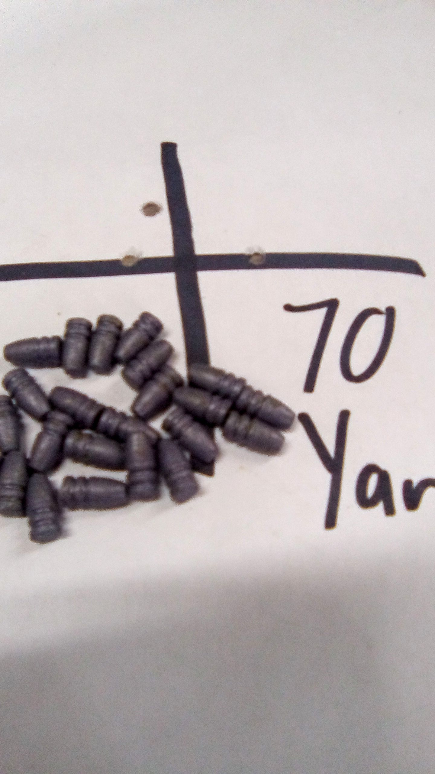

Having never achieved decent accuracy with any slug in any airgun, for some inexplicable reason I decided to make a last-ditch effort to do so by trying slugs in QB/G. To my amazement she achieved what none others could- aforementioned CONSISTENT five-shot group-size averages under 1.20" center-to-center... consistent as clockwork. Many groups go under an inch, some under 3/4"; none over 1.4".
Five shots at 100 yards-
Ten shots at 50-
