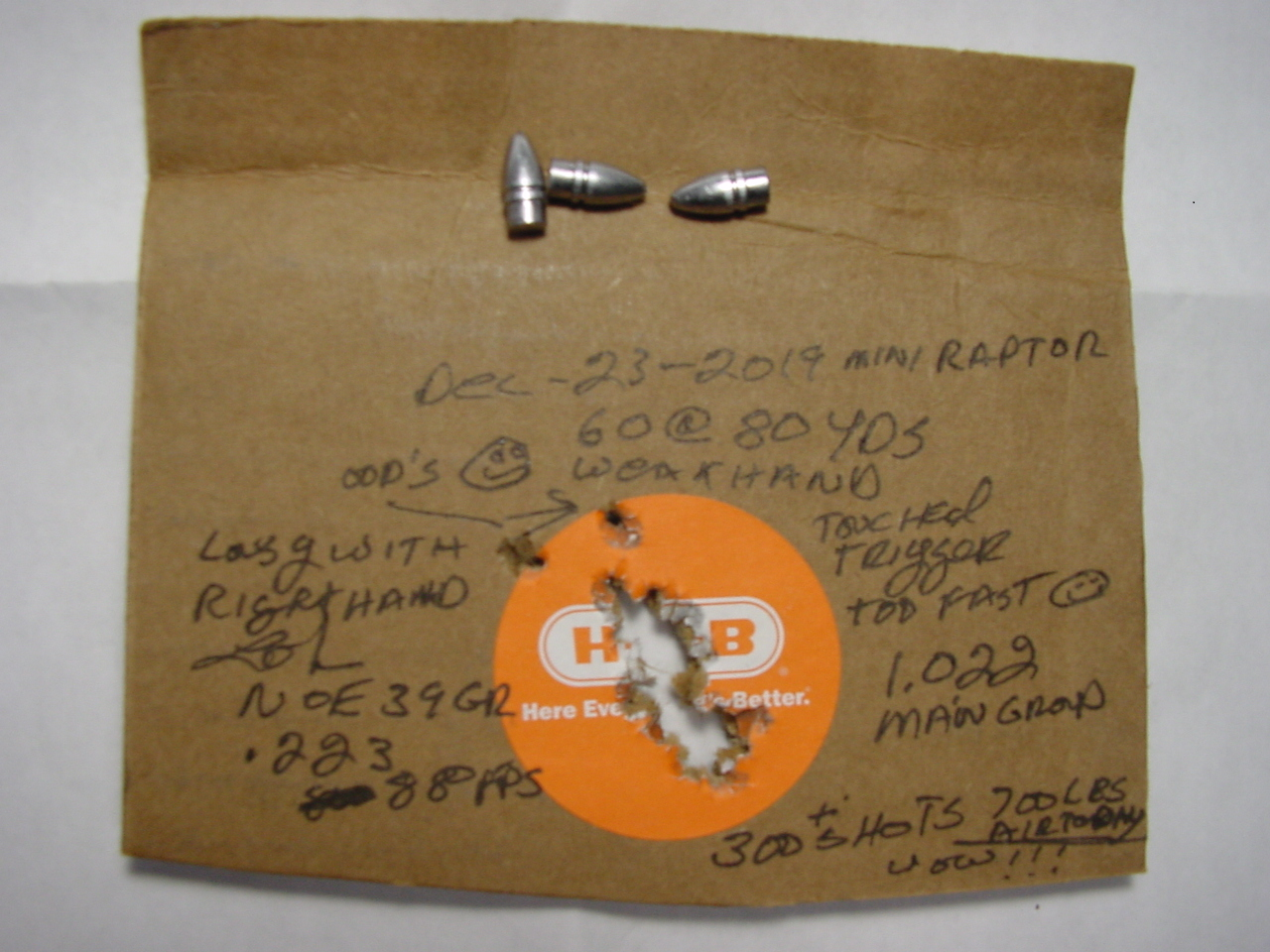

One doesn't have to go the home swage route or depend on what you get is what you have. Do your home work. Remove the barrel and slug it Push one of your slugs thru.
Now, order up a set of NOE Bullet Molds sizing inserts and an inexpensive press.
Order your slugs slightly oversized for your grove's in the bbl. Size to a few thou. over the groove ida.
This is where your homework comes in. Some bbl's. like no more than .0001 under grove dia. and some like no more than .0003 over. This is how you get top accuracy from a slug bbl.
Shooting slugs accurately by simply pot luck ordering them and not having them a perfect fit is no more than Blind Hog Finds Acorn. It is simply plug and play and hoping the stars line up. The lazy mans wishful thinking adventure.
If you are serious, get serious.
Should you decide on the very expensive swaging route, this is even more important. Swaging dies are very expensive with a long wait. You had better know what your gun needs before starting the long drawn out and expensive hunt and peck of ordering, waiting, spending, and testing only to find you need yet another die for testing, and more and more and more. Searching for that magic combo. doing your home work will pay off big in the end, and a hell of a lot cheaper and the rewards with be worth the effort.
Example, cherry picked, but very doable. That's 60 shots!

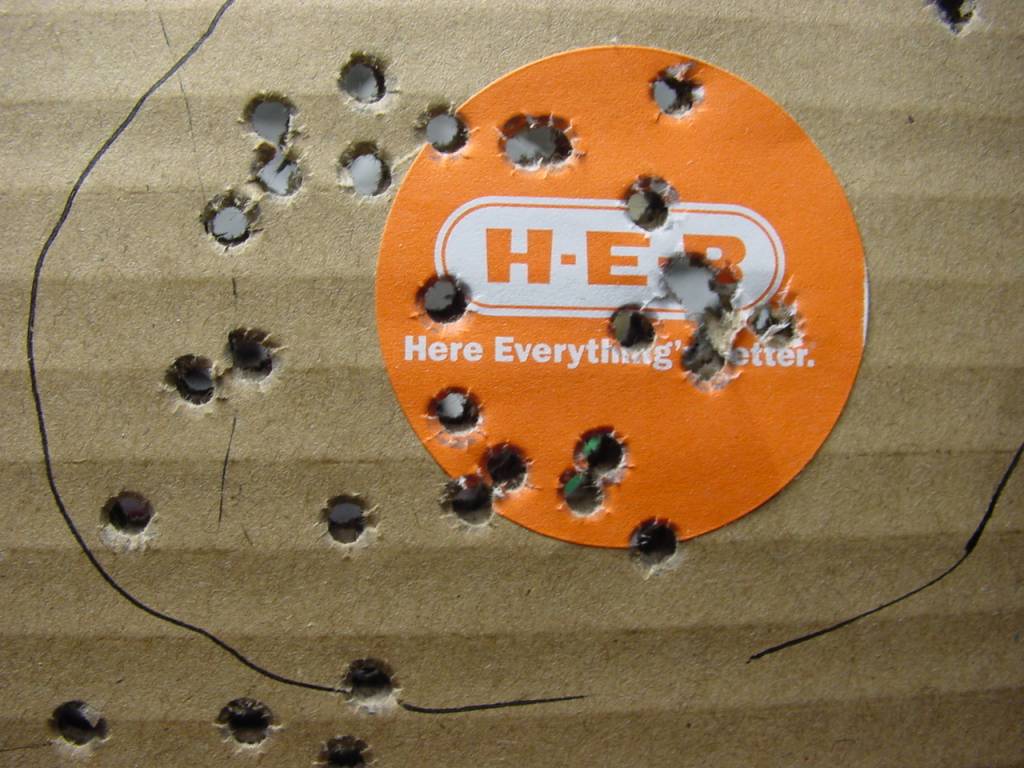

One last thing, if the barrel has a choke, either remove it or size to the choke groves, NOT the Bore Groves. View attachment DSC02497.1612466856.JPG
this was one shot to settle the reg, 10 on target. And lastly, the same slug and bbl. before removing the choke and sizing to the actual groove. At a much shorter range. GRRRRR!!!!
 all shot thru the FX, .22 Superior Heavy liner. Before and after proper sizing and choke removal. (the choke in the FX Superior slug liner is meant for the thin wall, easily conforming thin walls of their slugs, not a full thickness slug.) No choke is always the best option for standard slugs.
