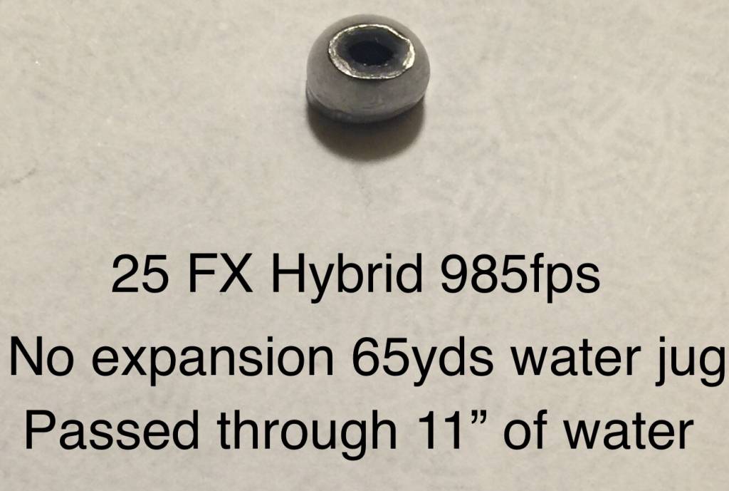

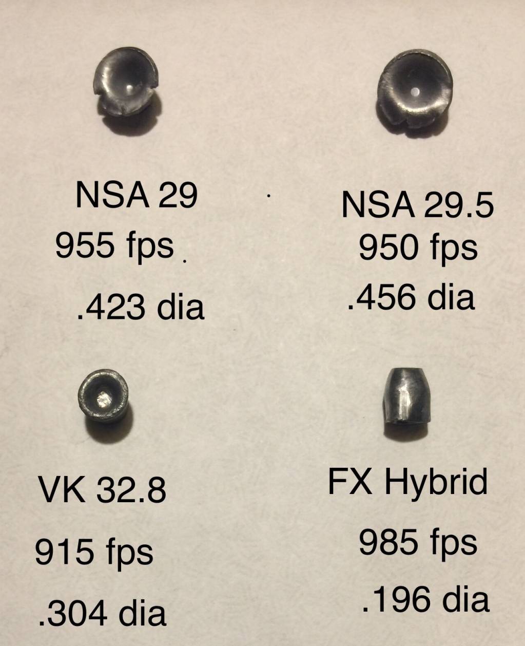

I’ve just recently been playing with slugs in my 3 wk old 25 Crown - NSA 29 & 29.5, VK 32.8 and FX Hybrid. I decided to do an expansion test and (such as it is) using 2.5gal water jugs with about 11” depth front to back. Set at 65yds I fired each slug into a jug at following velocities: NSA 29 955, NSA 29.5 950, VK 32.8 915 and FX Hybrid 985. I was very surprised at the results - it took me two tries to recover an FX slug as they both passed through the 11” of water without expanding. I will attempt to attach a photo of the results and will be interested to here what you guys think of this simple but seemingly effective (?) test. I’m hoping a woodchuck thats been hanging around will be the next testing medium ;-)

● expanded size of the projectile
● type of ballistic medium and thickness
● impact velocity (with muzzle velocity and range to target (and BC) we can calculate that)
Excellent!! 👍🏼😊
As AirgunBill and others have confirmed, water as ballistic medium makes hollow points expand a lot more than a quarry's flesh. So, the amount of expansion the test found will likely be less in our quarry.
However, your test clearly shows how this first batch of FX .25cal slugs isn't expanding easily -- even under ideal conditions of using water as ballistic medium.... ❓
Using the ChairGun ballistic calculator I come up with an impact velocity of the FX slug of 878fps. Not super fast, but still very respectable. It should expand....
