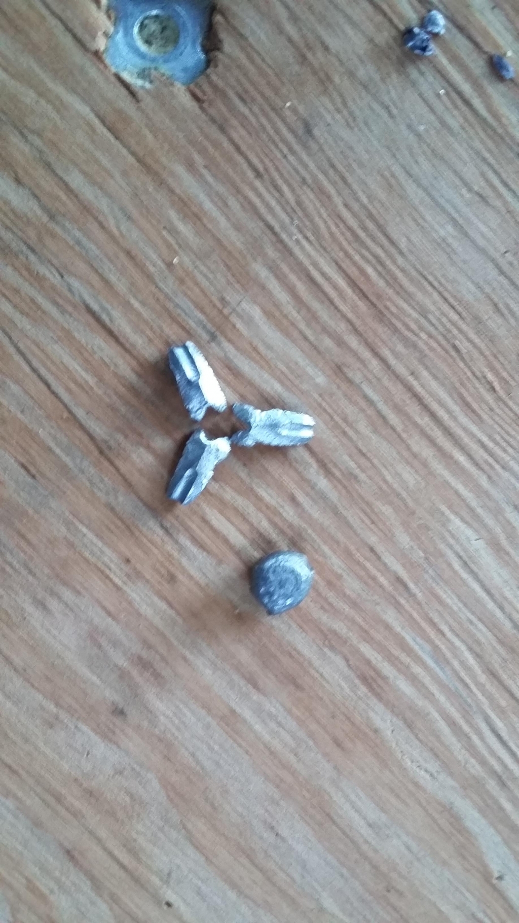

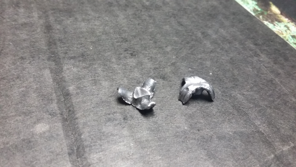

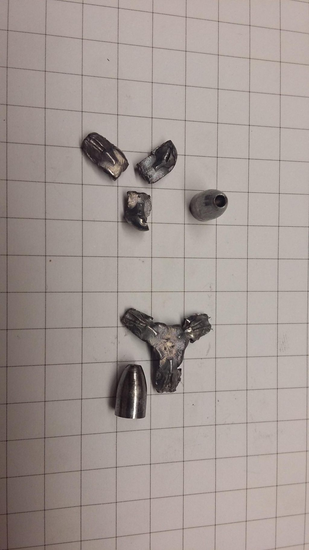

Long_Shot and I have been doing many tests on long and short range performance.
We both have Corbin swaging set ups. Mine is .22 and his is .25.
I can tell you that my 24 grain stop performing well at about 175 yards leaving the barrel at around 920 fps with a good performing HP. Yes I can still hit things at that range and longer but the impact and HP performance really get anemic.
Now take Long_Shots .25 38 grain. Cans of water exploded and sound like a gun shot at the same yardages.
We also capture the slugs to inspect for proper opening.
The reason is because we've been trying to perfect the ultimate long range slug design and we're getting very close.
These are 28 grain .22.
Swish those look great!

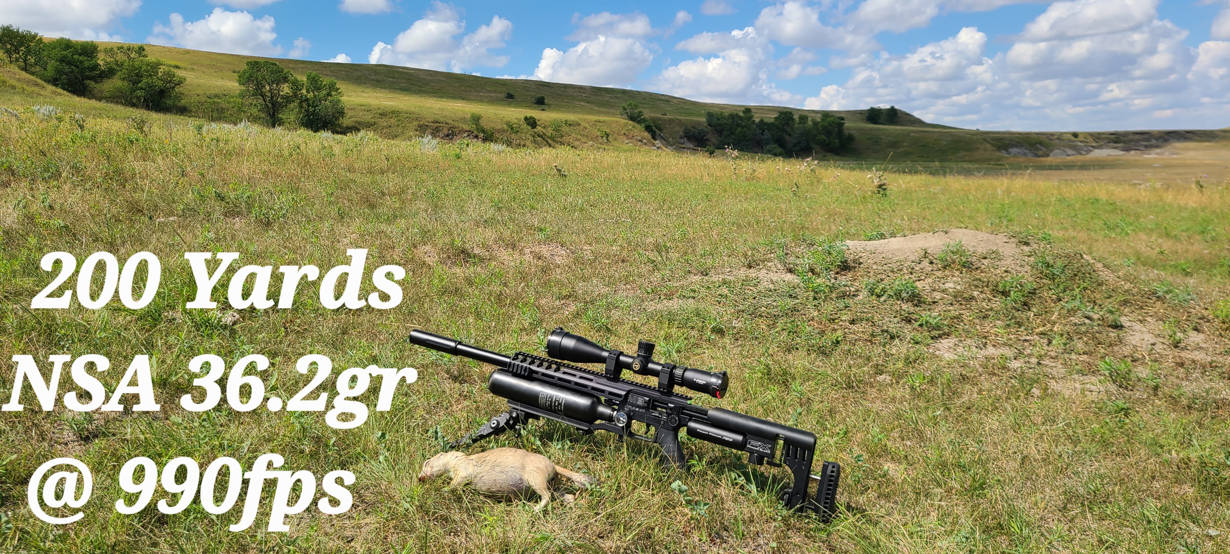

This late in the summer and shooting at heavily hunted prairie dog towns,Jbravo103 and I found
there weren't many shots under 100 yards.
115 to 130 yards was a pretty typical shot.
Even at that range 1 or 2 shots and they were gone.
NSA 36.2gr have been my ammo of choice.
Jbravo103 was shooting NSA 33.5gr @985fps
