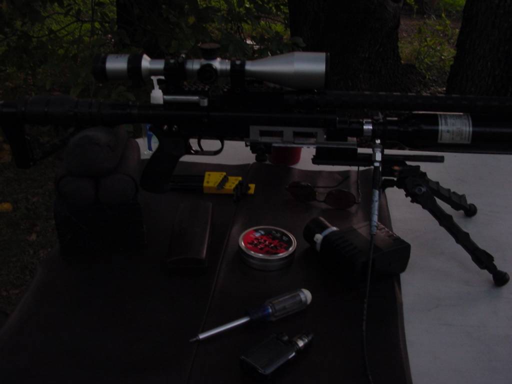

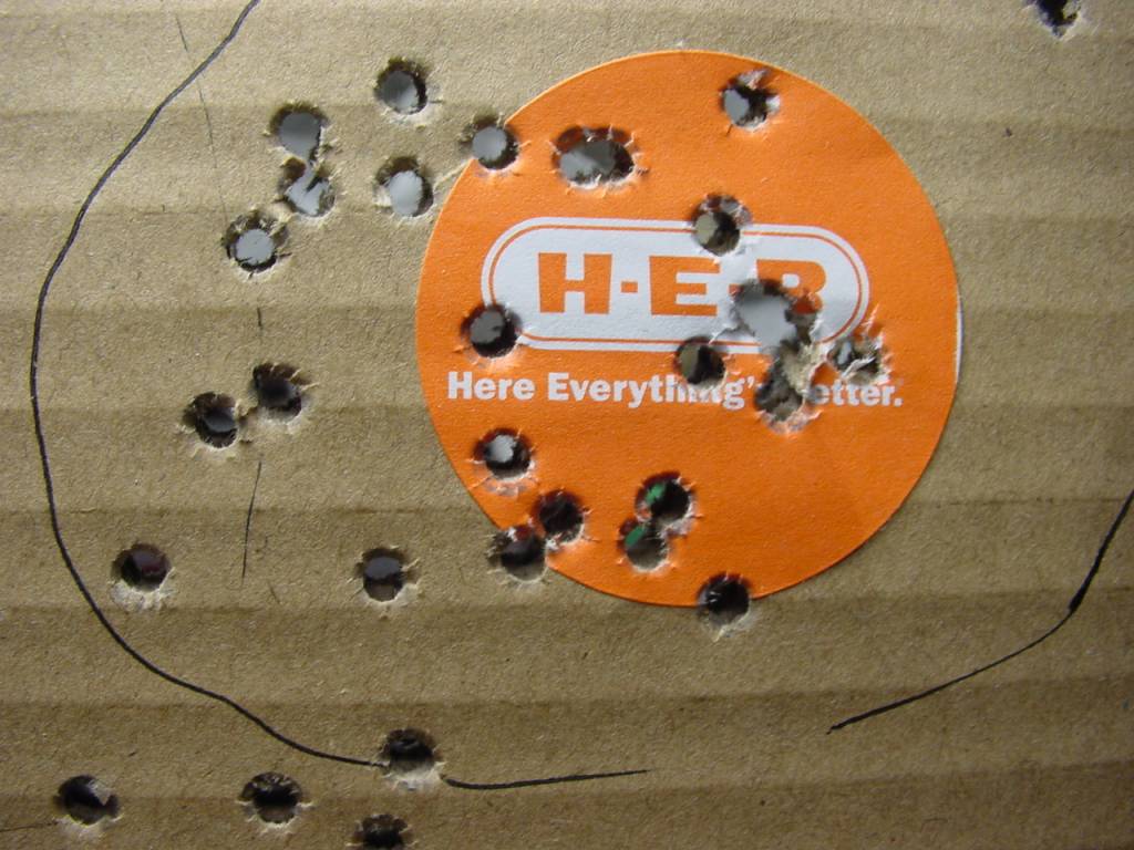

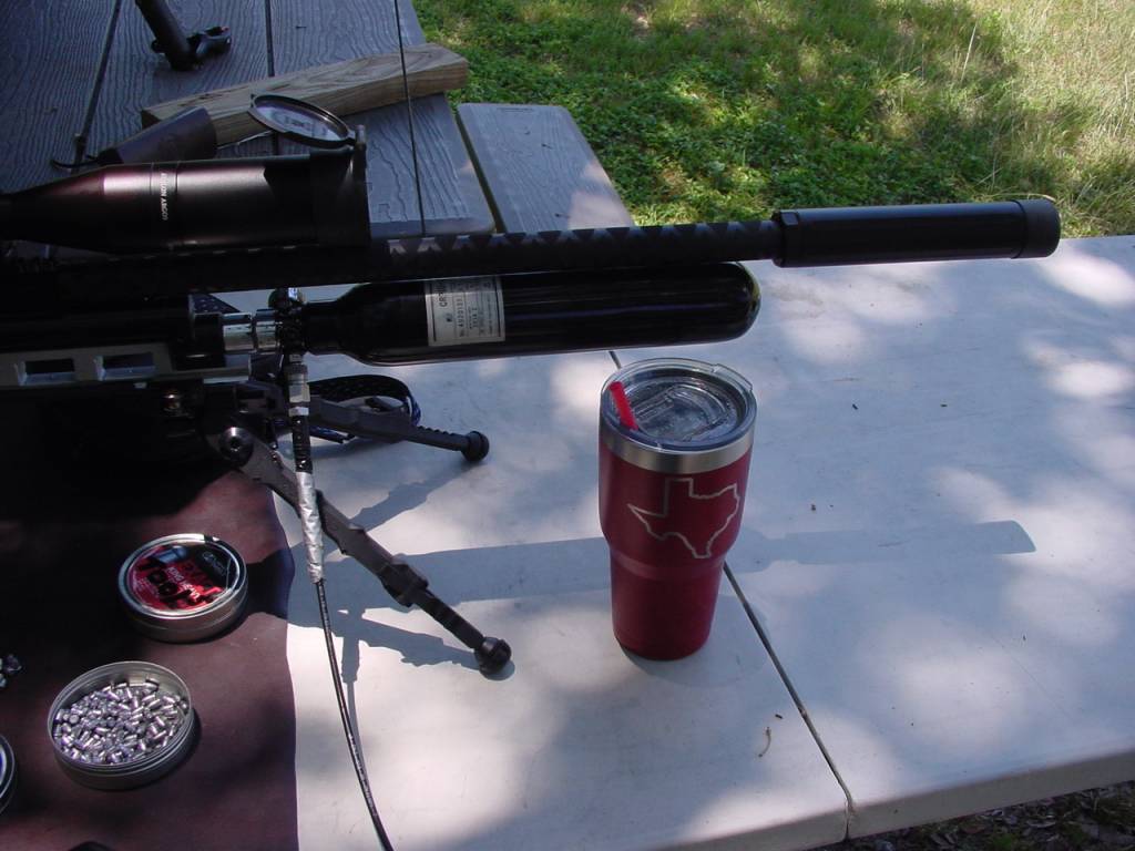

Pic of the mold and before and after choke removal and hp'ing the slugs.
Before it was a fine shotgun. LOL
Pic #1 shotgun. Pic #2 Choke removed. Pic #3, Mold hp's for weight bias. First two pic's at 40 or 50 yards. Last pic, 80 yards. One shot to settle the reg., and 10 on target. Seems accurate to me. LOL ;<) But NOT out of the Box. Cherry picked? Yep, but not uncommon at all.
