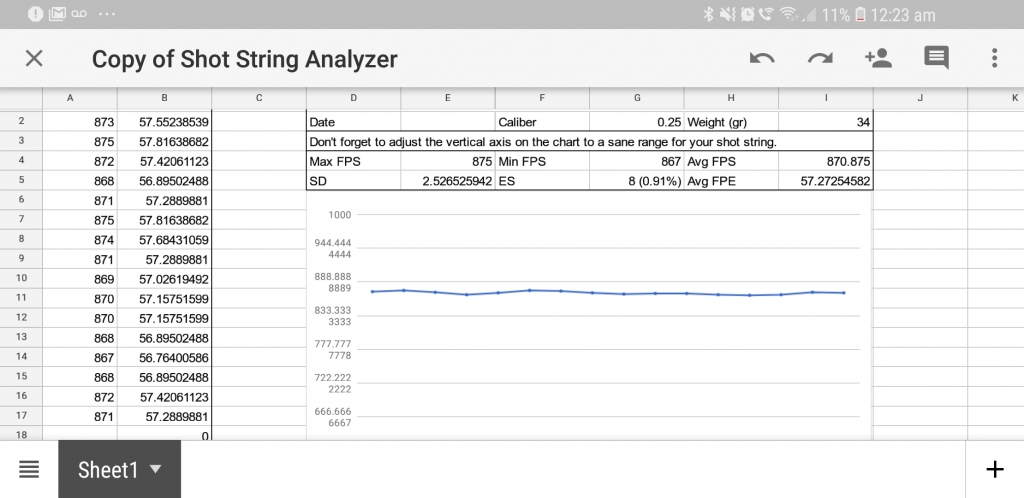

Factory settings yeild low fps. At 145bar i can get to 830-850.
My Current settings are
165bar, VS 8.5mm, HST 17.5mm
This is giving me 870fps with an SD of 2.5 and an ES of 8, very happy with accuaracy at the speed but it seems very high reg pressure for that velocity.
What can i do, i see some folk here are geting that speed at 135-140b with a 600mm barrel.

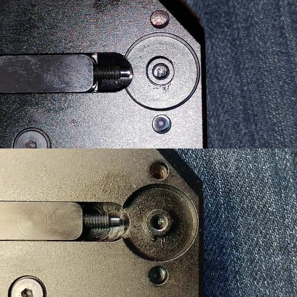

Do you have the hammer spring adjuster set for maximum compression/ pre-tension?
You want it like the bottom pic.

Hammer load tension isnt maxed out, but beyond the plataeu at 17.5mm yields no more fps, and causes more bounce un needed vibration, and inconsitant speed and accuracy. For more speed i need more reg pressure together with more Hammer tension
