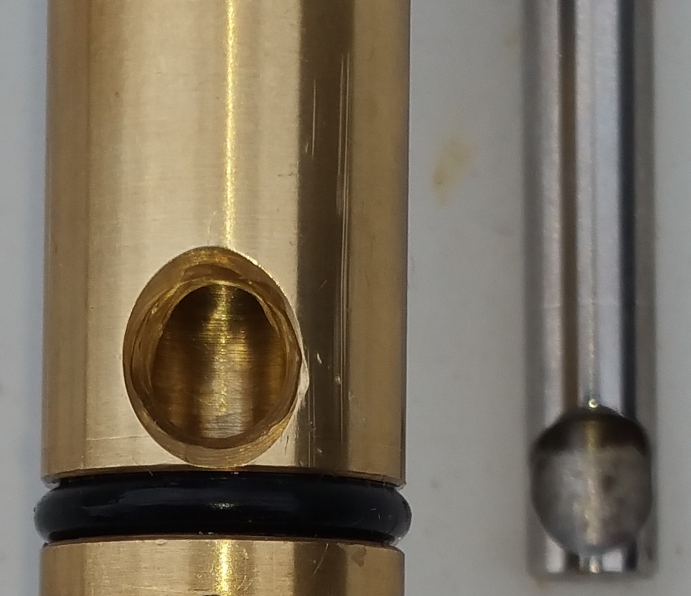

Loosen the barrel retainer screw 1/4 turn, rotate the barrel side to side to find the middle of the alignment slot and tighten the screw at the center point. This will align the brass transfer port better. Flaring the entrance of the brass transfer port back to the edge of the o-ring will eliminate alignment issues and give more velocity in .22.

Modified transfer port and pellet probe...
