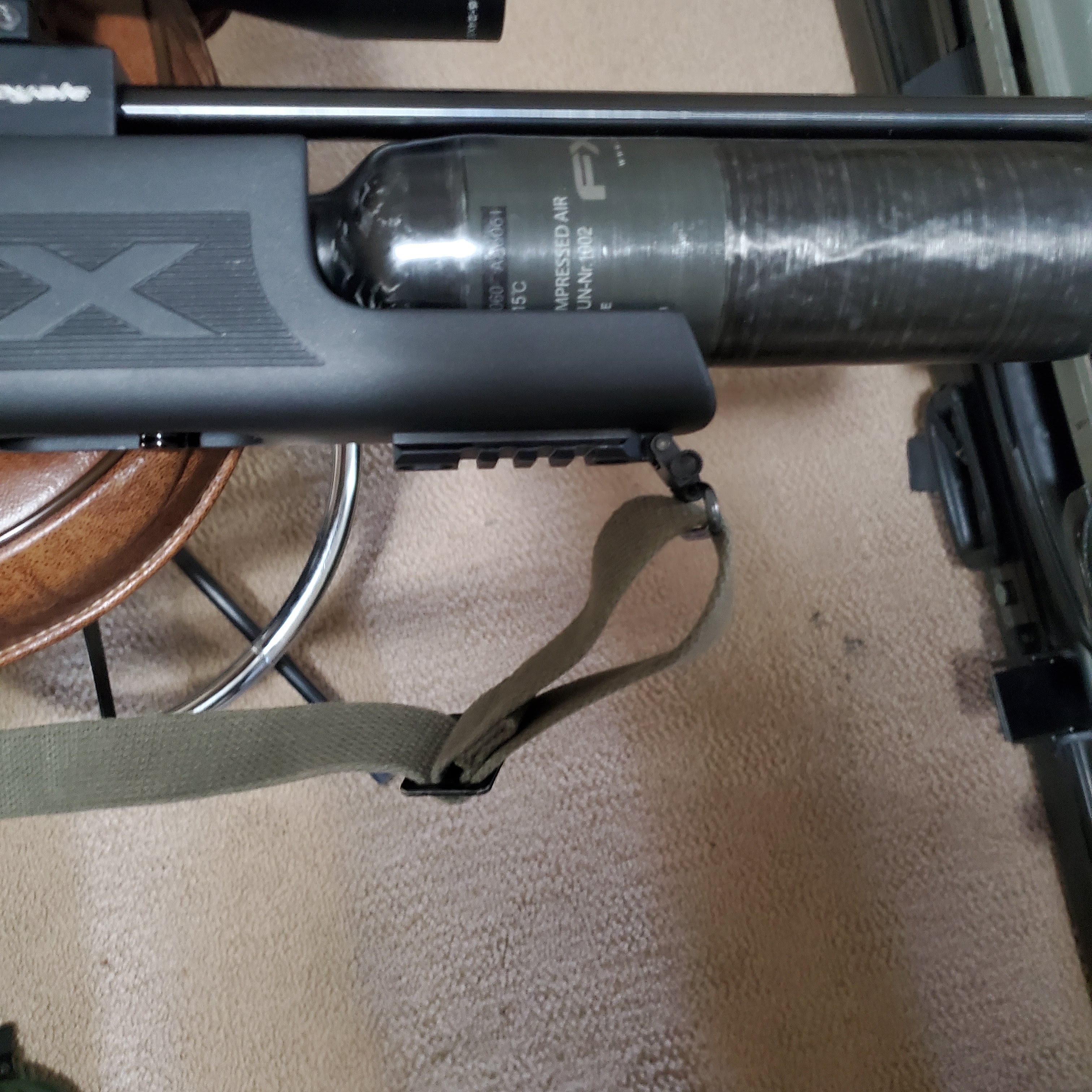

The pic rail I use is a combo rail, with a hole in front for sling attachment. It works fine for me for carrying, not sure about the balance problem, unless you are using it as a shooting sling rather than carry. By the way, the old GI cotton sling is, IMO, the best all-purpose sling ever made, light, comfortable, and infinitely adjustable. I've even used it under service rifle tension when in position. Sorry about the photo size, I couldn't seem to reduce it.
