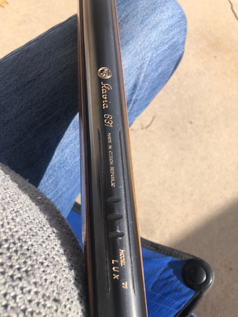

Forgot to mention I have the Slavia 631.

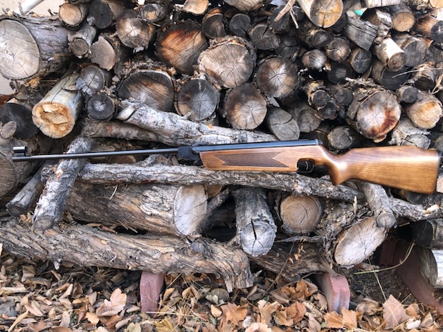

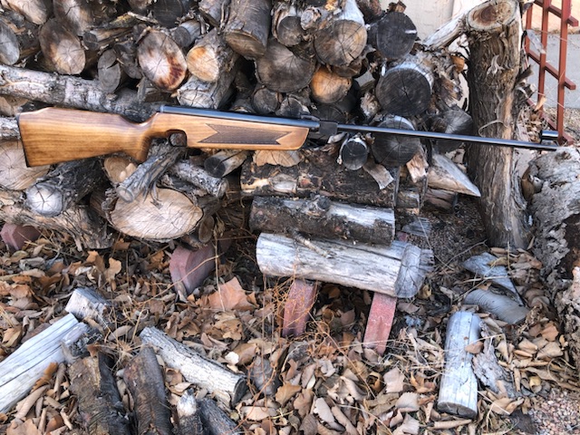

Here is my 631, sweet shooter open sites, I shoot this rifle a lot.
