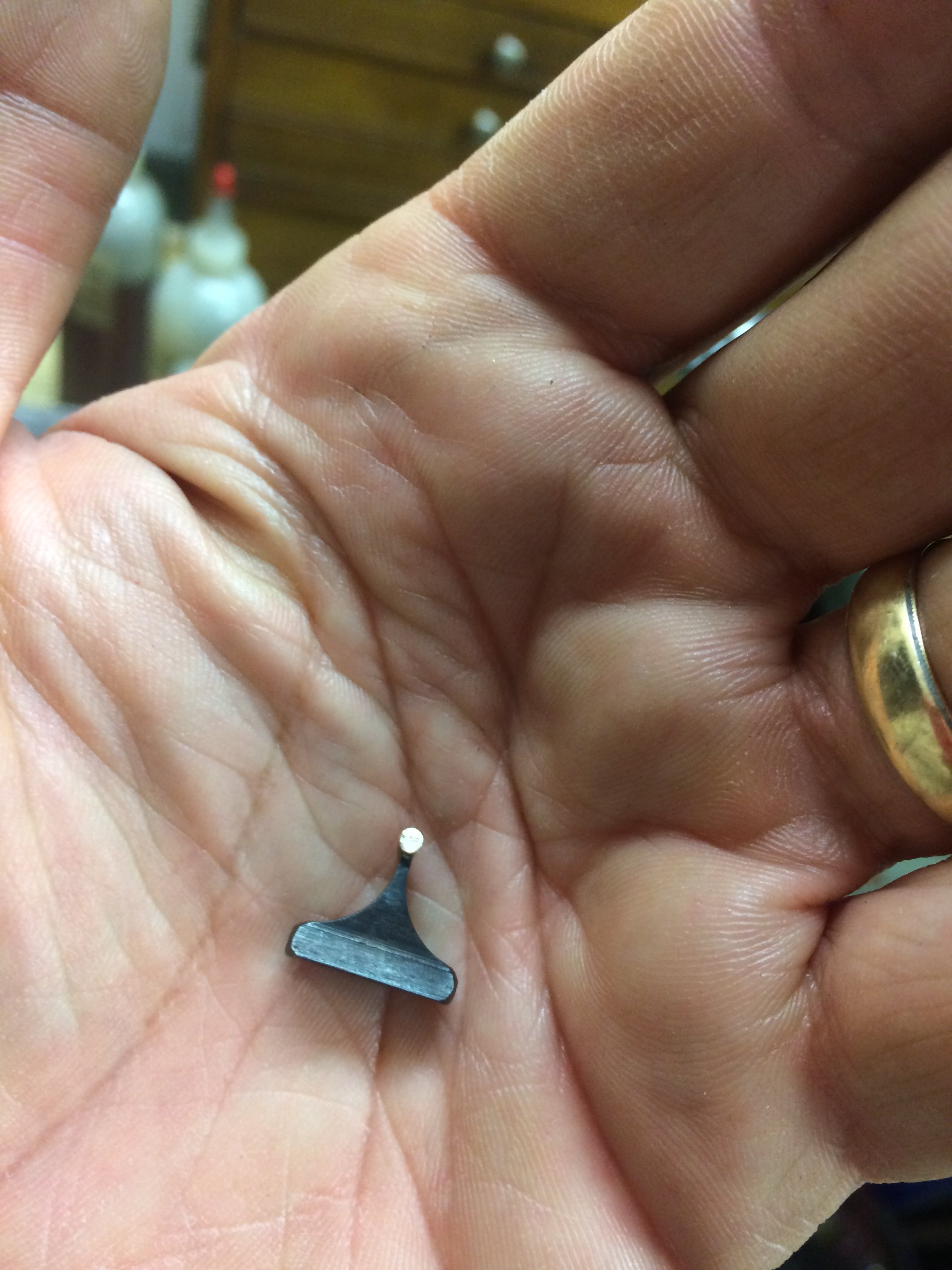

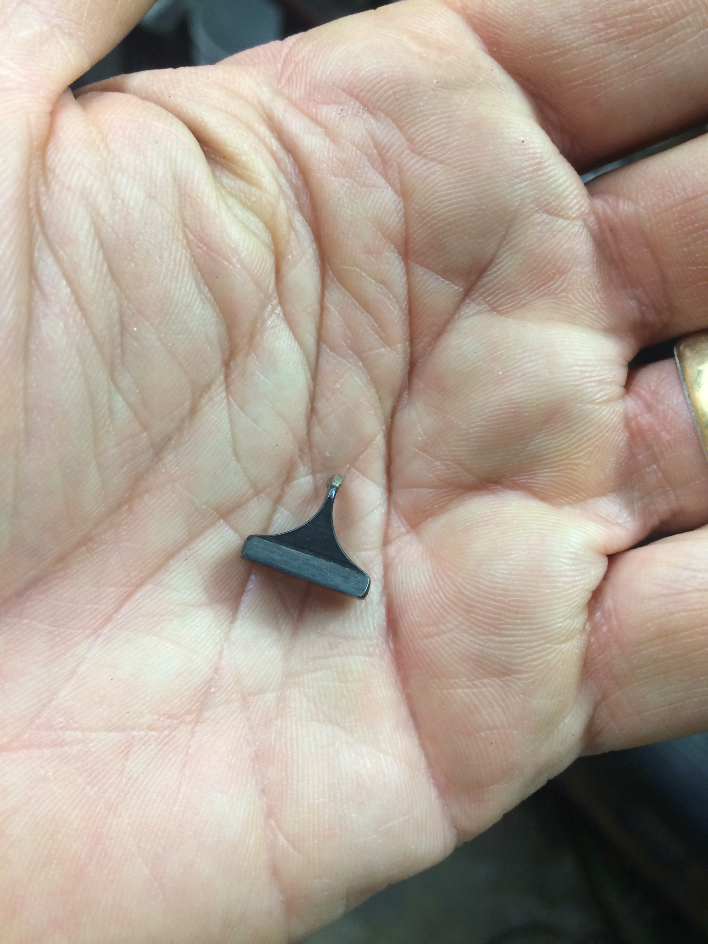

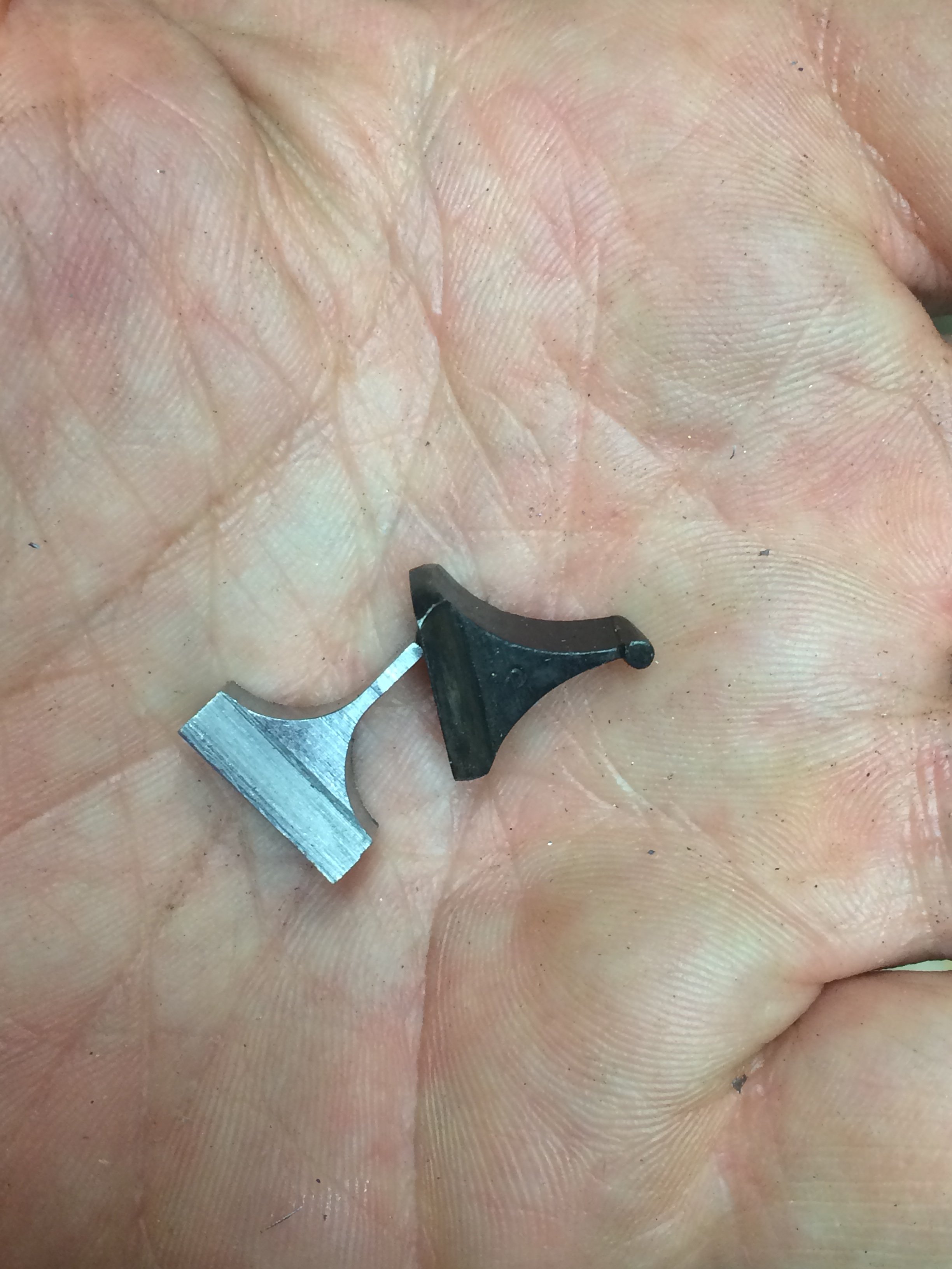

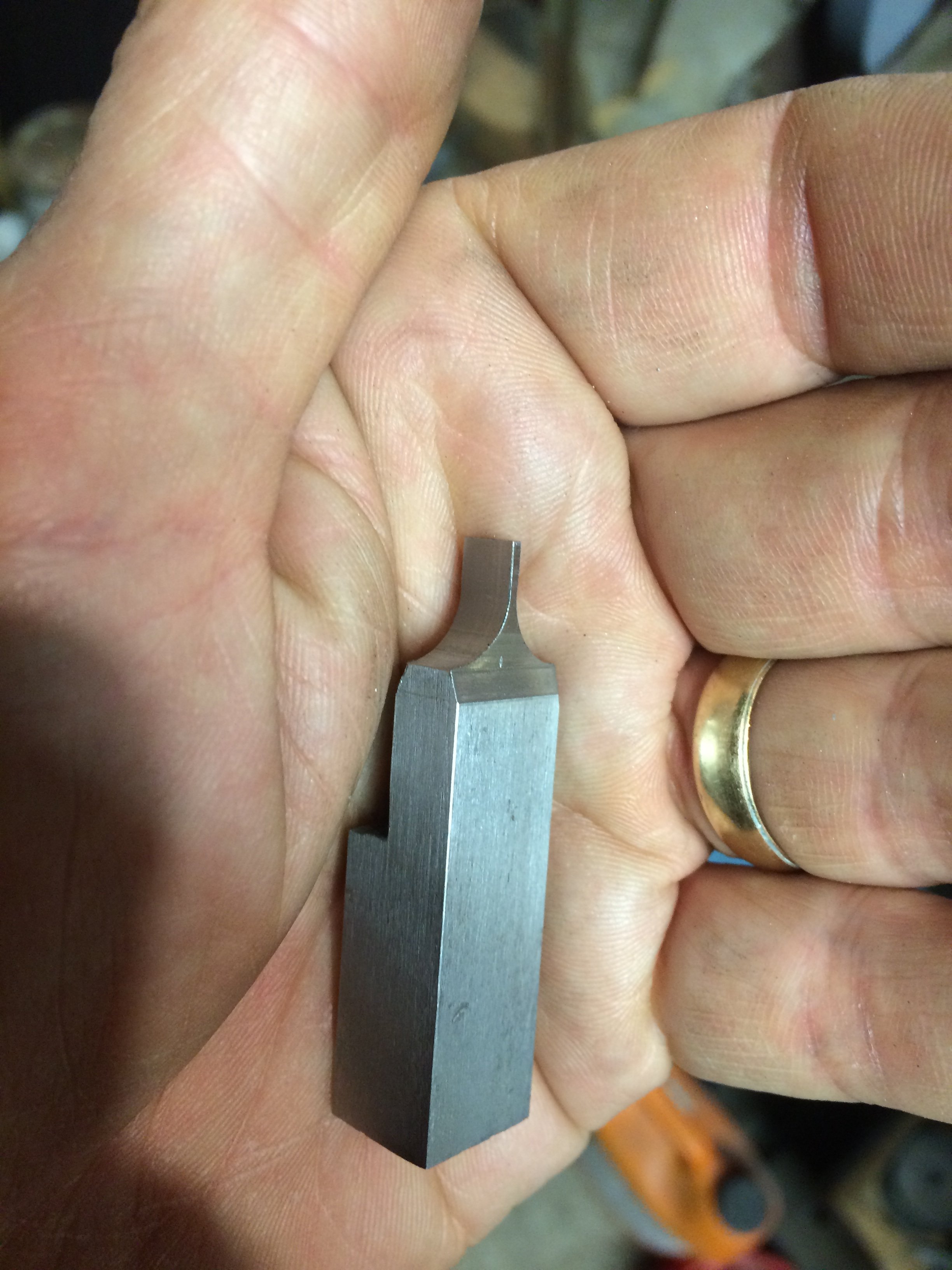

Does it thread in? I would make a temporary sight from wire to get the height needed for your specific gun. Then take the height measurement from that. The reason I say that is because I have made a few replica sights myself. One of he last ones I made was to specifications from an identical rifle (an antique BSA). After all the work (a lot of intricate machining and hand filing) and fitting of the dovetail I found the sight to be too low for this particular gun. I can probably still use it, I have quite a few of the early 1906-8 BSA's and the front sight is so often broken off right below the bead. See below another sight I made for a later 1912 Improved Model D

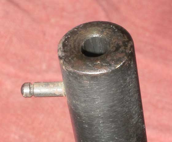

First picture is a Slavia 618 sight I found online.
This one was for a BSA Improved Model D 1912

My sight is as your first picture shows, just a round post. I am assuming it is threaded but I have not had the chance to try to remove it yet. It is broken flush with the barrel and will have to be drilled and a screw extractor used. The rear sight is adjustable for windage and elevation, so close to the right height will do.
I used to have a zip tie around the barrel that was close to the right height. If I cant get a reply with the height I will get the old post removed and temporarily set a wire in the hole with some putty to hold it upright and cut it off until I get it right and them make a permanent post.
