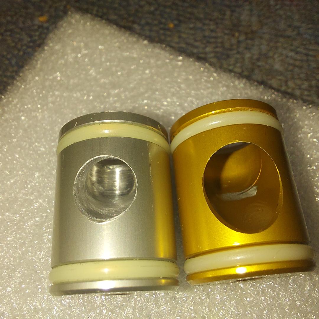

To understand this "Spool Valve" you need to take one out and look at it ????
The spring that holds the poppet to seat is fairly small & light, so once valve gets opened the speed it has to close would be very long in duration based on Sail effect of air moving past the poppet head and the effort spring is assisting.
* The bleed hole takes air from a pressurized valve throat during the shot cycle, and places the high pressure air on opposing side of piston where the solenoid air opened it.
This HP on pistons back side send the poppet back to seat very quickly !!! Larger the bleed hole faster will piston close chopping dwell duration.
Go too large :oops: the poppet will close to fast and you may not be able to make the power required .... There is a balance range here & bigger has limits you will quickly notice.
As to noise .... spool valves don't act like or sound like a conventional knock open poppet. Also the plenum surrounding poppet assembly likely is creating some sonic Ping during the shot.

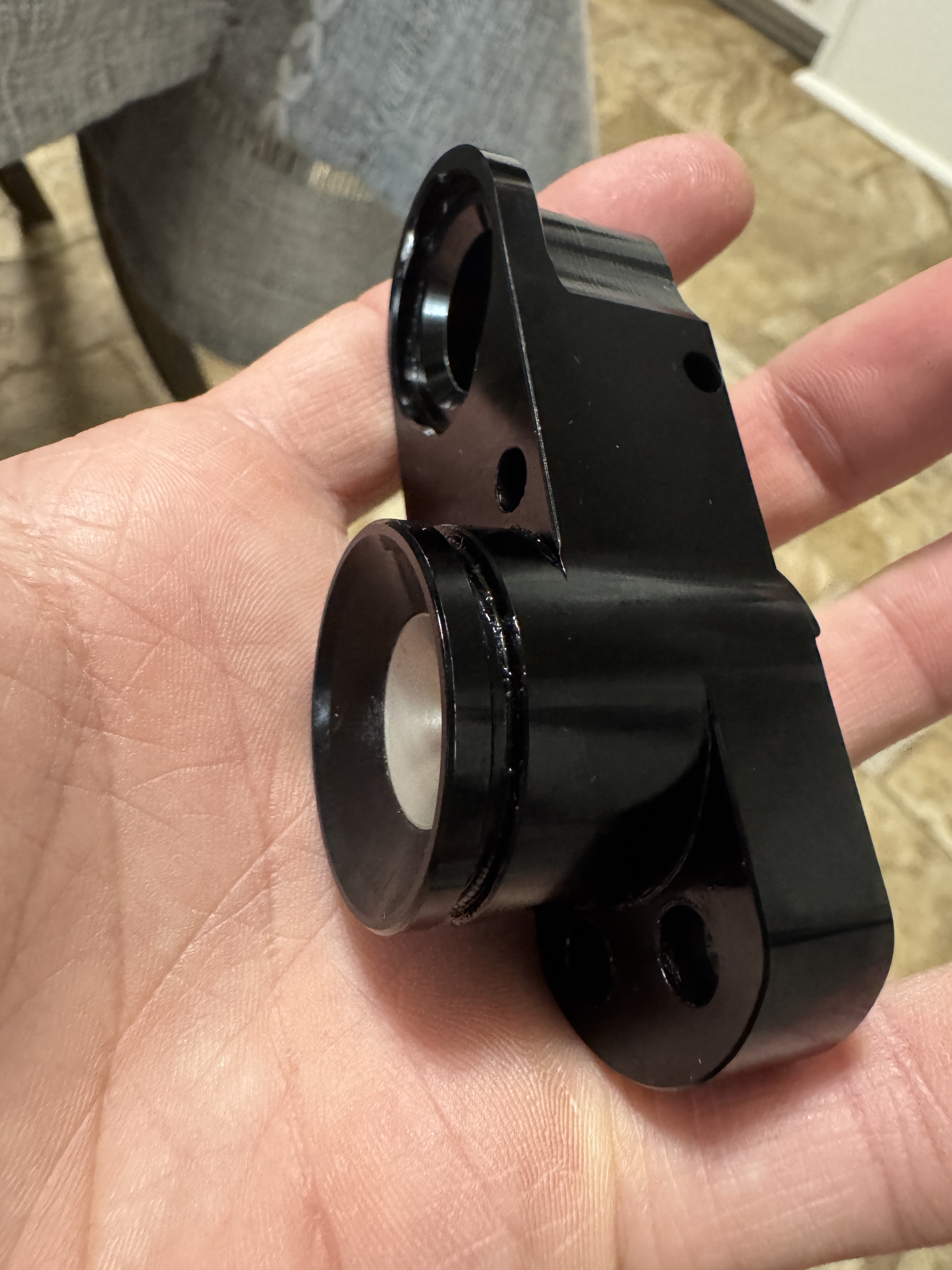

I really feel that this part going into the Plenum needs two rings instead of just one since all of that pressure is pushing against a single small O-ring
I really can't see the block leaking, are you sure it's this that is leaking, what you're hearing could quite easily be the spool valve seal as this is constantly subject to repeated compression during the firing cycle, and may leak until the plenum is refilled and the pressure holding it shut is enough to reseal.
While on the subject of the spool valve is there just the one size of the jet (for lack of a better description) in the end or would experimentation require just buying two or three and re drilling to see how much it affected the closure speed of the valve, and I suspect on an already restricted gun I might run out of dwell adjustment quite quickly as mine is already set to 12.

Kind of point proven! But it's really difficult to see just where that's coming from? I guess if you have access to a lathe with a four jaw chuck, you may be able to put another small O ring grove in the block, but that could equally be coming from the transfer port/tunnel to barrel interface.
Yeah I thought of that, but there is so little room to add another O ring :(

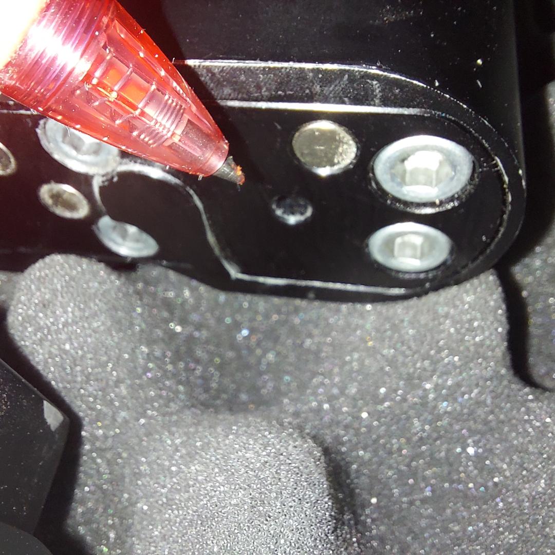

Also I thought that the air might be coming from blowback from the barrel to… and some of it might be, but if you grab the video slider you can see the frame where the bubbles form and it doesn’t look like the bulk of the air is from the barrel. 🤷‍♂️
Also, when I pulled it out of the water and dry fired it again it was spurting residual water from around the cracks where the block fits into the frame.

Figured it out I think ....
Poppet seat has 2 o-rings,
The o-ring closest to the seat see plenum pressure at all times.
The o-ring as viewed at bottom in picture below ONLY sees pressure during the shot when throat and transfer path pressurize.
* SO .... air leaks past this o-ring and exit threw the seat push out hole which looks
exactly the area as video is showing
