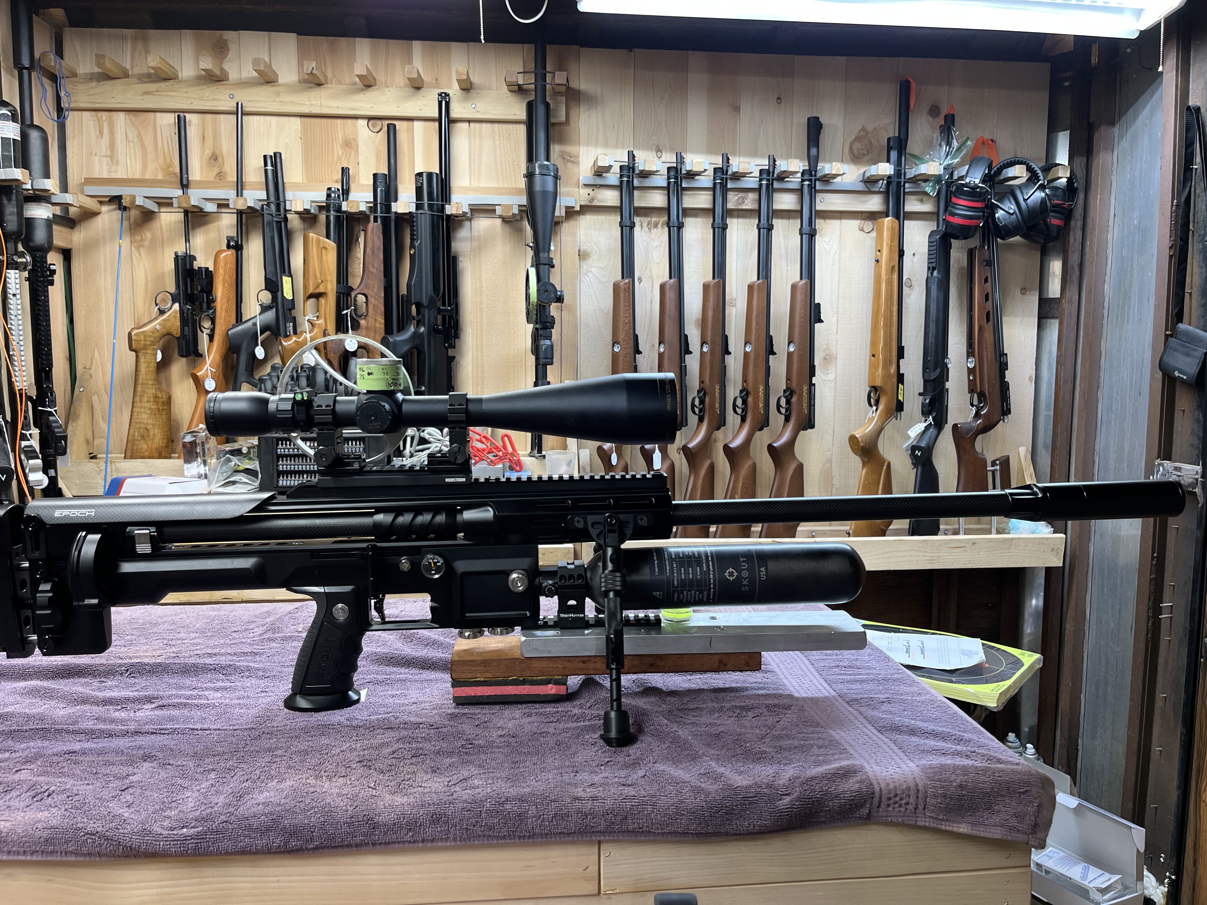

We have been testing our new Epoch for a few days now, and I'm very impressed. I have newer seen a regulator respond so quickly. I tried a speed shoot yesterday, shooting a full 22 shot mag of 30 cal 50 gr. in 44 seconds while we filmed the regulated pressure gauge. It was set at 1,350psi and dropped to maybe 1,150 and back to 1,350 is a split second... other guns I've owned, have taken 3- 5 seconds making accurate speed shooting out of the question.
In 44 seconds, the Epoch and I made a 22 shot group about 1 1/4" high and 3" wide with 12 in one hole right where I was holding the crosshairs. The wind was quartering in from the right at 2 - 11mph and I just held in the same spot, so the 3" width was due to that. If there was no wind the 22 shot group would have been 1 1/4" in speed shooting mode:)
I'm in love..
We did have to add some weight with an attachment for fitting into an adjustable front rest. The video we made showed NO movement of the barrel when shooting at 1,350psi with the 35" long barrel 50gr 30cal at 980fps

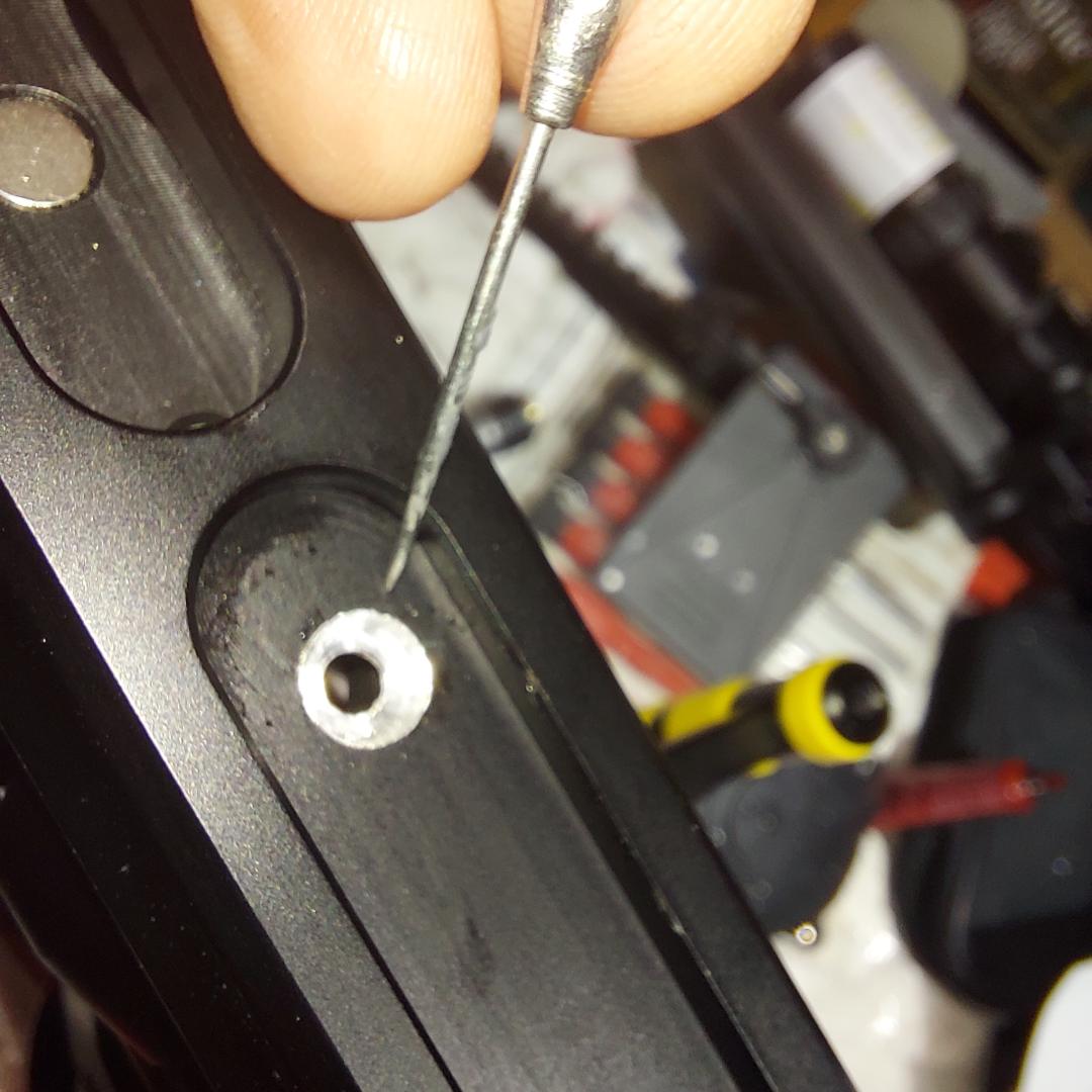

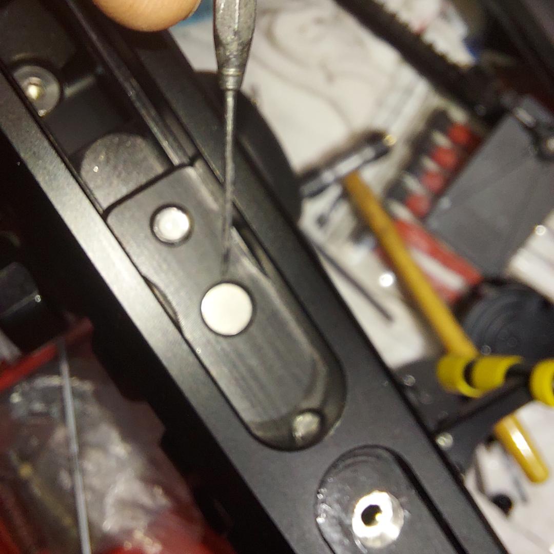

A peeve I've had since early on was the Cocking handle NOT ABLE to stay full rearward allowing magazine to come Out or be Put back in IF & WHEN the muzzle was below level or especially if pointed sharply downward. Takes two hands, one too HOLD the handle full back, Other to remove / insert the magazine.
As I looked around WHERE or HOW I could create some sort of detent for the handle, found needing to look at the overall parts in motion following the handles swing.
AH HA !!!! In removing the scope rail to expose the top side of frame and the Probe cycling rail an ingenious idea came to mind following SKOUT in there use of rare earth magnets (y)
Measuring a Hole in the end of probe cycling rail between the attachment screws to the cage that we see moving back/forth around the barrel shroud was a hole just smaller than 1/4" .... Taking a .250 reamer by hand opened up the hole a tad @ 5/32" deep so a 1/4 x 5/32 rare earth magnet would press in flush.
Next after doing some measuring of where this magnet stops when Cocking handle is full rearward, found it's location landed ideally in a machined out area of the top frame. Ok, mark it's location, and drill a pilot hole for a 8-32 counter bore tool ( @240" ) taking the hole within @ .020" of breaking threw, then open up too @ .250" we have a second spot for another rare earth magnet. Press it in and place a small drop of loc-tite 290 wicking to secure both.
Pull handle back now & we get a magnetic bump & hold having handle stay 100% at the rear of cocking stroke. Muzzle can point straight down and handle still stays open ... WOO HOO so excellent !! The magnets never touch & can't, but there strong attraction acts like a detent. The effort to cycle the handle when cocking / cycling you don't even notice. And can now load / remove magazines so much easier / faster one handed !!!!

Had forgot to mention, the hole used on the end of probe rail is for access to one of the screws holding the "basket" to lower slide rail.
If for some reason one ever took the rifle apart that far ? the magnet would need to be tapped back out from the trigger block side.
Considering factory has placed RED loc-tite on these screws, it's telling not a place expected to ever be dismantled :eek:

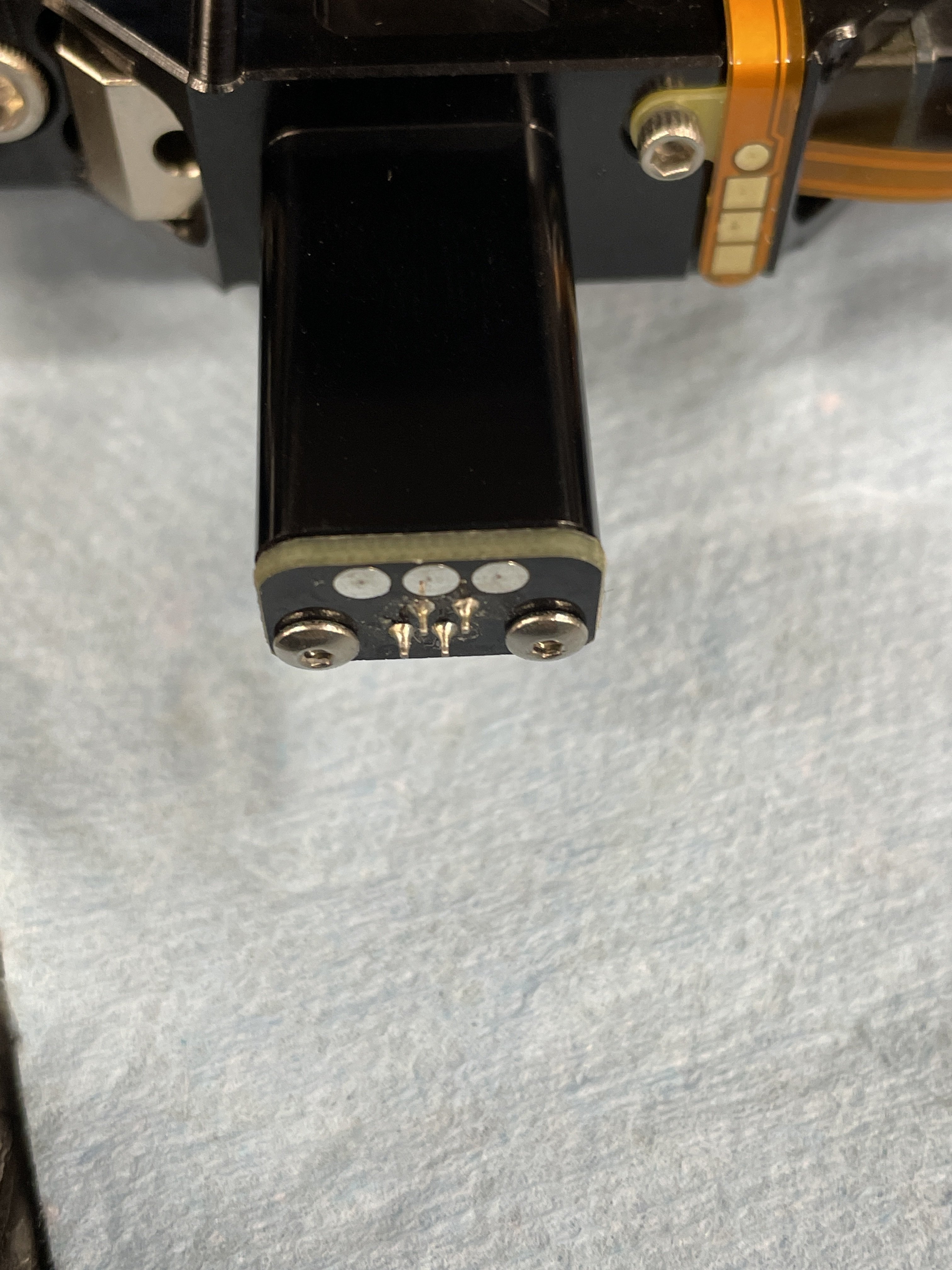

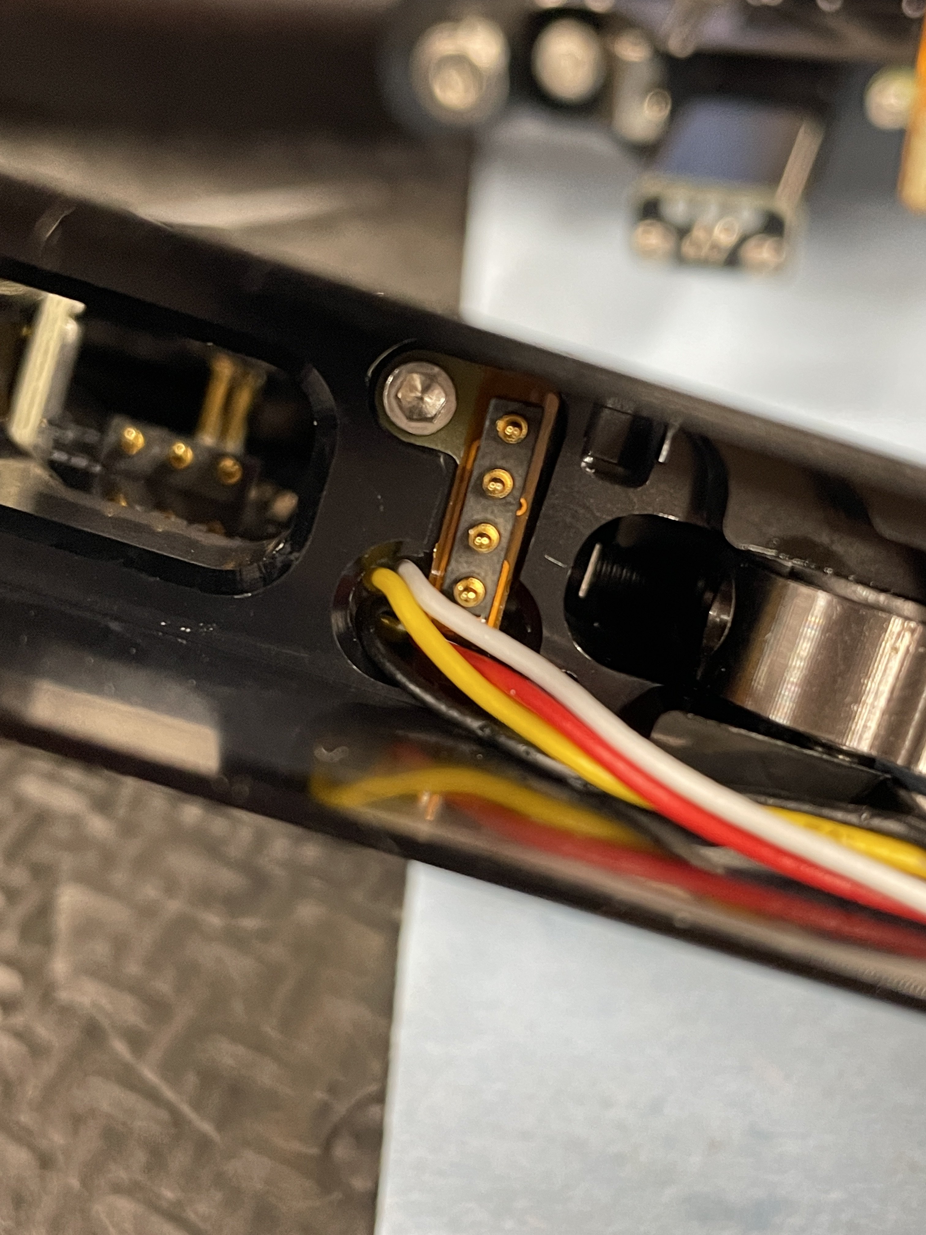

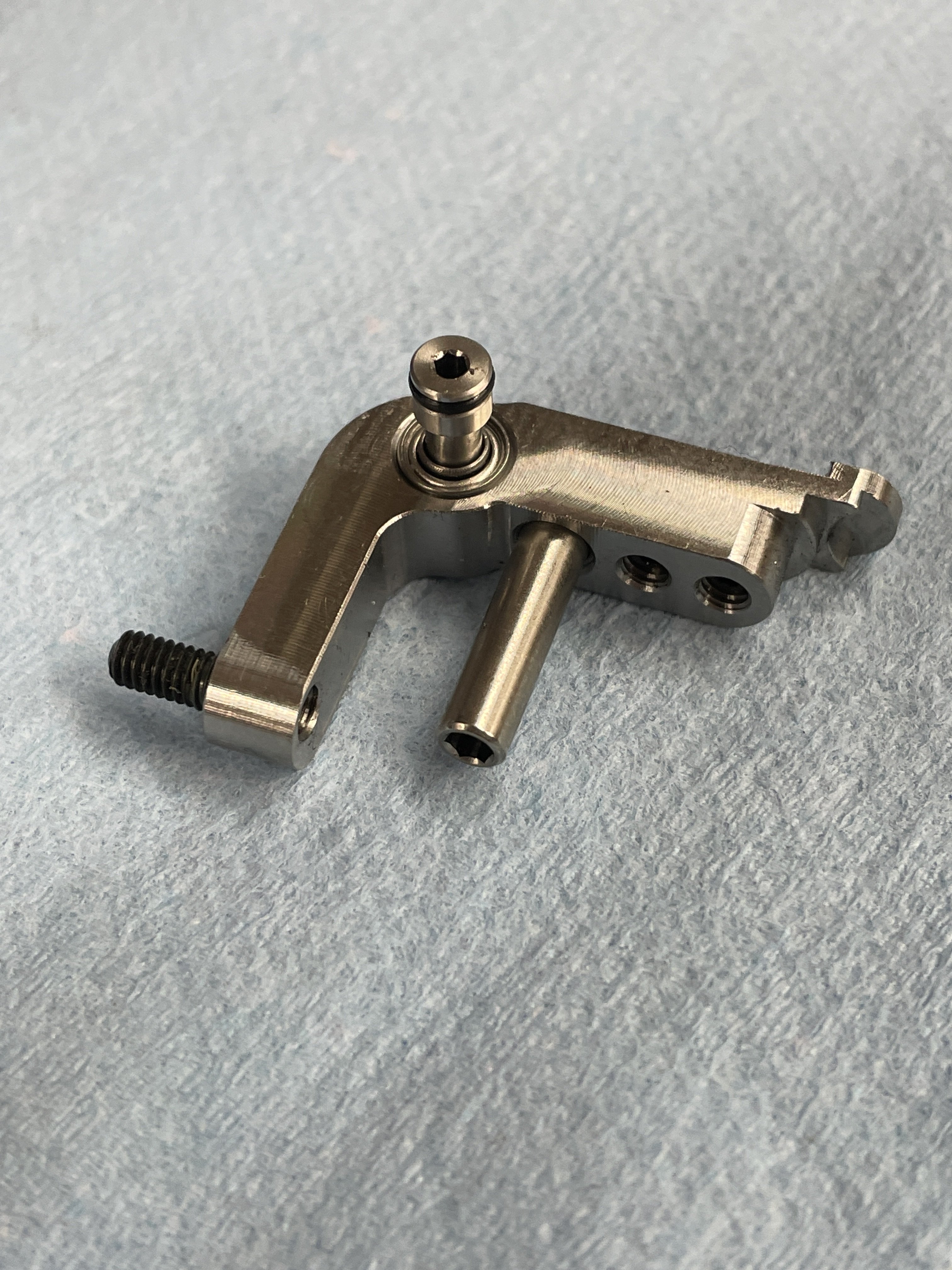

The valve dwarfs the one from my Impact.
The air passage is angled nicely.
All the electrical contacts are pogo pins at detachable points.

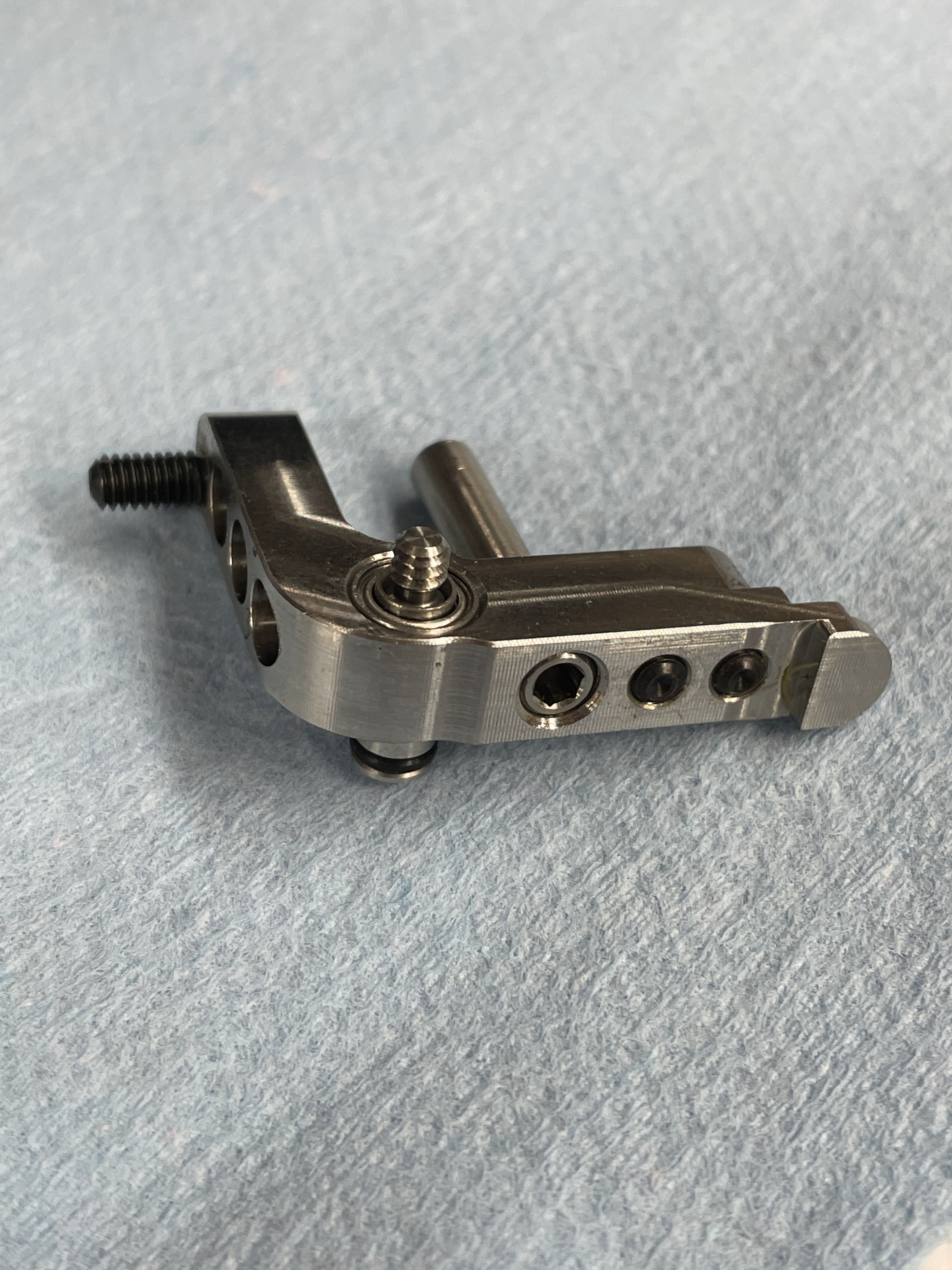

The trigger rides on bearings and uses an adjustable magnet as a return spring. I set mine to a 5 oz pull with almost no post travel LOVE IT!
View attachment 339990View attachment 339989
Only broken down to the basic components. All in all, very impressive.

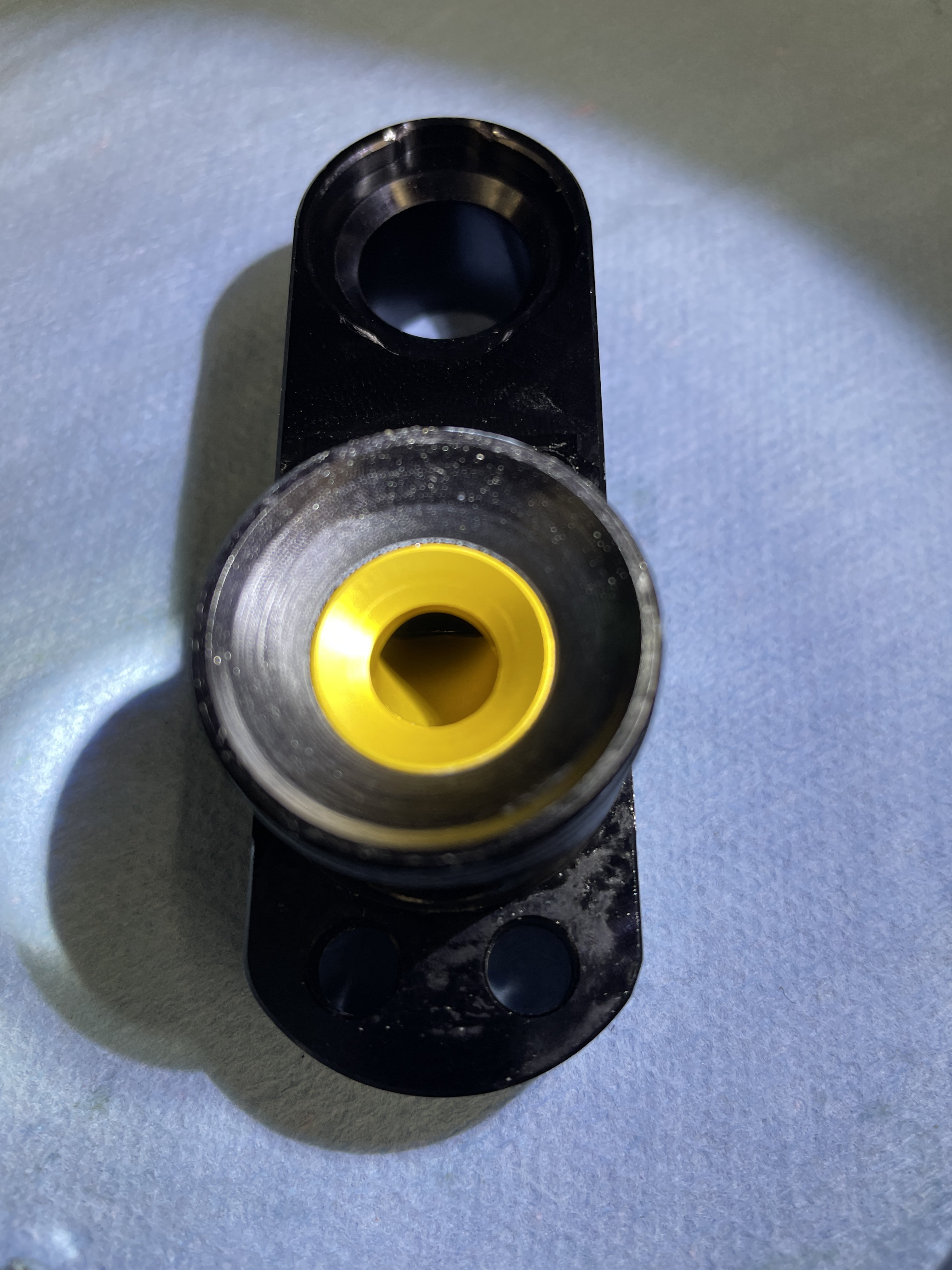

A thought had early on, that is showing to be true and may not be ideal for every location ?
Polyurethane O-rings
While there the toughest of all the materials, there one of the worst to take a shape set having poor shape retention elasticity.
In DYNAMIC locations absolutely, Static locations far better served with a Buna/N IMO :rolleyes:
Looking at above pics, one can already detect flat siding of some and pressure side shape shift on others.
This has NOTHING to do with the design or engineering ... Just that they have chosen to use pretty white / opaque Poly o-rings threw out that IMO are not the ideal choice for many of the locations.
Not so Scott, material selection is definitely the purview of the designer and engineer. Surprised you don’t realize that.

Well, being SKOUT has already come to find out ( Unlike Paint ballers ) We the PCP crowd DO NOT degas our guns. And if you had read the thread :rolleyes: you would already been educated to this and the "Why For" they are now coming with a bottle ON/OFF valve exactly for this reason. The poly rings in the Dynamic locations which is great for wear & tear, won't like being under pressure all the time.
I'm well aware of the rifle you designed so many years ago & its exclusive use of Hard Poly rings in all the STATIC locations & rifle having NO dynamic use of o-rings outside the swinging loading gate ( being Rotation actually )
