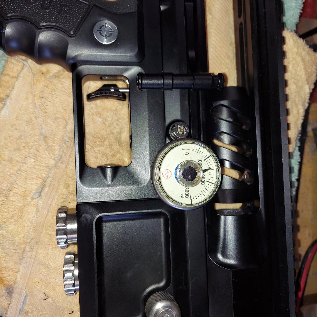

In my early pre shooting fiddling did a small clean up on the transfer thimble to semi better match the .340" transfer path & added a better gauge on HP Primary plenum / output power position.

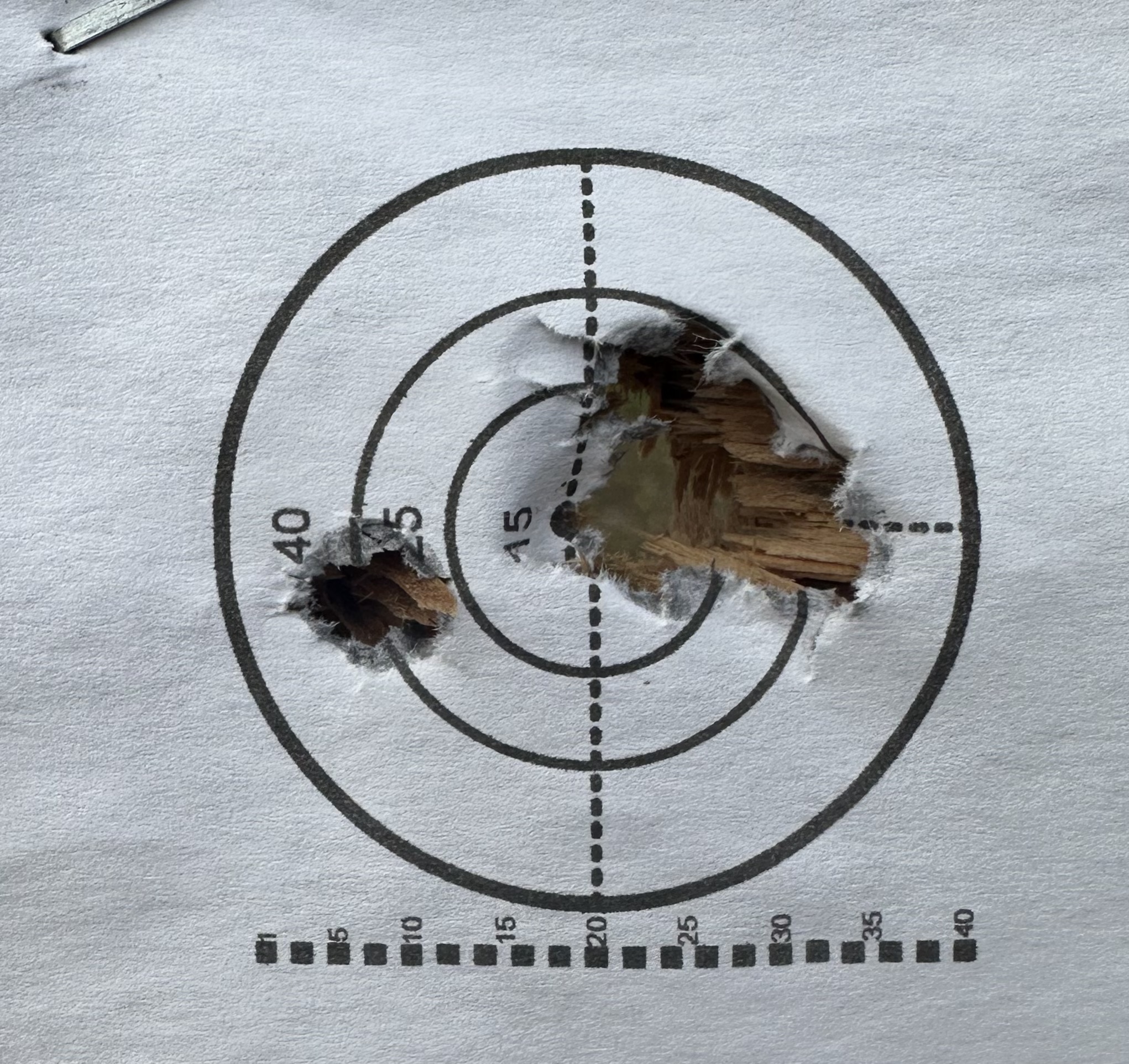

Shooting at my 80 yard marker ... stacking pellets enough to be deadly ... nothing on paper yet.

It was a screw adjustment issue on the micro switch contact / reset. Screw BEHIND the trigger blade post needed to CCW just a tad to allow switch to reset it self. Factory had it set a tad too critical. Easy enough once explained. The Digital display on grip was also showing an x or + sign stating an function error, but instructions had nothing about it ?

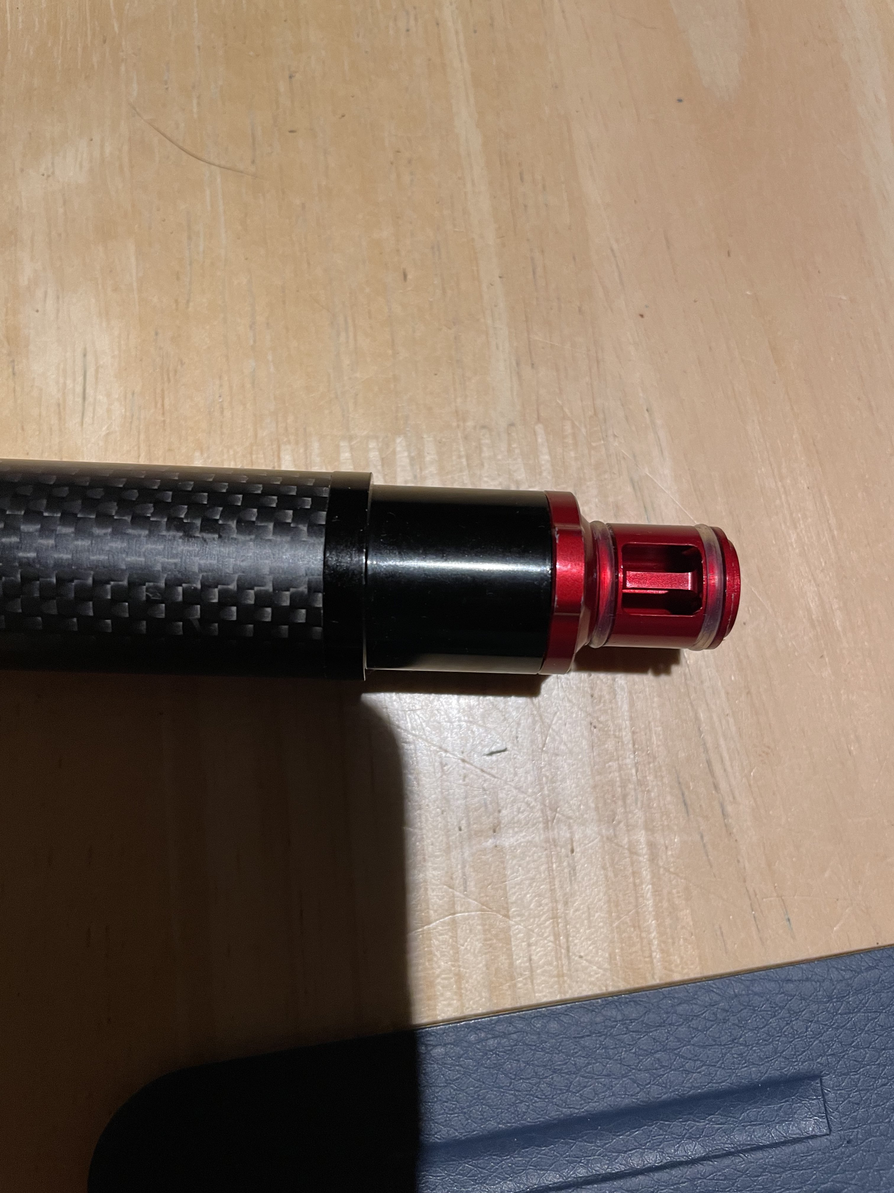

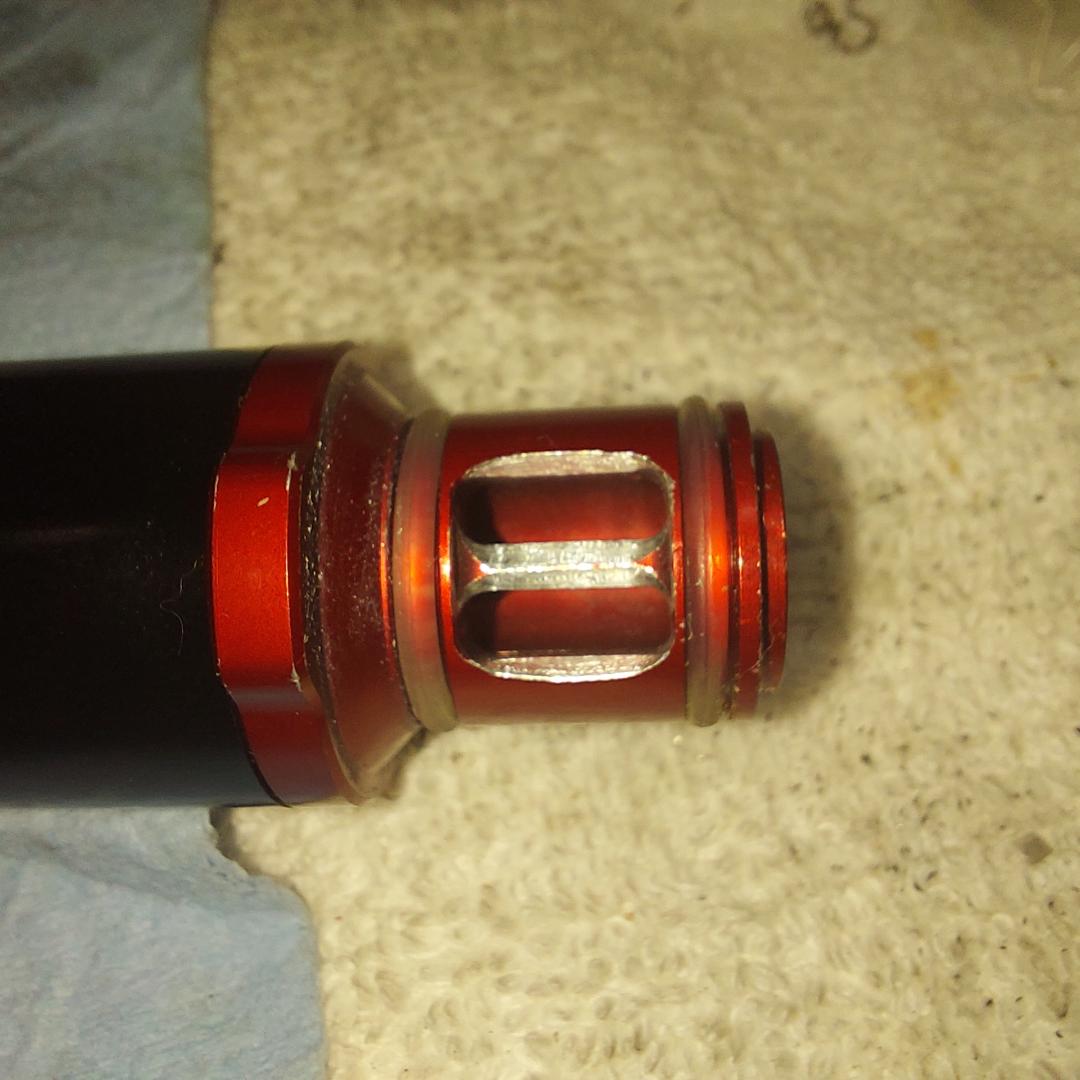

Prefabbing a Tapered transfer insert ... being a .350" to .250" tube @ .900" long.
If my hunch is correct, similar to other feed back pressure balanced valves, it won't hurt power but will speed up valve closing cycle.
It must be Glued in to not slide, but should it not pan out, removable.
3-28
@ 100 shots later, tube is staying in place. Muzzle report a tad less, air efficiency better. Winner winner chicken dinner !!
