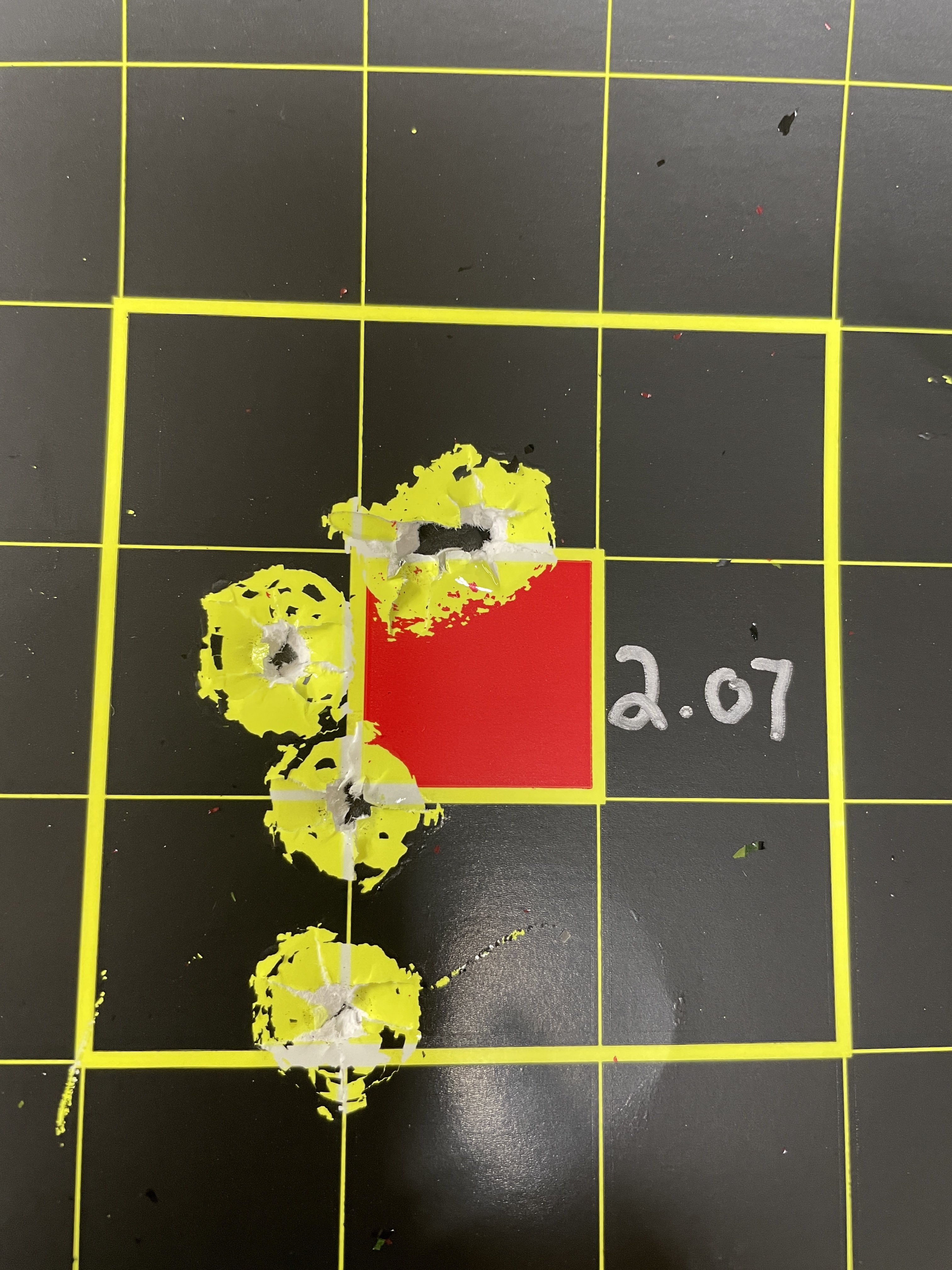

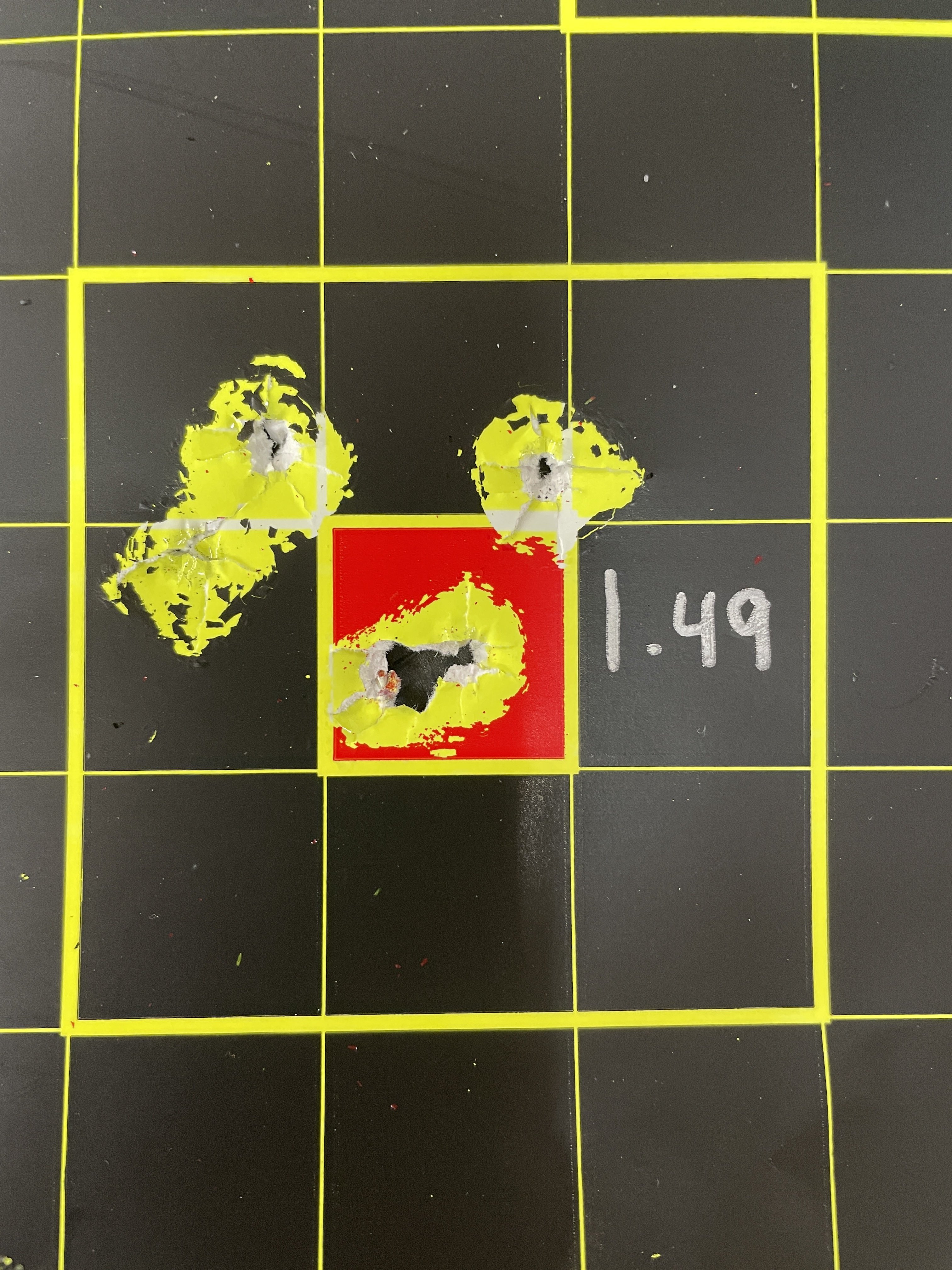

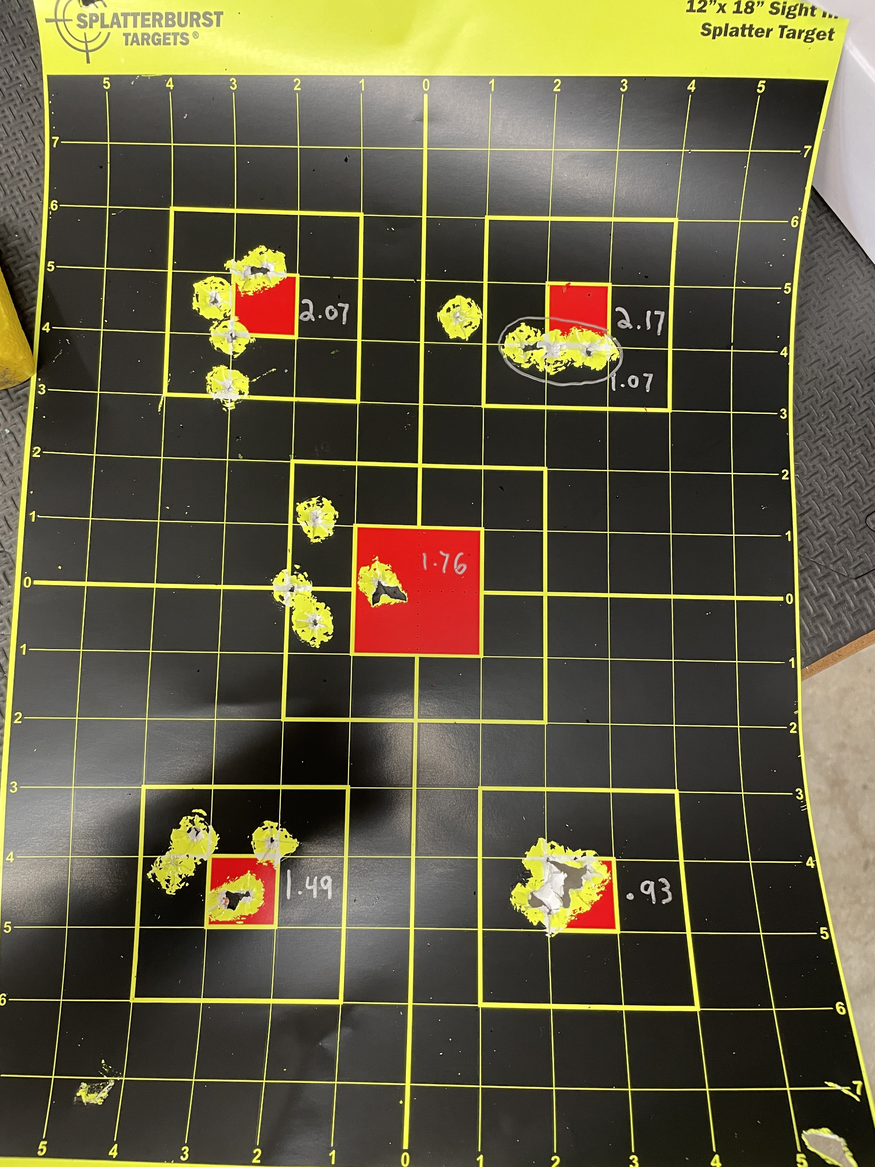

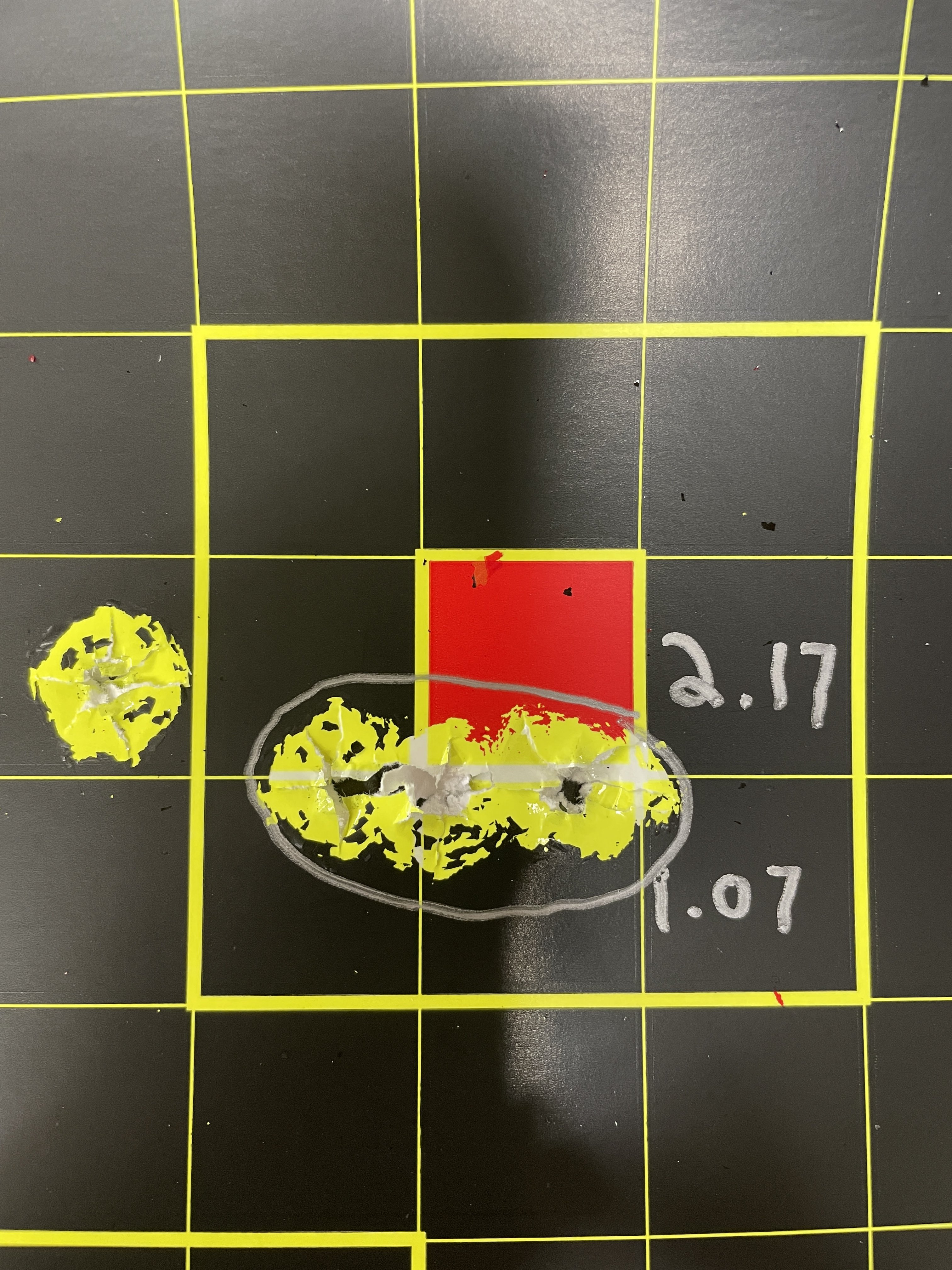

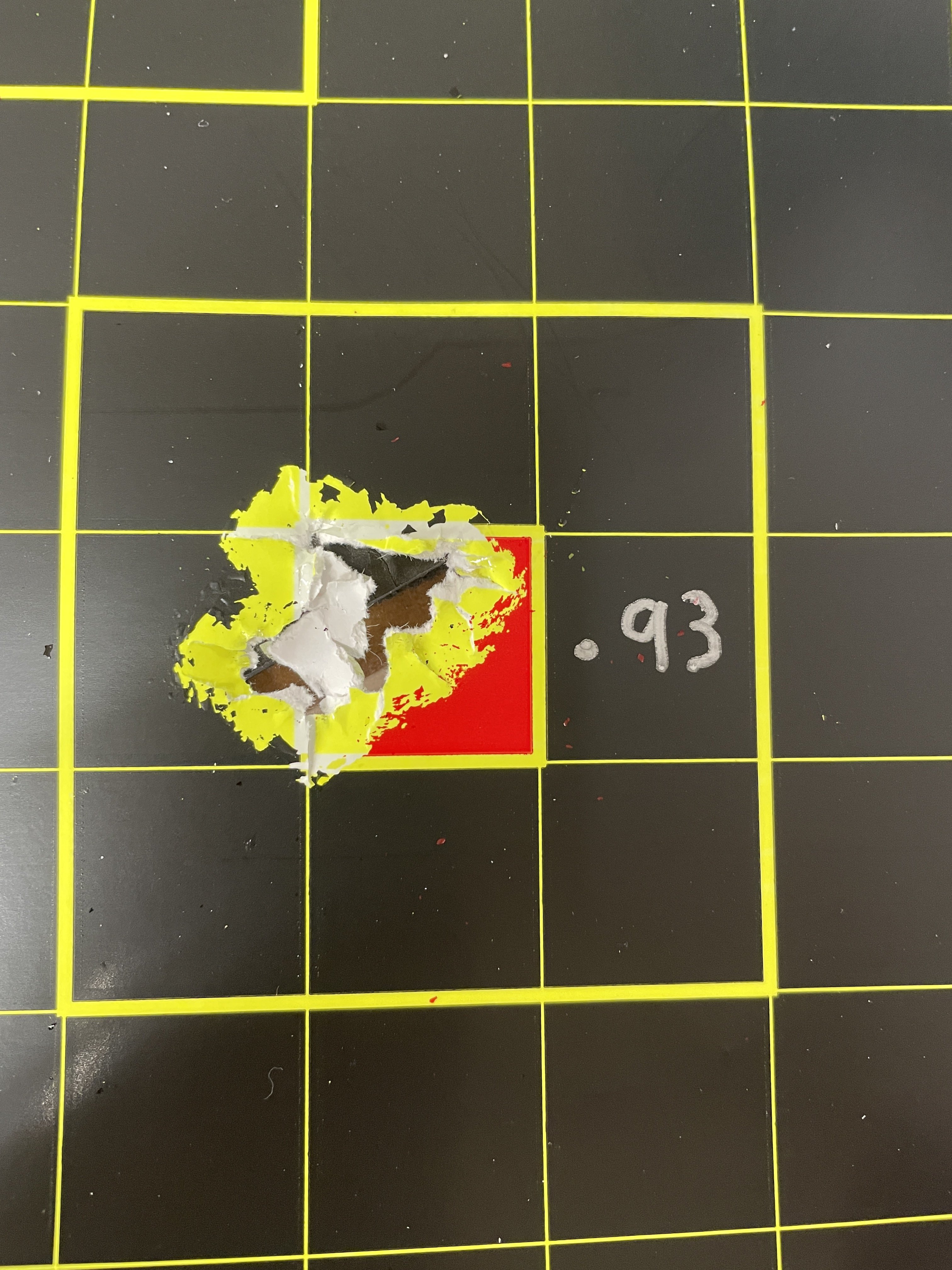

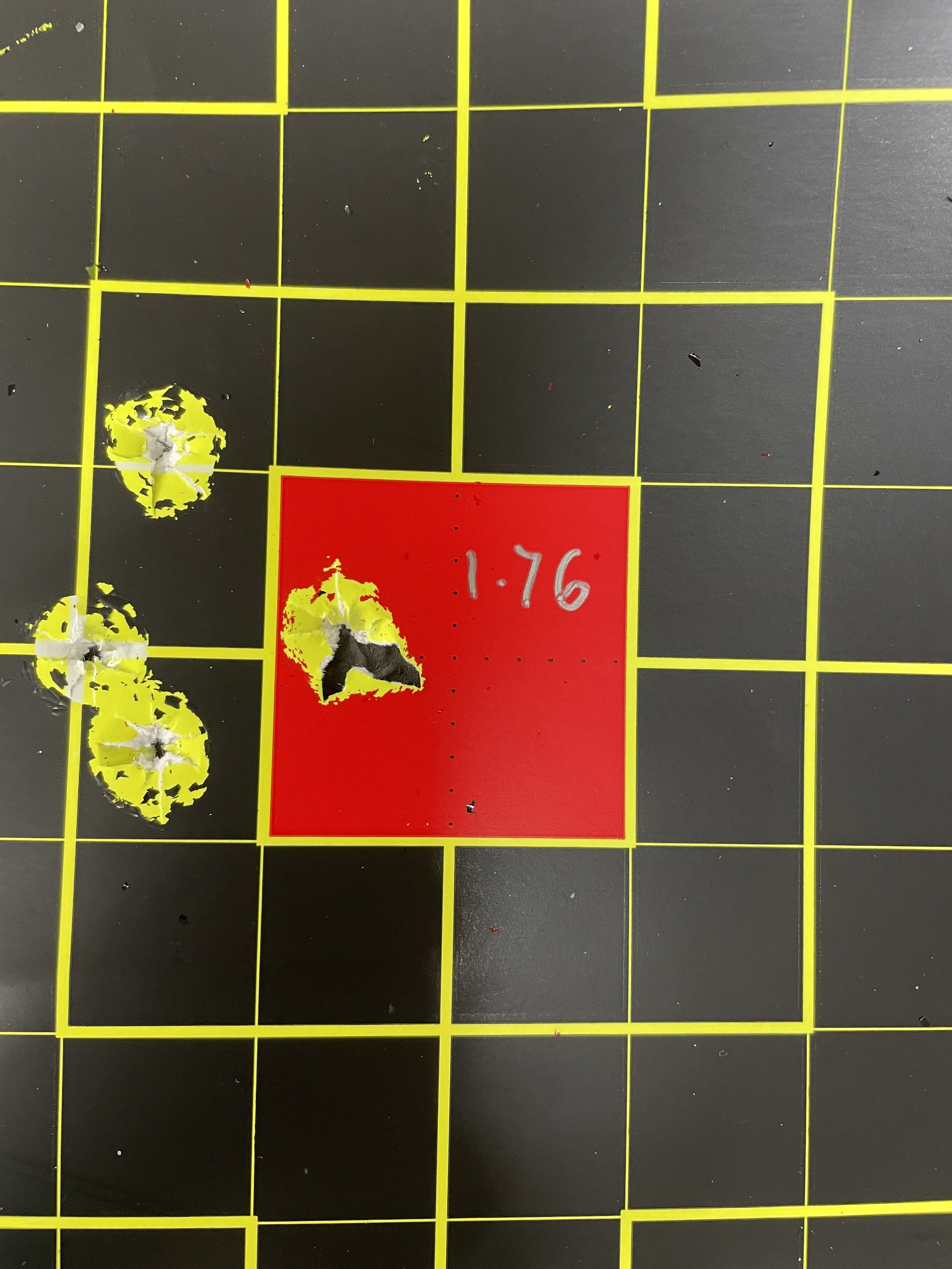

Skout Epoch .30 cal 35" (895mm) barrel.
I tried several NSA slugs and tried all three sizes of barrels. In the end I wound up very near where I started.
Best results were from the standard bore barrel.
JSB 44.75 at 900fps. Target is 1" squares.
REAL world 5 consecutive 5 shot groups at 100 yards in 3-7mph variable wind. (no holding for wind)
Just putting our experiences out there so folks can decide for themselves.
Now before folks start saying "That's nothing special" This was the best group of the day!

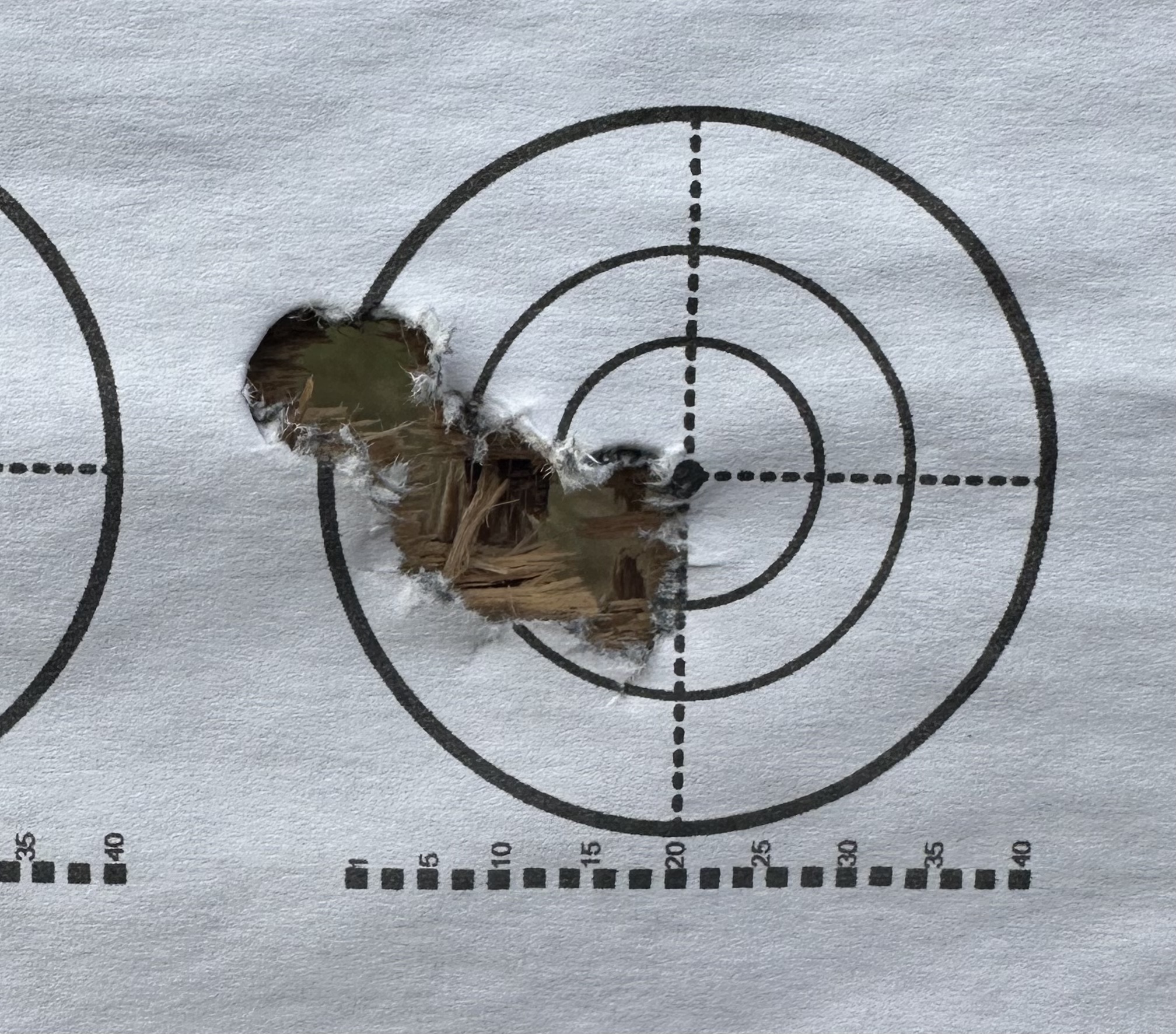

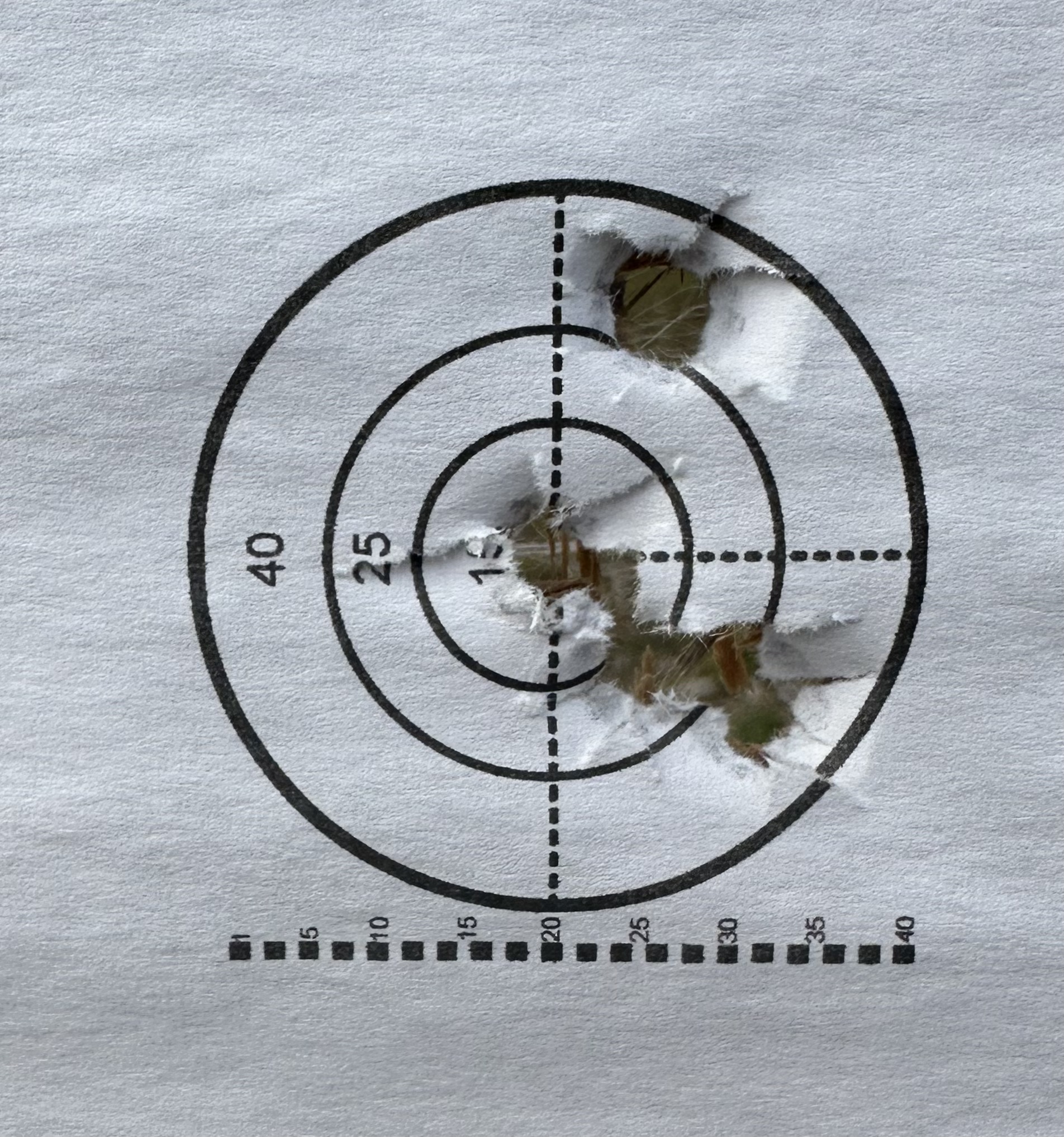

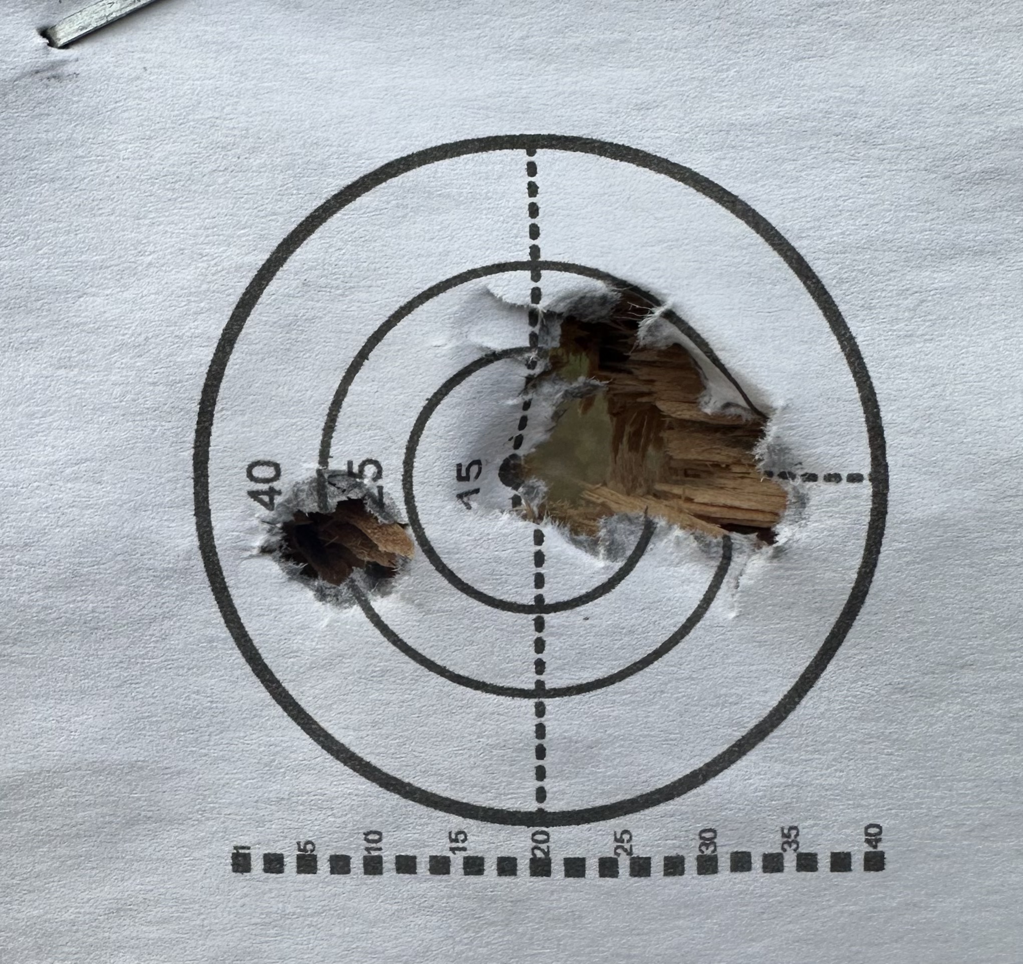

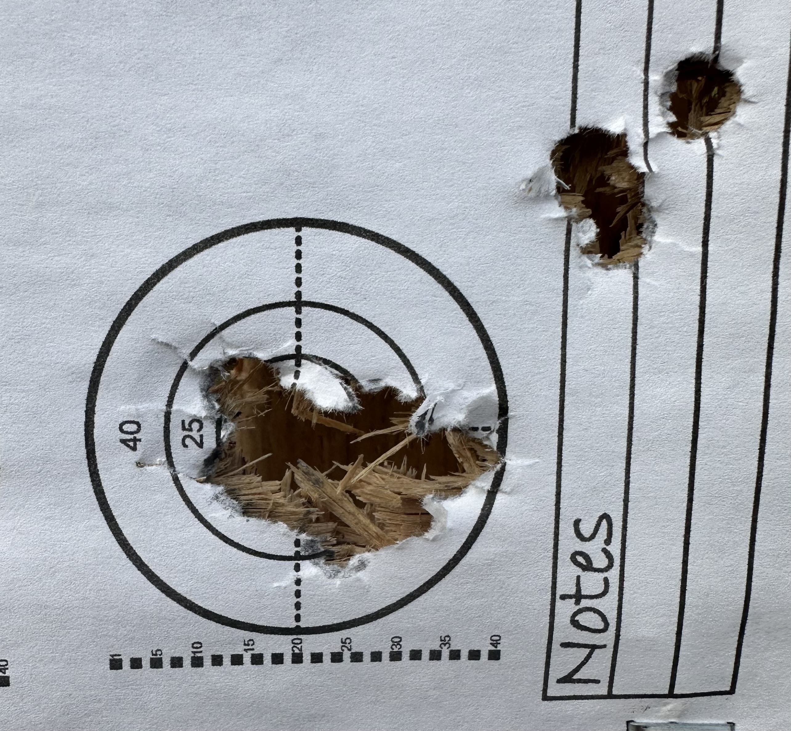

Great post Lewis! Sorry it took me so long to find! So, after talking yesterday, I got thinking, came home from work, switched from the minus barrel to the standard barrel to shoot the new pellets that have a head about .005” larger than the 44.75gr.. Since I knew it was supposed to rain all day, I went last night for a couple hours. I shot probably 20 or so, 5 shot groups at 100yds. These are the best! Sub MOA baby. (1.5” target circles.)
Have a great day.
Stoti
p.s. disregard the three in the top right of one picture. Sighters.;)
