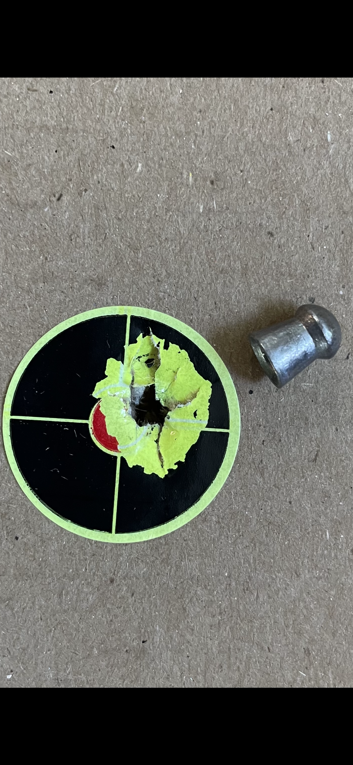

Shot these at 52 yards with the .25, both 5 shot groups. Working on 100 now…
