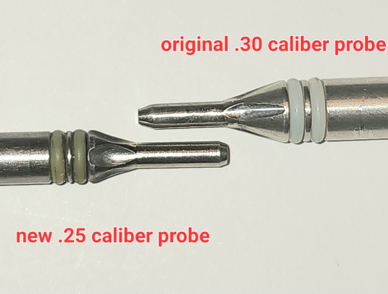

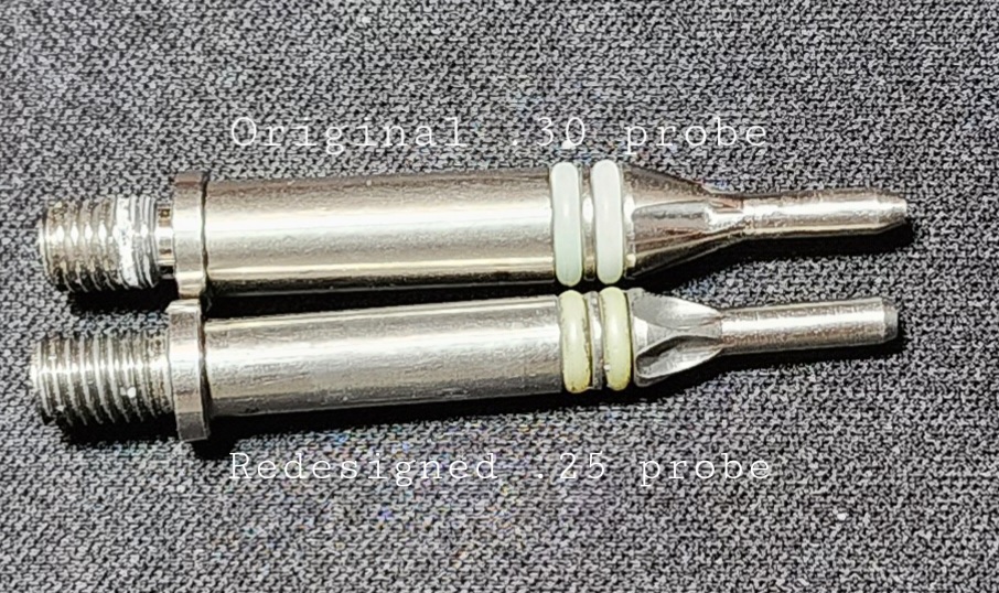

Another thing to note for early production owners is a newly machined version of the probe. These have been found to improve projectile positioning and increase consistency and efficiency. The latest shipments already have the new probe, but for early gun owners it is available. Call Skout.
below: Comparing the original .30 cal probe on top, to a redesigned .25 cal probe.

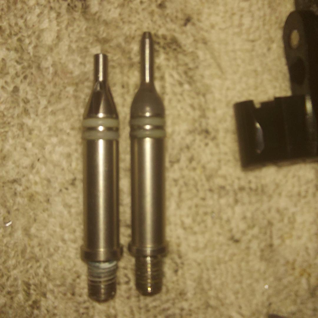

Introspect, after a long shooting session yesterday something was not right ... accuracy with pellets had faltered, yet slugs were still shooting great with the NEW PROBE installed ... W T F 🥴
An investigation today reviled the "Why For"

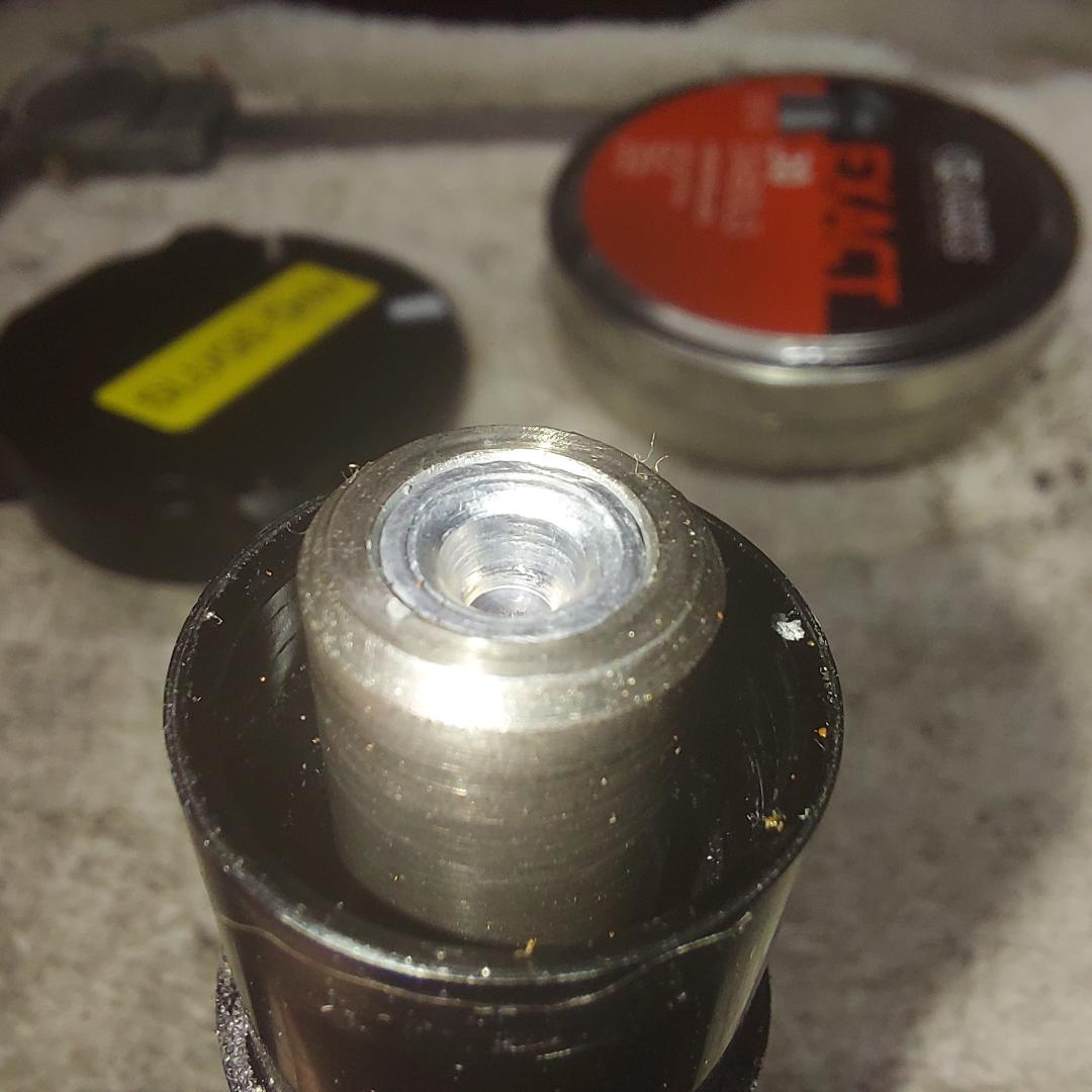

Pic 1 shows the OEM probe with longer pin ( Ignore taper mod )
Along side it the replacement probe sent
LENGTH difference @ .200" which is an ISSUE with pellets as found out. That much shorter pin and a pellet ( 44.75 ) having a tail cavity only puts the pellets head in rifling & skirt is back in the barrel thimble @ .200" When shot the pellet has to jump forward for skirt to enter barrel and does not always do so square & true because the thimble bore is @.312" and pellet is @ .300" Pellet YAW might be happening ?
Pic 2 while not perfectly lined up shows the OEM probe in behind a 44.75
Along side it the Replacement probe in behind a JSB dish base slug
*In this instance the base of both slug and pellet are about equal and would seat each at there @ required depth in barrel used with the appropriate probe.

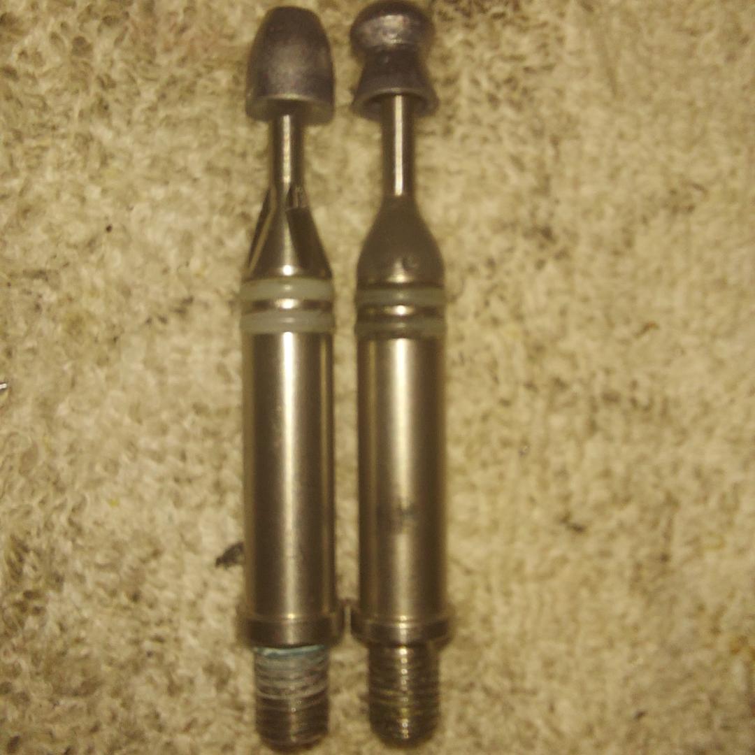

Pic 3 is a 44.75 seated with the oem probe fitted & is correct chambering (y)

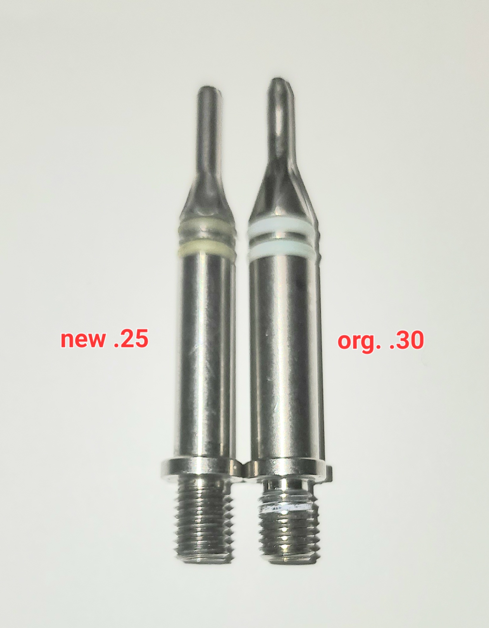

The probe length differential you're showing appears much greater than the one I have. The current thinking, as I understand it, is that both slugs and pellets need to be inserted fully to where all parts of the projectile are in contact with the throat of the barrel but short of engaging the rifling.
One thing that I have noticed is that my accuracy is VERY much affected by how clean or dirty the barrel is. I know that Skout claims that their Teflon impregnated barrels "shouldn't" require as much cleaning. However, I've found that the nature of these 10 land/grooved barrels is such that they collect a great deal MORE lead at the breach end than any of my other guns. I attribute this to the number and depth of the lands and grooves. When I notice a drop off in accuracy, I run a couple of dry patches thru the barrel (a process made very much faster and simpler by the guns ratcheting barrel lock) which immediately restores its accuracy.
I suspect that it is this build up of material at the breach end of the barrel that is causing the pellets to engage the rifling at uneven "pressures" and causing the falloff in accuracy.
My pictures are of different caliber probes, but given the difference in lengths between a .25 and a .30 pellet, perhaps the difference seen in your photos make sense.
