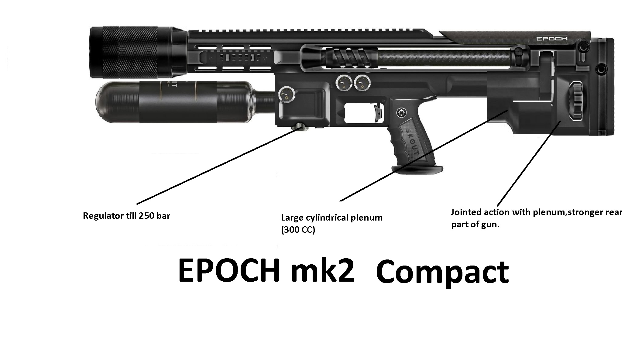

Here it is, Epoch mk2 is already out 😀

No, don't worry, i will not pollute your mail.
Remember that it is not an fx, and Huben and others showed how to reach high speed (shooting heavy slugs) long time ago, with an hammerless system like the Epoch's one, btw.
I'm sorry that i'm too ignorant to have a quite and formative discussion with you.

I have a feeling that the team from Skuot Airguns still doesn't understand what "plenum" means, so people will subsequently install plenums on such an expensive rifle, as happened with the FX Impact, only to have FX introduce a "power plenum" after many years, and Daystate was stingy and put only a 30 cc plenum with a fixed valve, which later turned out not to have enough power and efficiency in larger calibers. Skout plays the card of longer valve opening (15 ms), but later he will see his mistakes!...
It arrived in the EU, but the price is brutal
