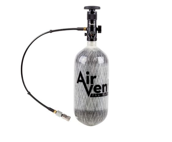

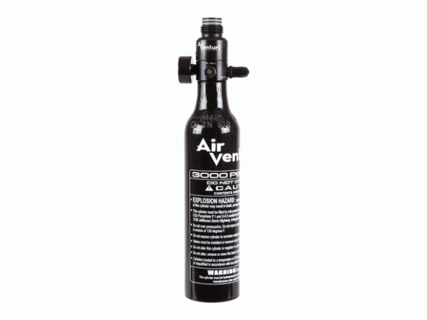

YES guys I am might be buy this tank not as big other people on here it small then the ninja tank small as scuba tank prize 79.99 this will fit in tactical back pack wont weigh it down I may can get paint ball carry belt to hold the tank that way pump the fast but I will go to paint ball gun range to fill the tank with air any one feed back not negative feed back JAN1 TO JAN 2
guy read again here the spec's
For additional shot consistency and charging convenience, you'll love converting certain CO2 guns to high-pressure air. Choose this exceptionally lightweight tank with its integrated regulator and enjoy thousands of shots from the 3,000 psi charge.
The Air Venturi 13 oz. aluminum high pressure air tank is the perfect pairing for many airguns and a common modding accessory. It's particularly useful for QB79 owners.
Please Note: This high-pressure tank must be filled through the male quick-disconnect on the neck. Before buying, please contact your local air supplier to see if they can fill this tank. Paintball stores may be able to fill your tank, so you may be able to find a fill source through them. Many fill sites may be able to fill your tank but may need an adaptor to do so.

with rights appraises and it be just like any other tank but smaller I see this size do same job but less money
1/3 the capacity will make a BIG difference on how many fills you get, how often you'll need to refill.
Go ahead buy the 13 cubic inch tank with a 3000psi fill, with a 1100psi output. Update this thread when you buy it and throw it away because its useless for your purposes.
This tank will be good for 5 shots.
all try to do try find right prize tank that was be easyer to buy and right size I need compacted not bulky if gone take out in field I need light weight and out of 3000 there are skinny
take out on mark just have right out put
Here's a tip. Make sure the tank you get it bigger and higher pressure output then the tank you are trying to fill.
This tank is 3000psi with 1100psi output and 213cc.
Bulldog tank is 3000psi and 340cc.
It would be like trying to fill a 5gal bucket with a 1/2 full 1 gallon milk jug
