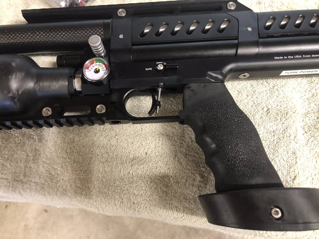

Nothing to do with accuracy, but bling!!
Did a stainless conversion on my LCS. Standard practice now especially on all black guns-
