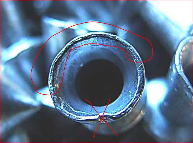

Last night I toke my highest power jewellery lupe to have a closer look at my pellets skirt. And I have seen things.
I have a question now:
It is well known that many of us re-crowning the barrels/liners and the improvements are clearly visible.
I think that is just a half job done.
What if the (casted) pellets have these uneven edges? (don't look at the dent on bottom but the upper edge is pushed out by the punch).
I understand that if you cast or swagg your own pellets, before you open the two half on the die, there is a step to shave off the rear of the skirt.
But how to fix it on existing pellets that the punch pushed out the material?
I never toke a jewellery lupe to judge the skirt edge. A bad shape is the same bad effect as a bad crown.

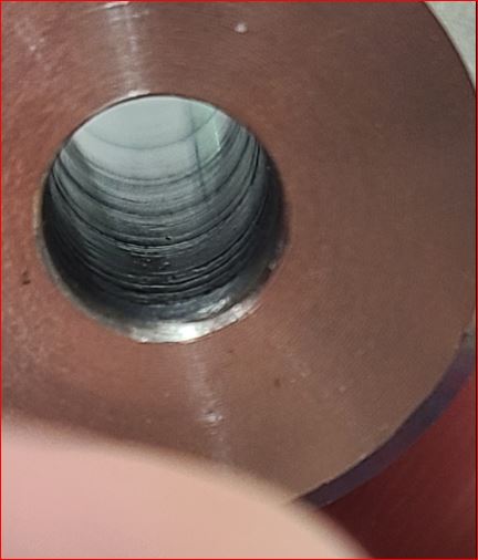

Finally I got the Trrobb pellet sizers I ordered almost 3 weeks ago. Started testing the resized pellets to my liners, both the .22 and tonight the .25 .
And I ran into some issues I never thought about it, emailed my complain back to a sender, wanna wait for he's decision.
The idea resizing the pellets with a conical hole is good, I can see the benefits. But maintaining a surface finish is tricky. A jig grinding shall be used not a lathe.
Edit:
Here is the Trrobb .25 pellet sizer conical hole magnified. These cutter marks inside creating big friction, very hard to push in the JSB 35g pellet and even harder to eject.
This is not working well with my brain. Sending back the tool is just adding more money to a postman.
I will try to fix it myself but no lathe on my own, I will have to improvise with that angle inside a cone.

I had the same problem with the .22 sizer 6 months or so ago. Sent it back for polishing and it was returned to me in the same condition.
Took it to my tool & die maker and had him polish it out properly. The problem is his tool is old and has not been sharpened lately or preferably replaced.
Works fine when smooth. Start by measuring the pellet of choice at the head and skirt. Start one pellet in from one end slowly and check every .005" depth.
This will get the head correct, Then check the skirt and see what it measures. Maybe it will be what you want. Little work, but worth it.

Thanks for letting me know, I will not waste my time sending the sizer back to UK and back to me.
I still have a protractor from twenty + years ago when I worked in a tool and die maker shop, today morning measured the pellets that I pushed through the tool. 1 degree angle between the head and skirt, that I found is steep, the pellets falling through the Leshiy2 mag the skirt didn't hold them back.
So I will order a 3 degree tapered four flute cutter (2x1,5) from a machine shop supply store, I have a micro mill and will try DIY.
I will try to fix the cone taper, and that will change the angle as well = head to skirt size ratio.

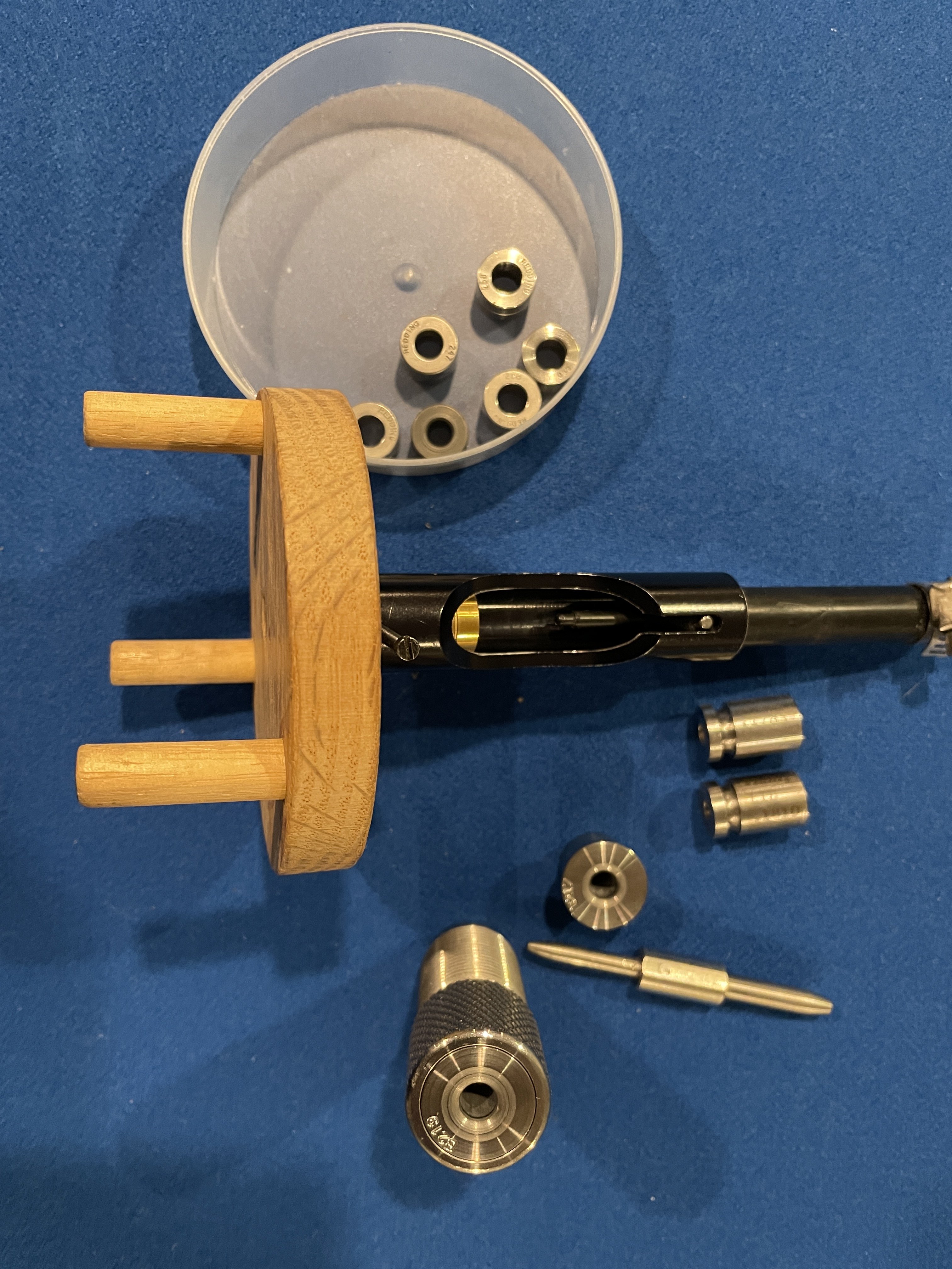

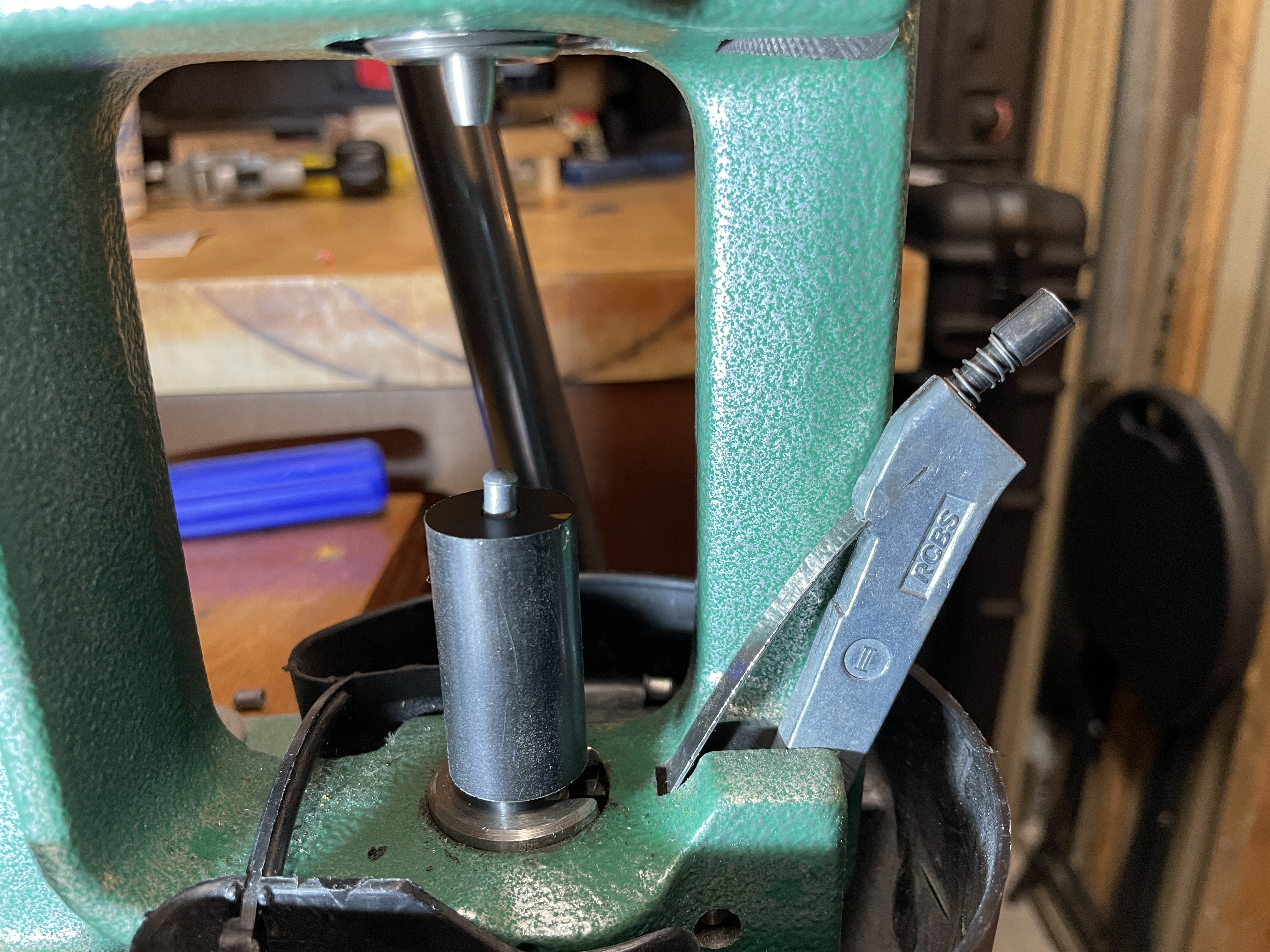

Good luck and be prepared to spend countless hrs. Making and remaking the PERFECT pellet for your rifle!
I’ve tried just about everything I know to solve this perplexing problem of inconsistency in pellets and trying to make every pellet work like that magic batch that shot light out!
Here’s some of the tools I have used and made, even a self made pellet seater I used for awhile. Some of the CF Benchrest Shooters will recognize the nk. Sizing bushings.
I even made a tool using my sizing press to expand the heads and then bring them back to what ever size I need.
Bottom line: some pellets shoot in your barrel some don’t…
