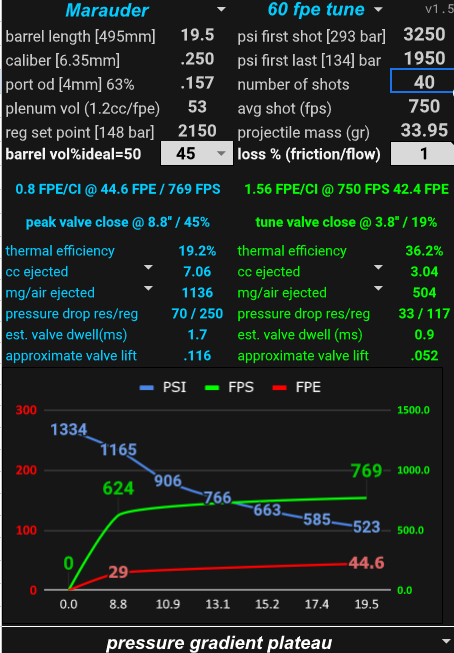

Lets take my .25 cal marauder for example, it sports a 19.5" barrel, .225" ports and 53 cc plenum @ 2100~ psi. All the graphs shown are with 33.9 gr.
What happens with various barrel lengths at plateau power? Well for one, if you chop the Marauder barrel in half, it will output basically half the energy, if you double the barrel, it would nearly double the energy, with the right weight projectile, or if you add 10% barrel length, you will add nearly 10% energy potential to the system. This wouldn't come for free, and you would need to dwell and keep the valve open nearly twice as long to get twice the air into a system with twice the barrel of course to obtain twice the energy...
So when someone asks, how many fps will 1" of barrel add? Well that depends on your existing barrel length! For a 10" barrel, 10% FPE, for a 20" barrel, 5% FPE, then you can determine your velocity/fps increase based on that. Clearly adding 1" to a 6" barrel increases FPS a lot more than adding 1" to a 28" barrel.
What happens with various port sizes? Well if I half my port size from .225 down to .1125, I would get half the power at plateau...same applies in reverse, you double power output. 10% increase/decrease should relate closely to a 10% change in energy. Likewise you would use more air as power increases, or less as it decreases at plateau as you're expending more or less appreciable air behind the pellet before it exits the muzzle, provided you adjust your hammer strike. Largest port possible closest to bore diameter allows the shortest dwell time possible in a system as the lift generated to expel for example 1000 mg of air through a .25" equal port for a .25 cal takes less time than that of a .2" equal port or less, thereby increasing dwell time / the pressure pulse making it less efficient than a system with larger porting closer to bore diameter.

I appreciate the effort, but I'm curious about the math - in all cases of barrel length, port size, and pressure, you state that half the size is half the power, and I'm sure that not is true. It is not linear, so at a minimum it matters where you start.
Also, on the port sizing, you report half the diameter as half the size, and that is incorrect - half the diameter is only half the diameter, not half the area as the area is "Pi R Squared" - half the area of 0.225 would be about 0.159, not 0.1125 inches in diameter.
I get and appreciate the intent, but some of the specifics might need tweaking . . .
True, because the weight of the air filling a longer barrel to accelerate the projectile is itself an added weight that must be accelerated. Analogous to the rocket problem...more fuel is necessary to carry a rocket to a greater altitude, but the fuel adds weight which offsets the benefit.
So it would be true that the gains from a longer barrel will not scale linearly at the same state of tune, but I suspect Matt is describing what is possible if you increase dwell to shove more air into the barrel.
You're actually right in the port sizing, it was late last night and I forgot to correct for surface area opposed to diameter alone. .159 is half the surface area of .225, and half the flow rate which would result in half the power, or half the mass ejected! I will correct the post to reflect this. (***EDIT***)
Oddly in my tests however, its closer to how I have orginally, so I will not edit it. Stock marauder valve was .14" ported and could do way over half the power of what I have at .225....but if I restricted it to .1125, it does closer to half the power of .225.
@ .157" porting at 2100 psi the marauder did well over 40 fpe, and at .225 porting 63 fpe.
RIDDLE ME THAT!
Barrel size being halved will result in half the potential energy in the system, with factors such as approaching the speed of sound and friction aside. In its simple form, a 10" barrel will make half the power of a 20" barrel if you tune to keep the valve open till the pellet reaches the end of the barrel.
For barrel length, I made it abundantly clear you're increasing energy potential of the system and more dwell is necessary...the issue will only come once you approach the speed of sound or are overcome by inability to keep your valve open long enough due valve design (non blow open calculated dump)....the closer you approach the speed of sound, is when the equation makes large changes. Also the first few inches but I don't see people building pcp's with 1-3" barrels...so for all purposes this 'rule of thumb' applies...
Also raising pellet weight to avoid speed of sound will greatly keep the linearity of growth going until...you hit the physical limits of reasonable projectile length in that caliber...which I made clear as well to some degree, but it was late and honestly I hit 'save'/'post' before I was even ready to and just let it ride...
I want to make it clear, I am here showing various changes to each variable that determines energy output of a pcp, and how relatively linear some of these variables are, when used within our scope.
That is to say, plenum volume changes, pellet weight changes, regulator refresh rate change, and most importantly caliber changes are far from comparable in near linear growth, as I have demonstrated... the linearity falls off on either extreme for pressure and barrel length, but that doesn't dismiss that in the Goldilocks zone we operate, there is a fair amount of linearity going in either direction when changing barrel or pressure. Reducing 10% of your set point will very much result in nearly 10% energy loss just as chopping off 10% of your barrel would, however adding 10% more plenum will not result in 10% power increase, no where close...
To get 10% more power from plenum you would have to increase the pressure your plenum can maintain on average through the cycle by 10%, which is an entirely different equation that depends on your air mass released, plenum volume, ect, that can't be simplified...but for example, to reduce my power 10% alone with plenum, I would have to reduce my plenum volume from 53 cc to 27cc, and if I wanted to take it down 10% again from 27 cc, I'd have to go down closer to 17cc which is less than half...and another 10%, down to 13cc plenum which brings it to 45 fpe, and again much less than half plenum to achieve 10% drop...and now I'm rambling.
