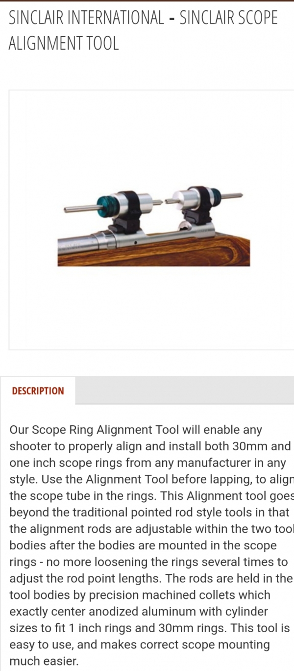

Anyone use this or the machined rods with points on them? I could see it showing that factory tap and drilled mounts may be off as mass produced things are at times. Yet, wouldn't the fact that the tube is stiff overcome at least the very smallest differences between the two spaces? It looks like a neat thing to try to show just how true mounts and rings are, maybe test a $10 set VS a SportsMatch?
