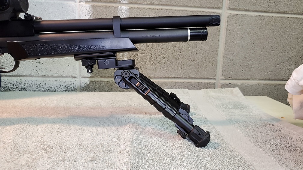

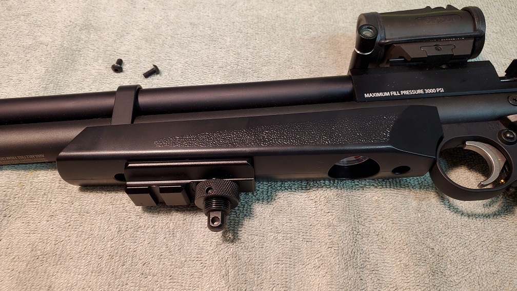

This is a quick upgrade to your Prod that offers great flexibility to an already great platform for under $85!!!
What you need for tools is not much.
How.

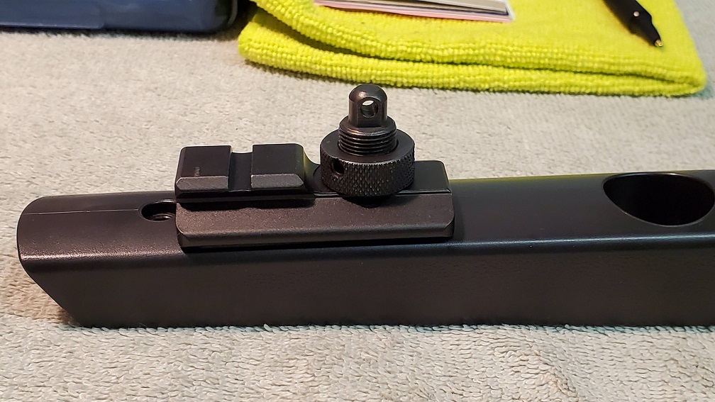

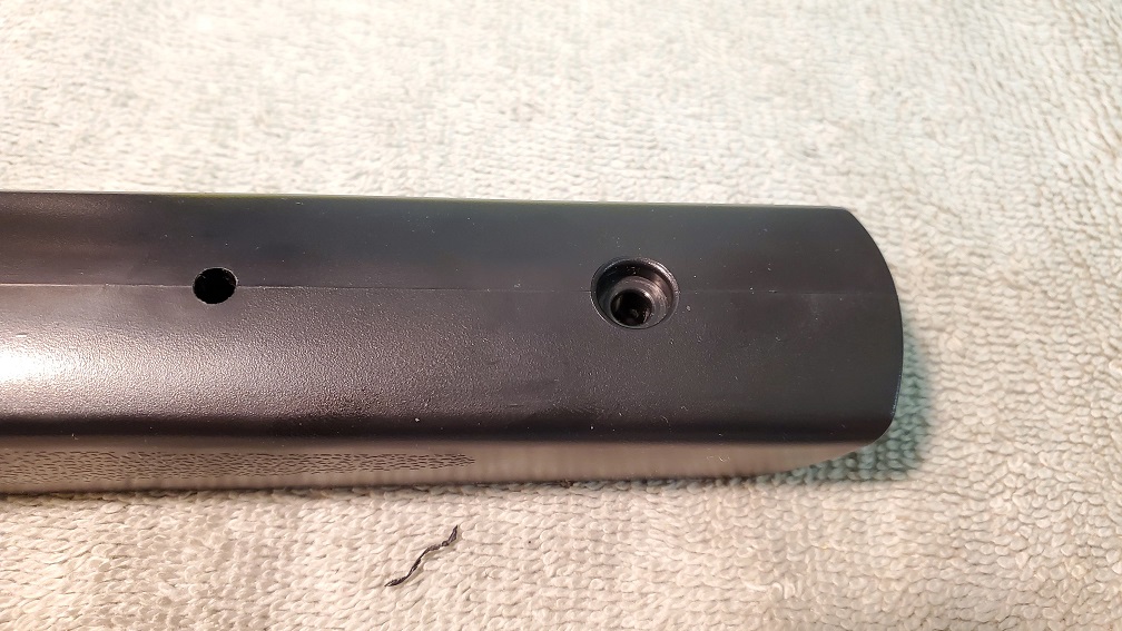

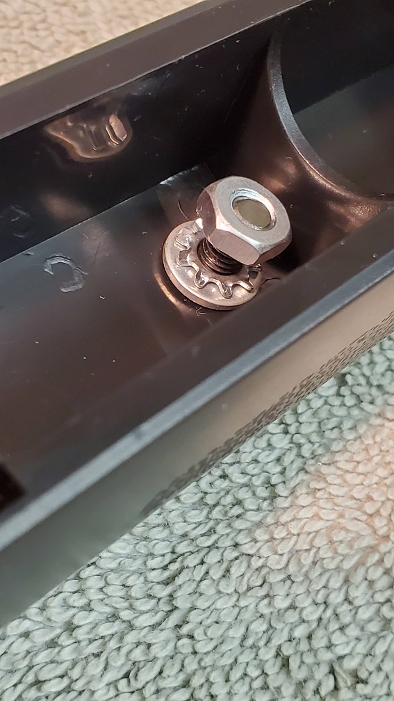

Measure your mount the way you want it positioned on your forearm and mark it with a dot in the center of the rail mount. I put mine as far forward as the stock screw would allow.
After drilling I add a bit of blue Loctite to the Sling mount screw and nut to set it solidly in place.
Easy Peasy. Have fun.

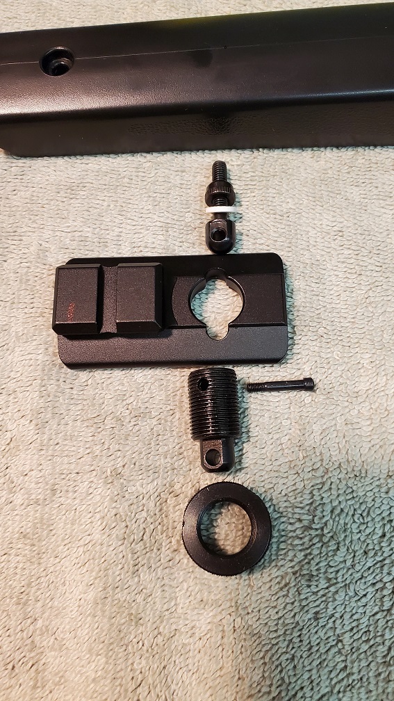

- Sling mount kit $7 https://amazon.com/gp/product/B073PMP3D1/ref=ppx_yo_dt_b_asin_title_o00_s00?ie=UTF8&psc=1
- UTG Swivel stud Picatinny kit $9 https://amazon.com/gp/product/B0053EQNA4/ref=ppx_yo_dt_b_asin_title_o01_s00?ie=UTF8&psc=1
- UTG Recon 360 $50 https://amazon.com/gp/product/B00Z9JTFJE/ref=ppx_yo_dt_b_asin_title_o03_s00?ie=UTF8&psc=1
- Sling of your choice. They can be had for under $15

- Drill

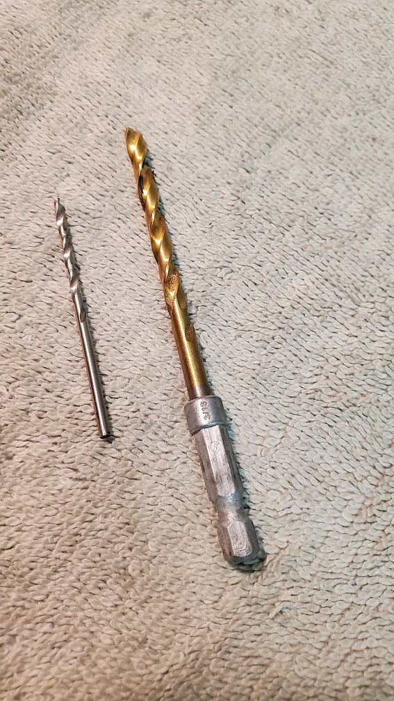

- Pilot drill and a 3/16 bit to finish
- Dremel to cut the Sling Stud. Or a ???

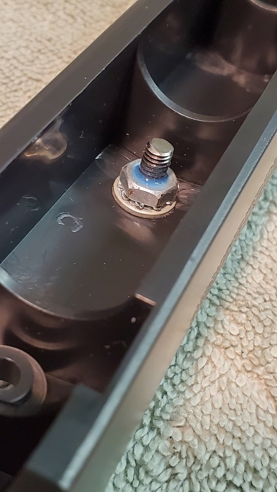

- 3/8 nut, washer and lock washer.
- Loctite.
- Pliers and screwdriver.
- 3/8 socket.
How.
