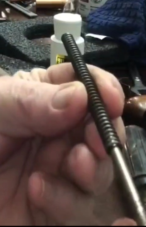

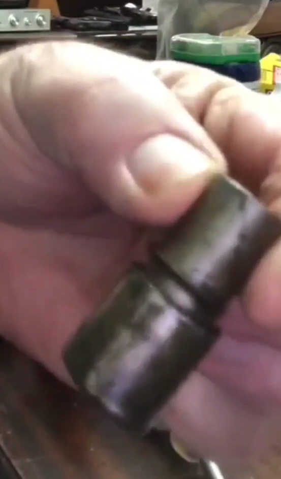

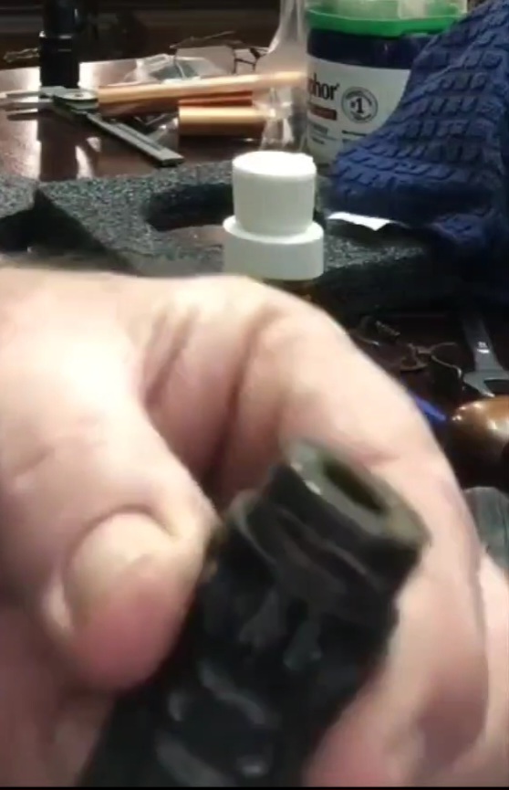

The trigger plug has a hole in it, and I think the hammer does as well. The spring has a spring guide that should prevent the spring from dislodging out of those holes?

If the hammer spring and the guide inside the spring were to get dislodged it would have that effect. I just don't know if that is even possible, because I believe that the spring and guide are longer than the space between the plug and the hammer, fitting into the holes in them.
