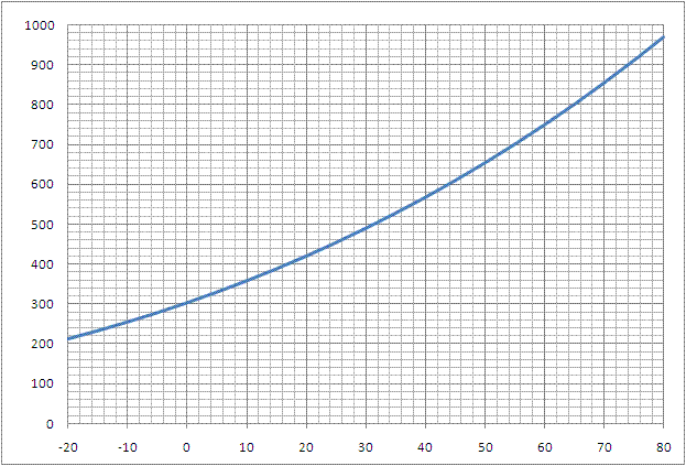

PG oil is flammable and not to be use in High pressure areas, good for lube on moving parts outside of High pressure areas, Silicone oil is nonflammable in High pressure areas and good for lubing seals in the High pressure chambers of the gun, Use Silicone oil in PCP High pressure system such as the fill hose adapters and fill probes, also good to lube the fill port valve, I use 5-10 drops every 10 fills to keep the O-rings lubed, I use gun oil on moving parts outside the pressurized system like the hammer, bolt and side lever mechanism
^ That. Here's a chart that show the temps and pressures.
