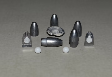

Something like these? Not perfected yet but really close to his goal of long range accuracy.
The above are Griffin .25 RBT slugs that are almost 50 grains with ballistic tips. Mike has 4-4.5mm perfectly round Delrin hollow spheres that can displace 5-7 grains of lead as they weigh 0.9 grains and act as pistons. He’s gotten reports of high power slugs being stopped by an apple at 60 yards with full disintegration & full energy dump.

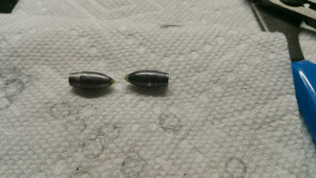

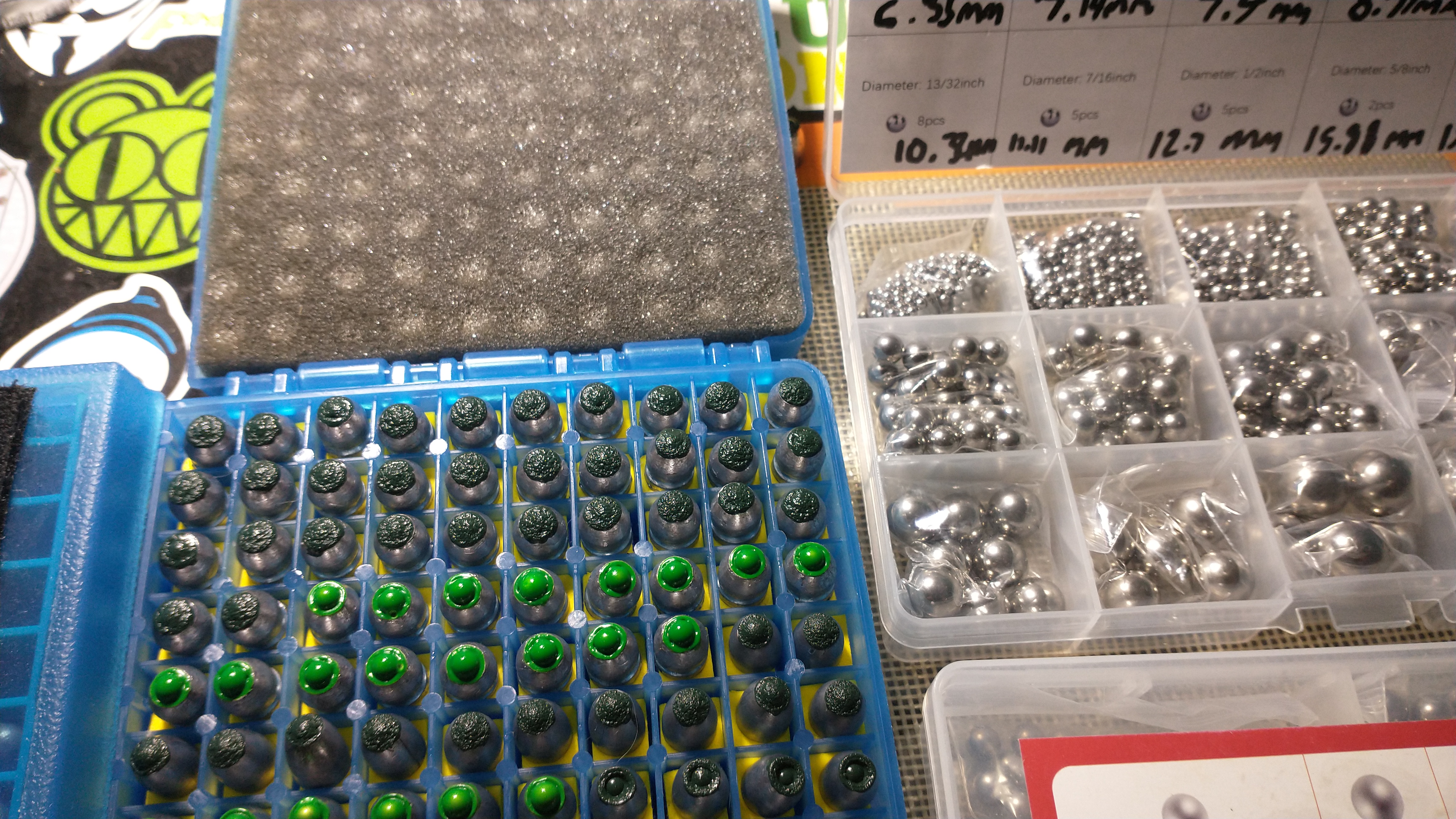

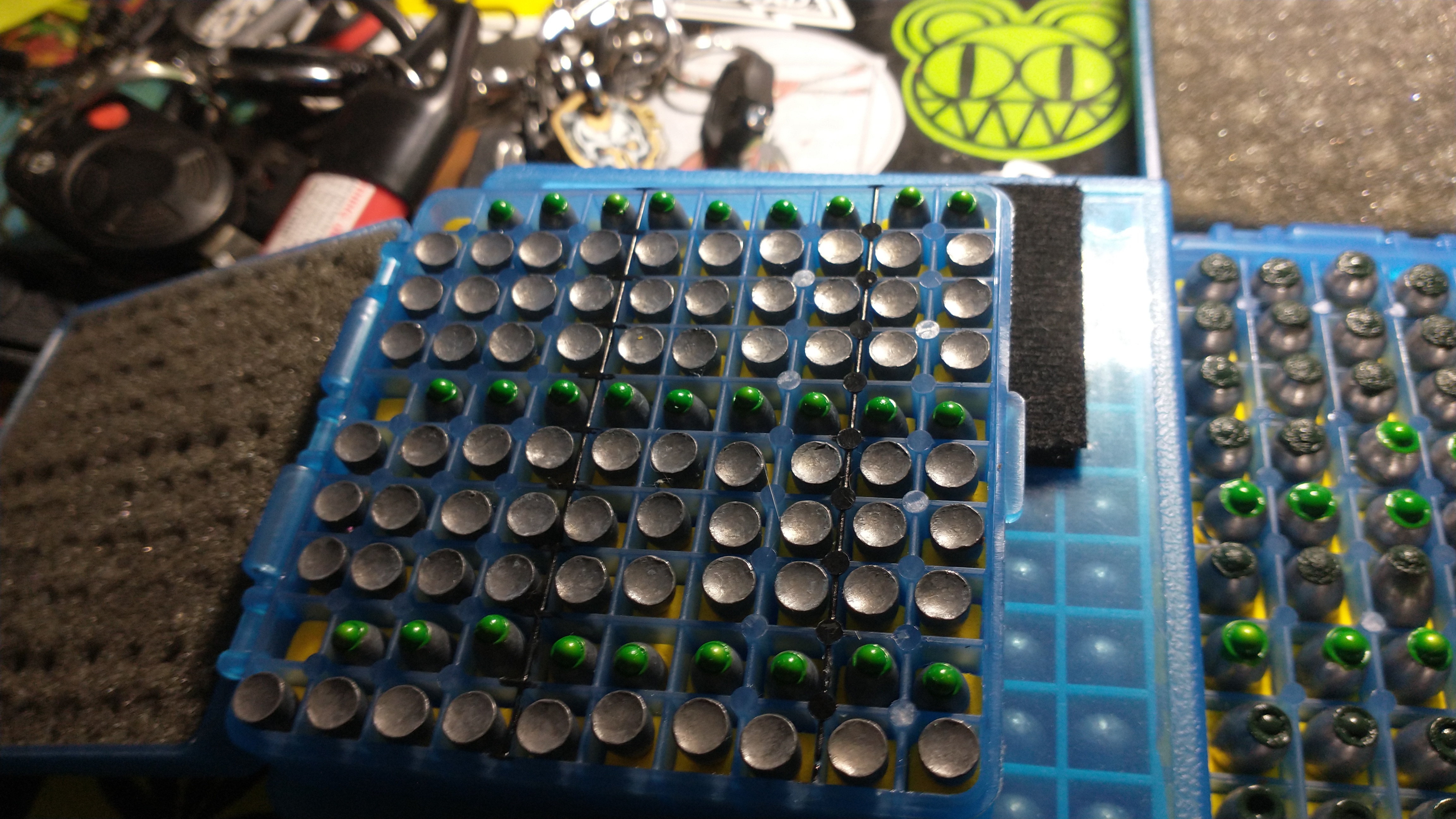

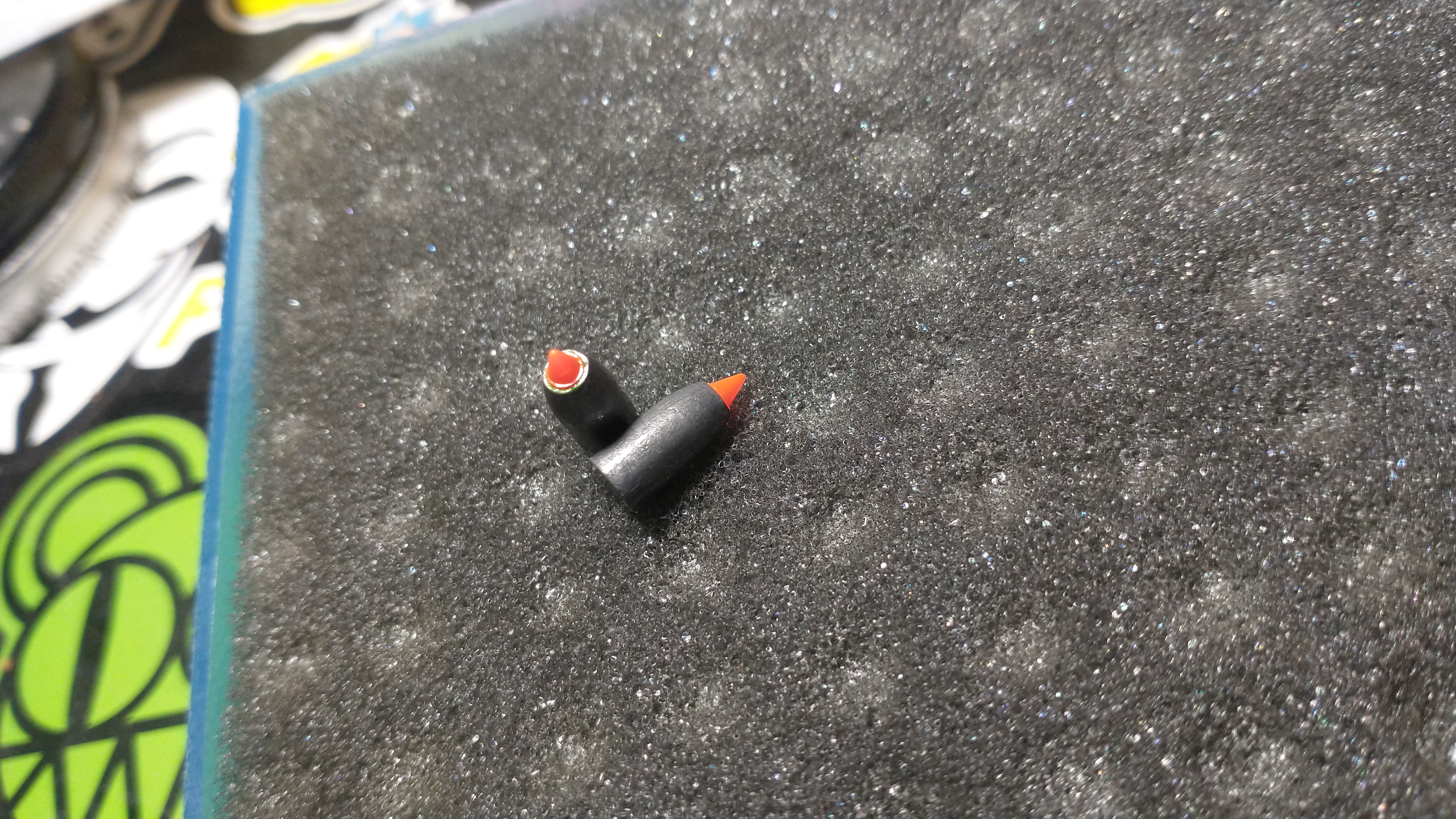

My thinking behind the “SOFT” tip of a silicone tipped pellet is more for Hydraulic Expansion rather than higher BCs. The polymer tip is hard and in my mind does not cause expansion unless it meets with something like bone or something as equally hard. The silicone is so very soft and flexible and being of a more fluid state than a hard piece of plastic, tends to provide a easier force to manipulate the soft lead hollow point to expand at lower speeds and not to clog up with hair or feathers. I didn’t make these sort silicone tipped pellets for longer distances because I don’t shoot that far when hunting or doing pest control. It was an fun idea that has helped pass the time on cold winter days when I would much rather be out shooting and not stuck in the house. They work well for pesting and hunting and I just wanted to share the idea with y’all. I emailed JSB and some other pellet manufactures about the idea hoping they would professionally make them as another pellet option for all shooters. Wether they do or not is up in the air. I think they assume I am after money...I’m not. I just want more and better options for pellets selection which is why most of the airguns I own are in .22 caliber. Pellet choice particularly a large pellet choice is nice and gives us lots of options. That’s what it all boils down to. I sent some of my pellets out to Orion the iguana Hunter in FL for his .25 cal Priest2 and .22 caliber Liberty. The .25 had to be drilled with a 9/64 drill bit 1/8” deep and filled with blue RTV, the .22, I just used stock Daisy Hollow Points and filled them with RTV...simple and anyone can do it. Nobody will pay for an idea that everyone can do themselves. As I said earlier, it isn’t about making money. It’s about a broader choice of projectiles and having fun. After all that’s why we shoot airguns right...to have fun and relax. If airgunning for me turned into work, I wouldn’t want to do it as much and that for me would suck big time to give up something I have a deep passion for. As far as using wax...it may work and maybe even better...I don’t know, never tried it because I think the wax would get gouged or damaged, and if I would use a harder form it would be like the super soft and pliable silicone. Plastic for me is too hard for the speed I shoot i think and won’t perform the same or as good as the RTV silcone.
