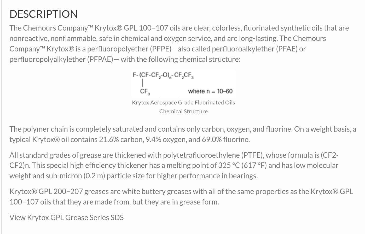

For your needs with static o-rings, a bit of SuperLube or any pure silicone grease from the hardware store will work just fine. Even a small foil packet of spark plug grease will work great if used correctly. It's when you go down the proverbial "airgun rabbit hole" that you're likely to want to invest in the Krytox or something similar. Here's a breakdown of Krytox oil and it's packaging.
