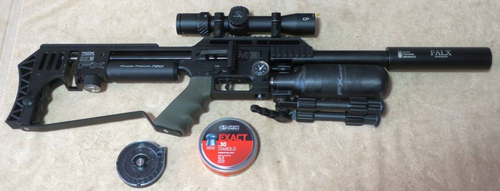

Hey, I totally get it man! That's why I couldn't resist getting a Sarissa, even though the Falx worked amazingly well for the size. The Sarissa did not disappoint for sure. This is a picture I took while doing some ammo testing, so ignore the groups, because I was using holes as the targets etc... I just stuck my phone to the scope. This was shooting around 65 fpe with .218 slugs at my house. I did shoot the target with the bird on it, and he didn't even fly away(30 yards). My target is full of rubber mulch, so it is also very quiet.
