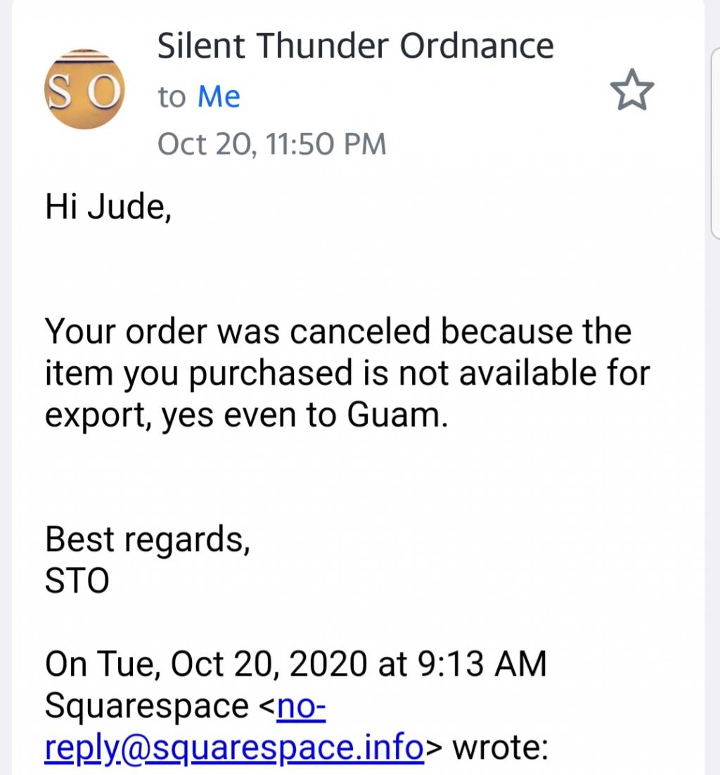

I wish that I could've had the opportunity to try one of STO's moderators but he would not ship to my location in Guam. I wanted to try out the baffle insert for the Leshiy Classic and placed my order but he canceled my order and immediately refunded my CC. That was about the only positive experience I've had with him was the quick refund without me asking. Made me feel like I'm from a 3rd world country. I've ordered several moderators from DonnyFL and Neil Clague with never a problem. I really don't like badmouthing companies but since we're on the topic and I had a negative experience, although not with the product, I figured I would say something. You guys in the mainland are lucky!

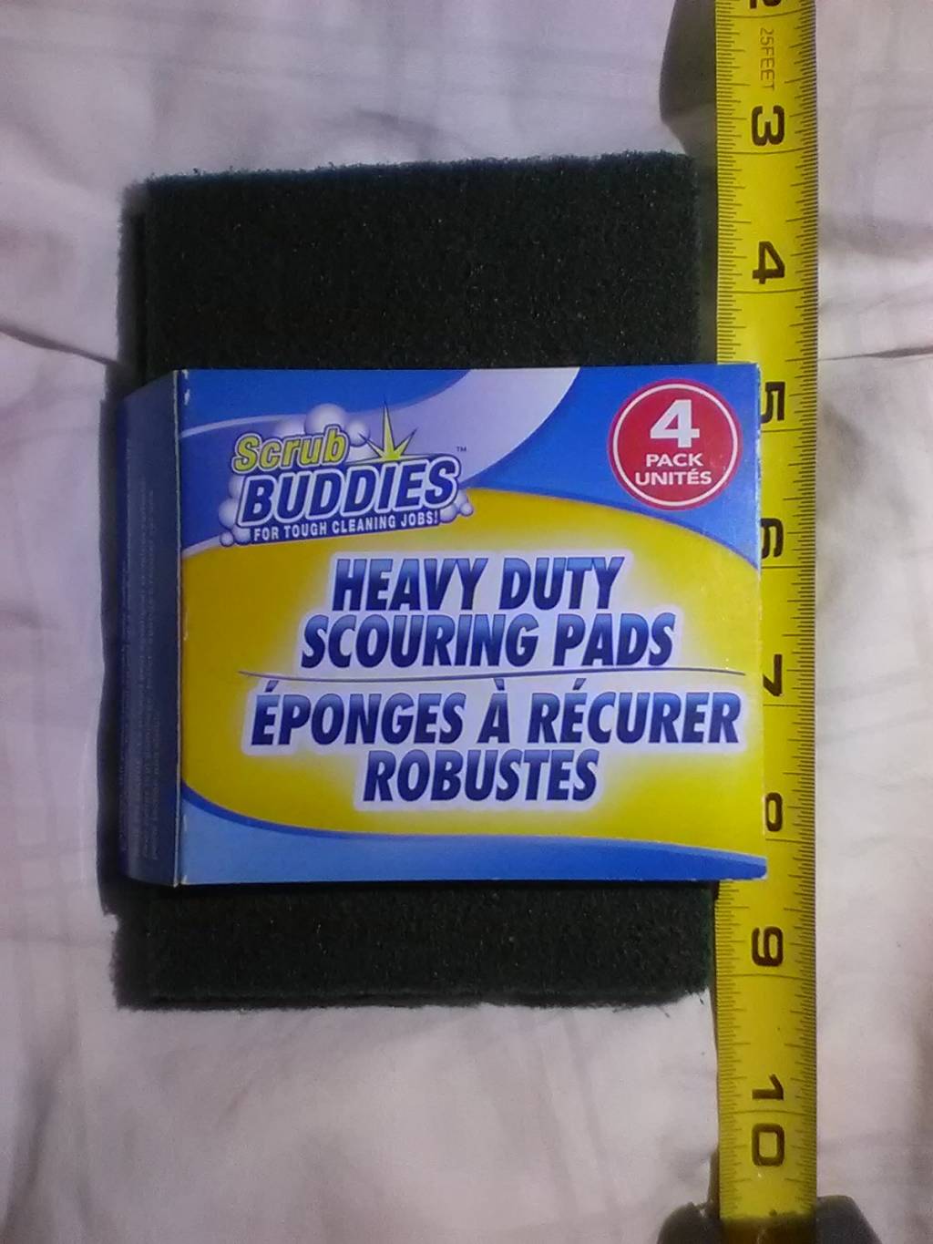

Dollar Tree is where I get most of the parts for my DIY LDCs. I haven't tried the weak springs though. It is harder to find actual pictures/design diagrams than parts lists, which I am sure makes the producers of high priced AG moderators very happy. (sigh)
Here is what I get from Dollar Tree:

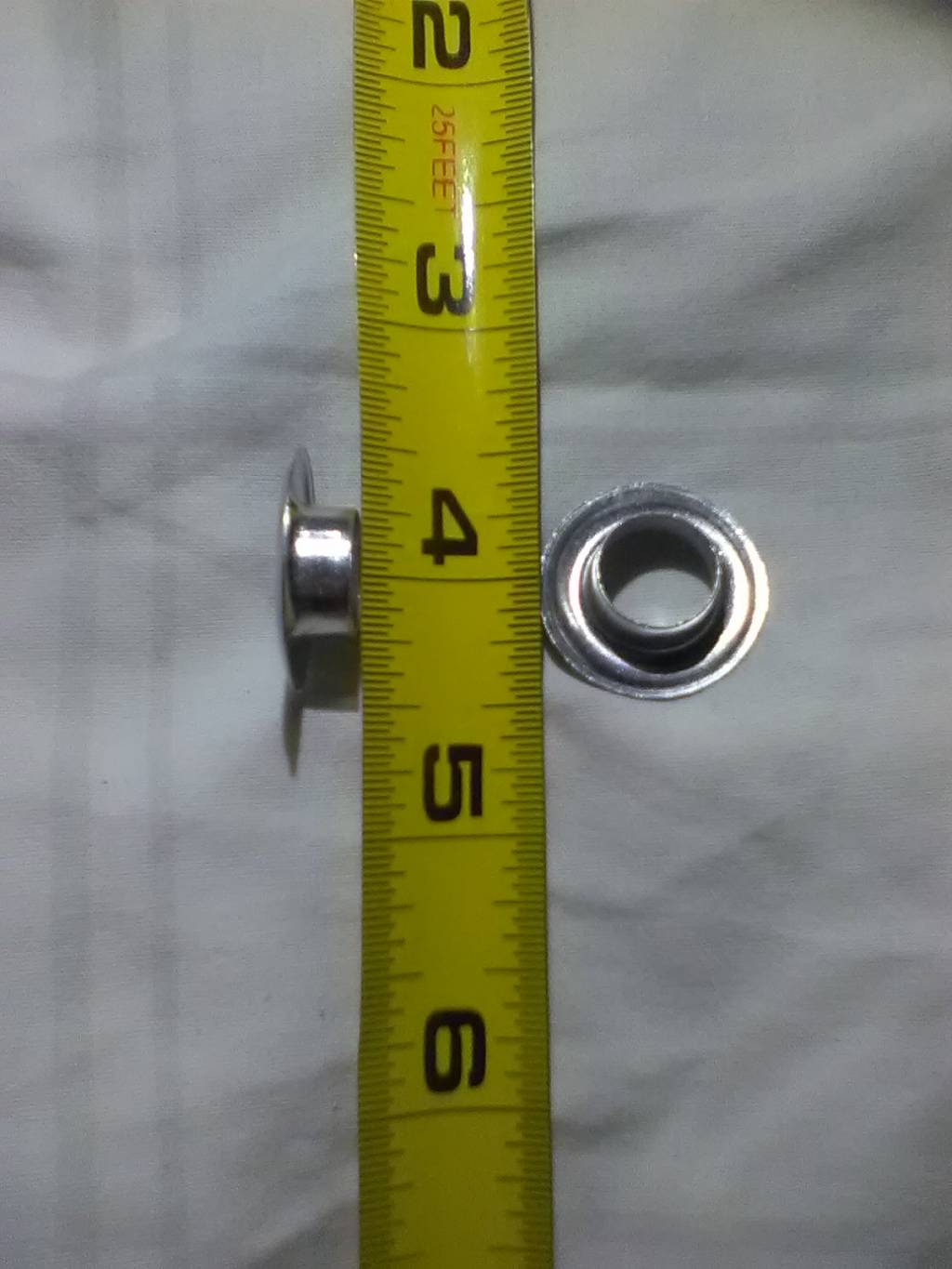

And this is what I use from Harbor Freight. Sorry no label, but it is the "male" end (cup washer) from a grommet replacement kit.
I hope that helps. I am sure similar products are available at any dollar store. The grommet kit was just something I already had. Washers, metal or other material will probably work as well or maybe even better.

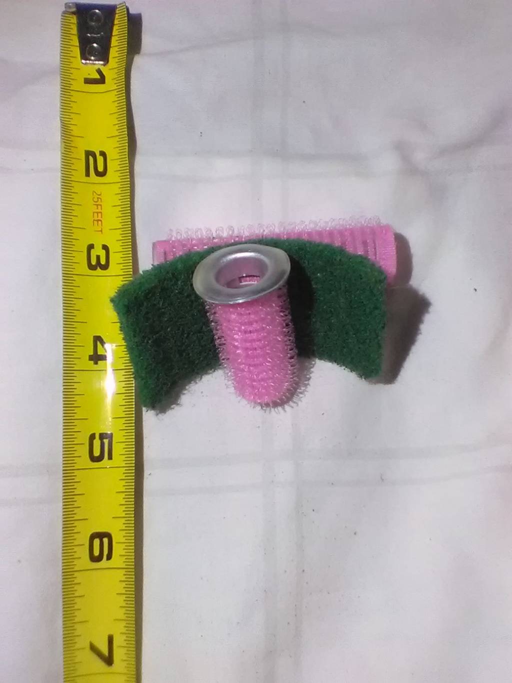

And here is an example of how the scouring pad is wrapped around the cut curler before it is placed into the 1 inch PVC pipe. One end of the curler must be snipped in 4 places to allow the grommet washer to fit into it and ensure centering. Sorry, but my phone does not take pictures well up close and my hands are not steady trying to hold the phone in one and a flashlight in the other to take these pics.
