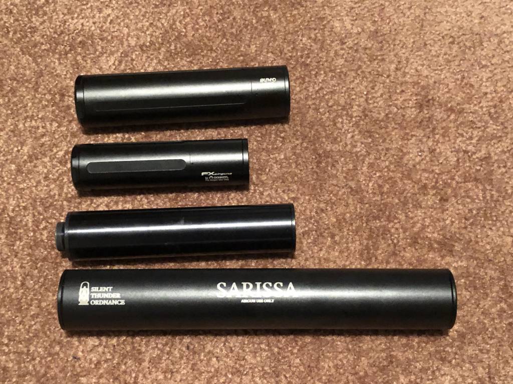

Someone here recommended a silent thunder ordnance Sarissa to tame the bark of my FX dreamline. This same user claims the Sarissa was quieter than an emperor. I don’t doubt him.
With the factory Donny FL my db meter registered 106-107db which was just a bit too loud for me to be comfortable shooting in my backyard. I tried a Donny FL sumo it too was about 107-108, just a tad louder.
My Marauder by comparison registers 85db with a Tim Hill 6” moderator.
The Sarissa quieted my dreamline down to 86DB! It’s unreal how effective it is. Yes it’s big, but smaller than an emperor.
Just wanted to give praise where praise is due.

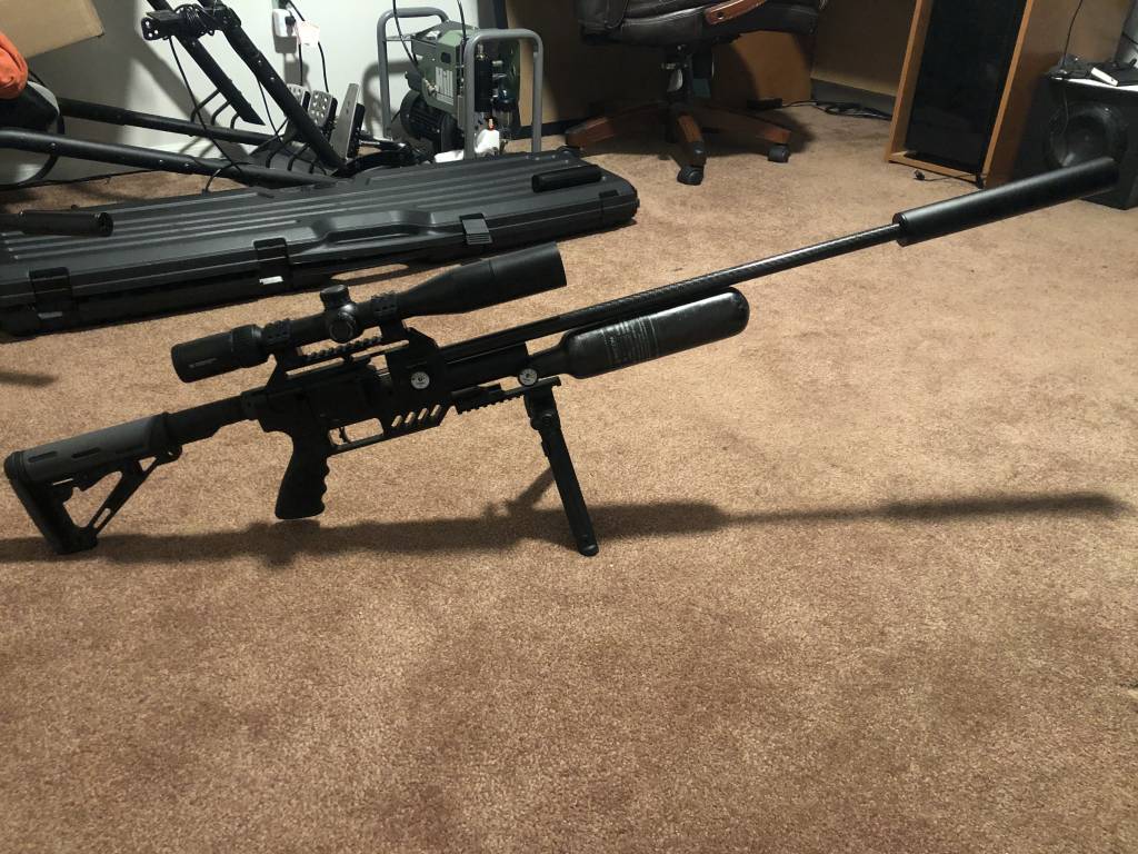

my dreamline has Ernest Rowe’s carbon fiber support on it to prevent barrel droop. Even with the big Sarissa I get virtually no poi shift.
I’d like to try the hill moderator on my dreamline. It’s by far the quietest between the 2 Donny FL’s. Just need to get an adapter

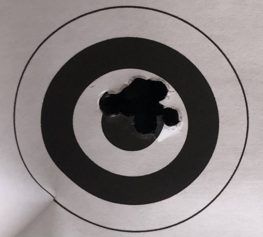

Here is a group of a full magazine of NSA 29.0’s at 65 yards. My gun will do this all day, the group isn’t Cherry picked
