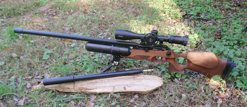

I shot a couple groups with the 4 inch moderator today and I am happy to report it does not affect the accuracy of my 25 caliber Avenger. POI might be slightly, like 1 click, lower and to the right, maybe. I need to shoot back to back groups to be sure. But pretty much unaffected. I will include a picture of the two groups, and also a couple of these moderators.
I will disassemble the sprinkler, the body can still be used with different internals as a sprinkler, and throw the 7 inch away. But I will paint the 4 inch black and use it some in the backyard to minimize disturbance to my neighbors.
